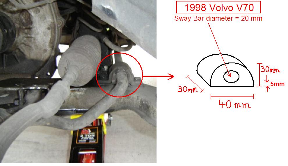

I just jacked up the car for inspection. My FRONT sway bar bushing is cracked after 12 years 106K, but no significant gap between the bushing and the bracket yet.
I measured the dimensions in case anyone needs to buy the generic bushings (I have not replaced my bushings yet).
My car is 1998 V70:
- Sway Bar 20mm
- Bushing is 40 mm x 30 mm x 30 mm, with 5 mm at the bottom. See pic:
My car is 1998 V70:
- Sway Bar 20mm

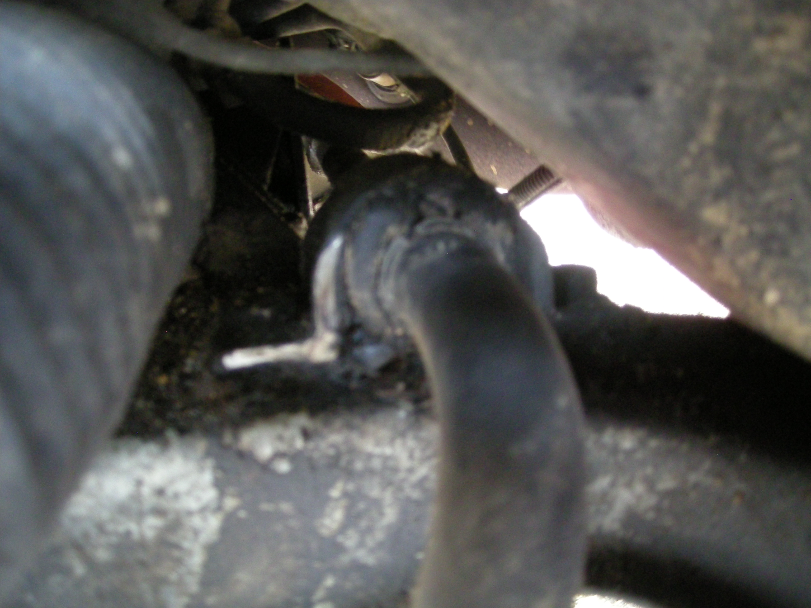

I had to punt on replacing these on Saturday. When we got the bar off we found that the band that holds the bar is actually two pieces and they are press fitted together. When deciding how much work it was going to take to get them off we decided that Saturday was not the day to do it. I will probably now wait until I can afford the IPD sway bars.
