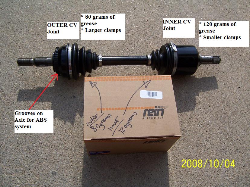

6. To replace the Rubber Boot, it is MUCH EASIER to remove the INNER CV Joint than the OUTER Joint. It took me one hour playing with the OUTER Joint Circlip and tapping it to no avail!!! However, the INNER Joint is much easier:
- Using liquid paper, mark the locations on the axle so when re-installing, they align to the same spot.
- Remove the INNER Joint (see write-up by Mr. Winkey)
- Clamp the CV Shaft on a Vice:
- Remove the INNER Joint's circlip (Figure 02):
- Using a drift, tap the INNER joint as shown, it will come out in 1 minute! (Figure 02)
- Once the Inner Joint comes out, Install the OUTER Boot first (apply grease on the small lip of the boot before installing, it makes it much easier to slide the rubber boot in, also grease prevents damage to rubber during installation!); then install the INNER Boot, also using grease.
7. INNER CV Joint:
* 120 grams of grease (Per Haynes Manual); but I used 160 grams.
* Larger clamps
8. OUTER CV Joint:
* 80 grams of grease (Per Haynes Manual); but I used 110 grams.
* Smaller clamps
