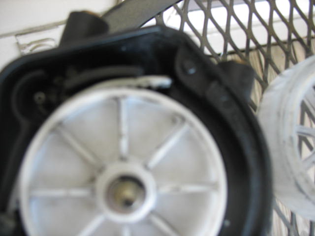

Success! Okay so I finally figured it out. Thanks everybody for your help. It seems that the nylon part wasn't able to wrap around the track like it was supposed to. I took the motor apart and took a picture of what I think it was doing. I don't know if the part I got wasn't bent correctly or what. So I bent the very end of the nylon inward and that seems to have done it. Once I put the motor back in the trunk and fed the mast back through it caught and kept pulling it in until it stopped perfectly after it had descended. Thanks again everyone.
