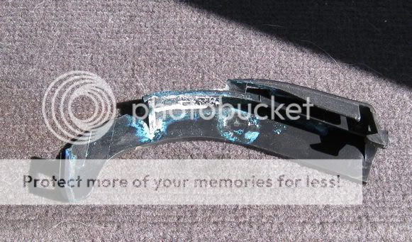

I have made a discovery in preparing to replace the hose I mentioned.
Upon removing the black plastic cover that protects the hose as it runs along the right hand side hinge, I discovered an additional relief valve, or anti-syphon valve, or whatever these things are.
I wager this is the problem, and will replace both of these valves.

Thanks meine39 - everything looks good as far as the hoses connecting into the filter.
I am certain that the 2nd valve is the culprit. There are forensic signs of washer spray collected all around the valve.
I'll replace both of these valves. The VADIS doc showed the standard relief/syphon valve (near the nozzle). Nothing prepared me to look under the black cover for a second valve.

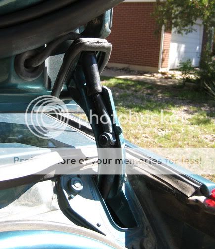

Since a picture is worth a thousand words...
1 Having removed the moulding for the liftgate, here is the valve I was expecting after studying the VADIS PDF posted by MadeInJapan in "Volvo 850 Wagon Rear Window Washer":

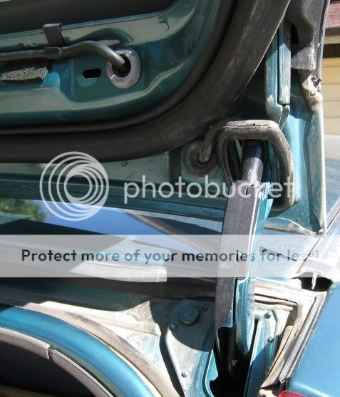

2 The hose feeds along the right side hinge:
3 The black plastic cover snaps off easily to reveal a surprise...:
4 The Fluid stains tell the tale:
