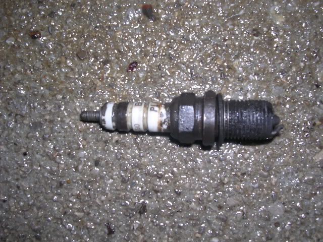

The old plug is a Bosch Platinum, and after poking around a little, I found the plugs are a 14mm thread. My local Autozone sells a repair kit for M14-1.25 spark plugs for approx. $30.
The old plug that came out looks pretty sooty, no clean shiny threads at all, so I think it has had some exhaust blowing past it for longer than the few minutes it took to get home. Yet, the engine ran smoothly, no hesitation, no missing... until it blew. So apparantly the engine can run normally even with a spark plug about to blow out of the head - go figure.

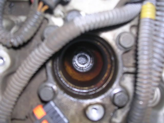

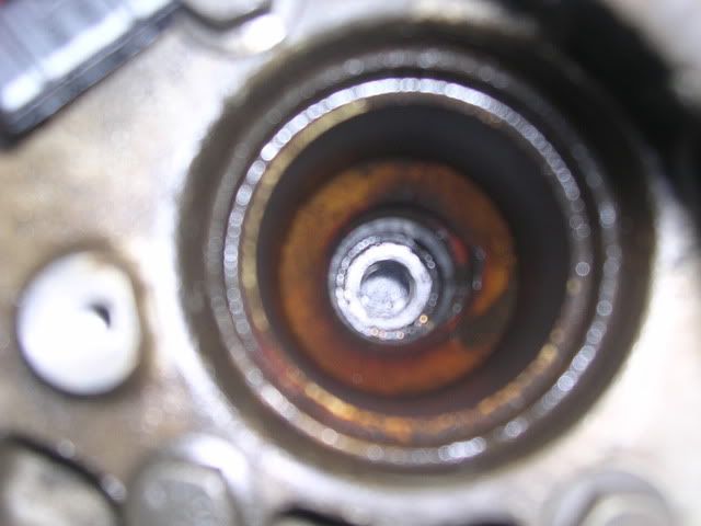

Here are a couple of pics, sorry that the one looking into the spark plug well is a bit blurry.
The plug is in better shape that I thought, it appears that the debris left behind in the spark plug well was mosly plastic from the melted/broken coil pack and insulator. The plug and the coil pack spring spring came out largely intact. I need to pull one of the other plugs to see if it has 2 electrodes on it, in which case one may have broken off this one.

Need a clearer pic of the piston top but it looks like you had some serious detonation going on. What do the fuel trims look like?

I'm worried about why you blew that out... But fords do it for no reason some times give the heli coil a try
