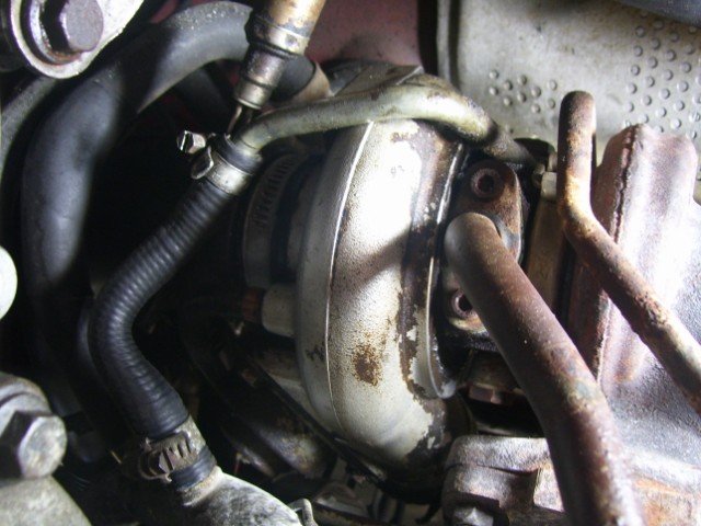

I just replaced the upper and lower coolant lines to the turbocharger. The lower one was dripping some, causing coolant level to drop over time. The drops were often thrown onto the exhaust, and never did make a puddle on the ground. Here's a pic of the lower line, that was a leaker on my car. It's the smaller black hose in the left side of the picture:

hi renns, in that case wouldn't you see signs of coolant around the leaking hose and on the exhaust and or manifold too?

That hose leaks on nearly all turbo models I have been...fortunate...enough to be under.
Why they couldn't have just run a metal line into the stupid turbo like they did for the oil, I have no idea, but it's a real pain to change.
Replacing all coolant hoses on these cars as they're getting this old is a MUST! Those let go and your engine overheats, it's warped head time
Do it now, and don't worry about it for another 7+ years!
