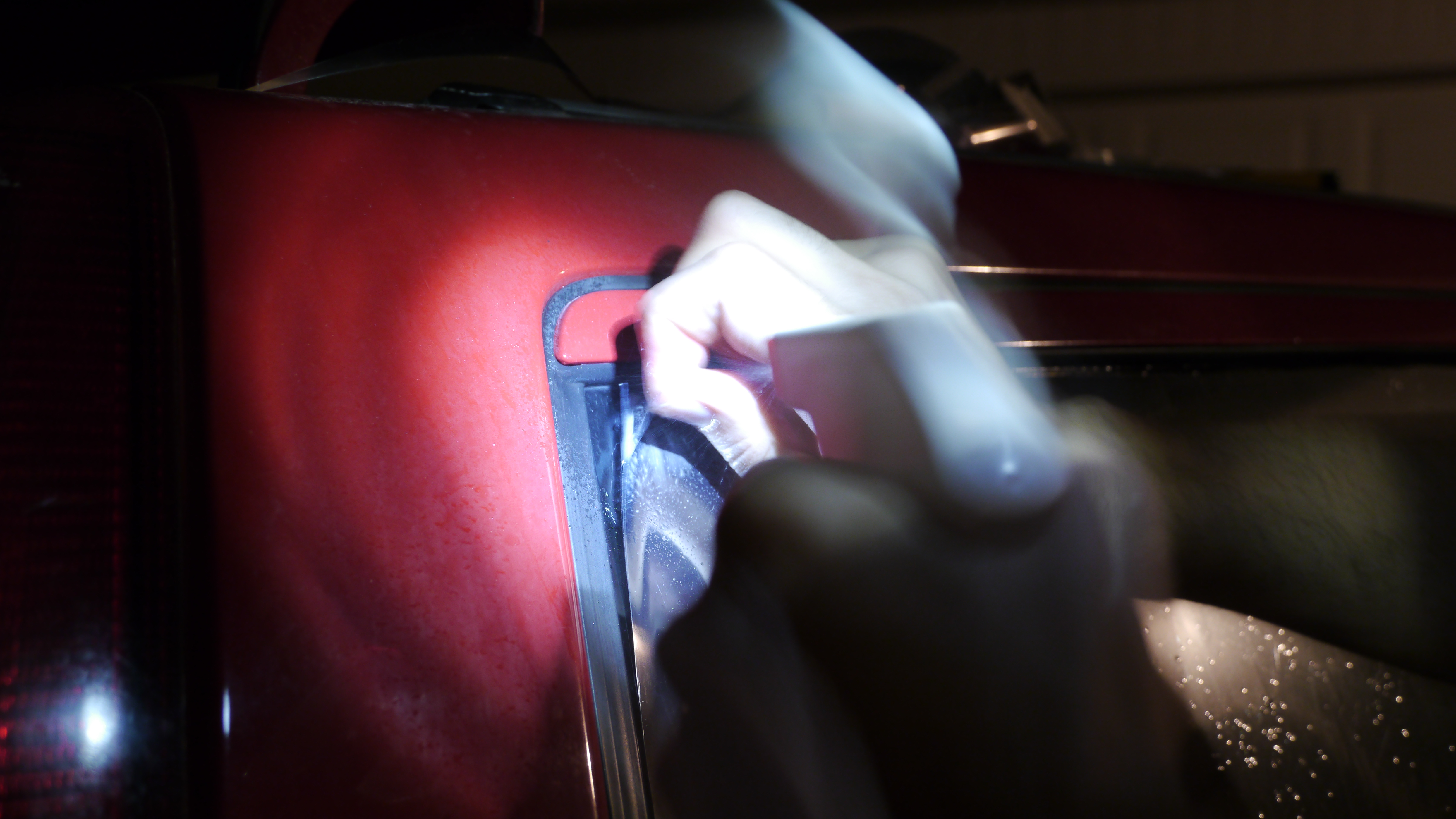

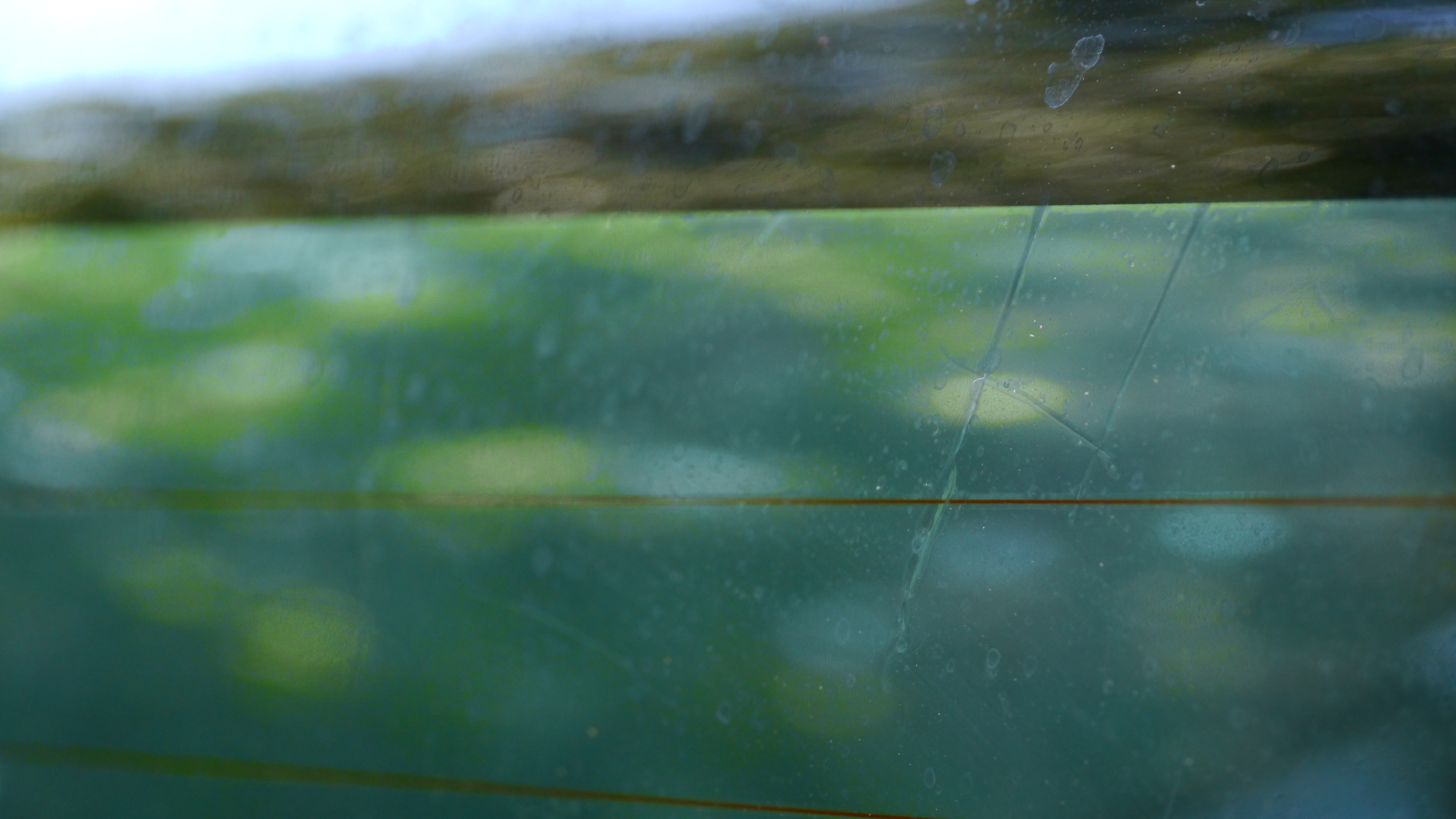

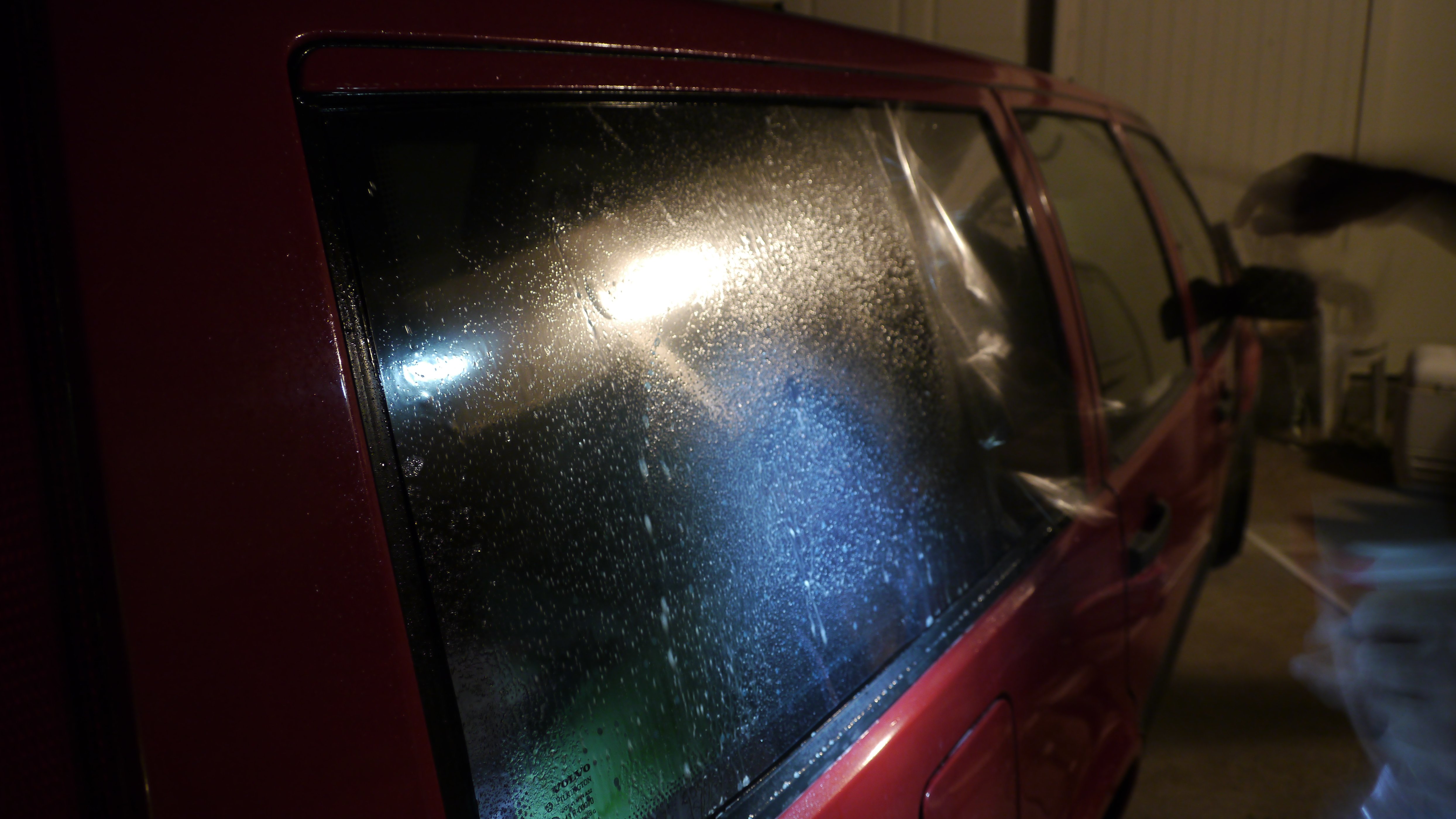

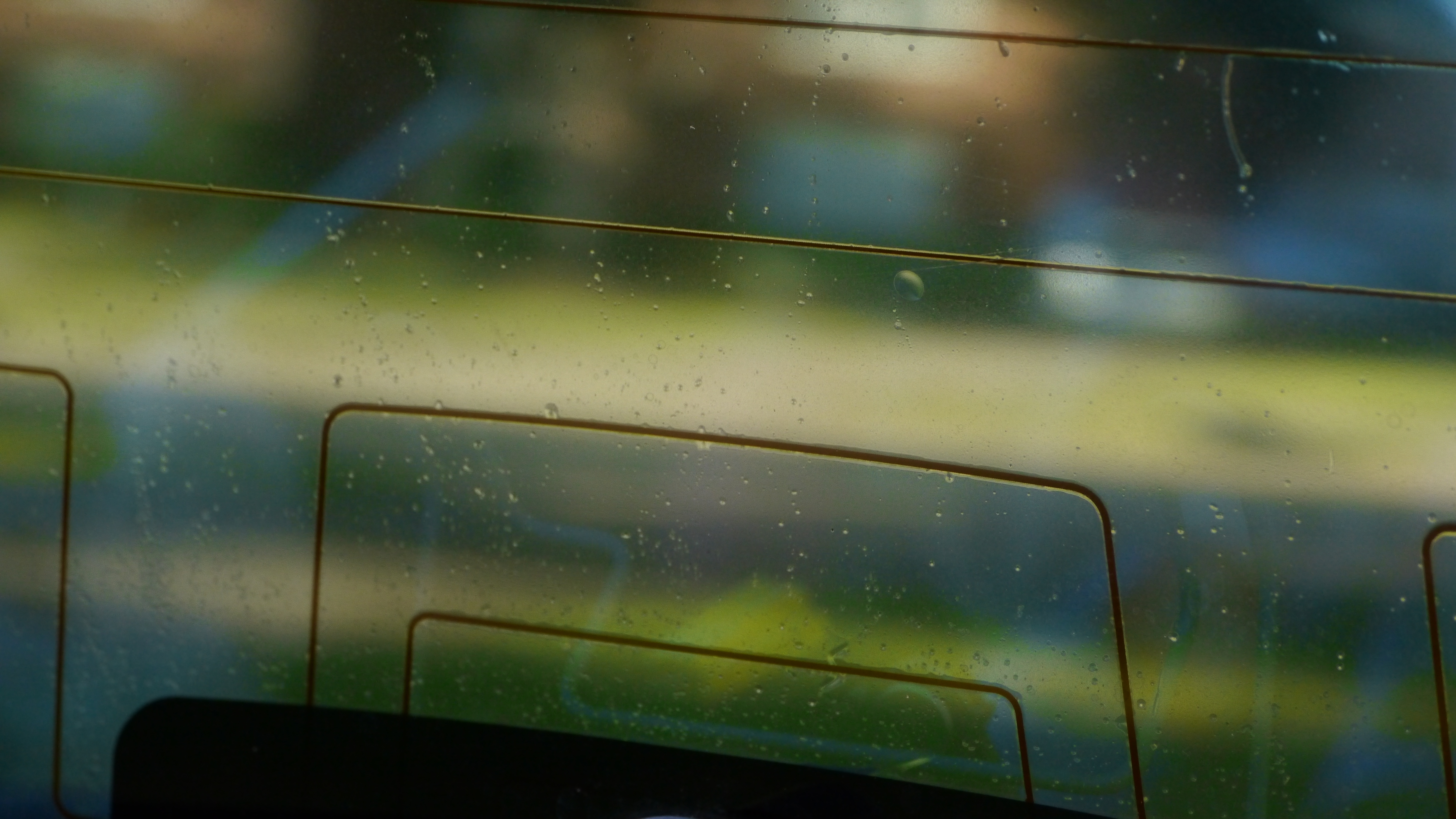

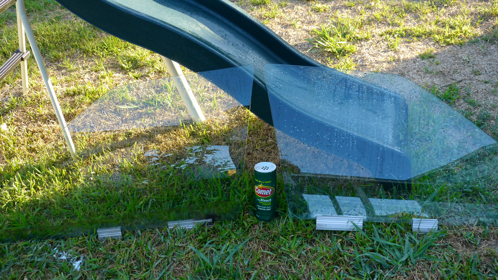

I had old tints on my glass which I painstakingly peeled off. That took two days. After that I had to knife and use a brake cleaner to make sure nothing remained. Everything was clean and ready to have a tint cut out. We start with this. I removed the trim in hopes of making the tint perfect. Waste of time but oh well.
( A cheap steam cleaner would have helped removed the old tint in a few minutes)

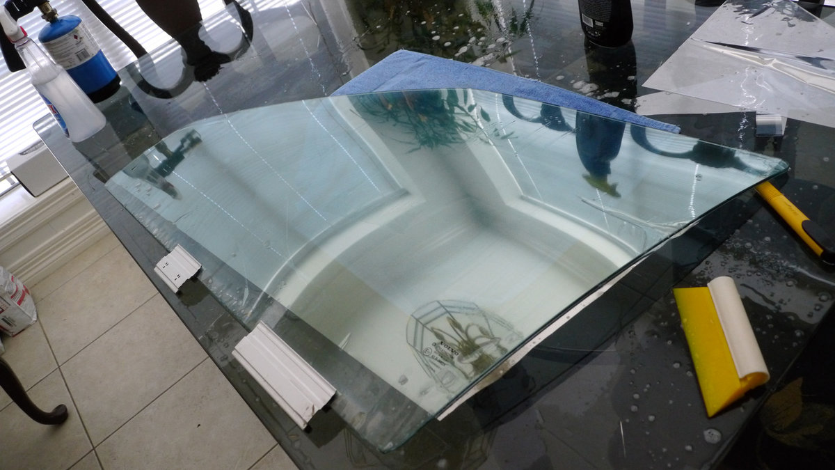

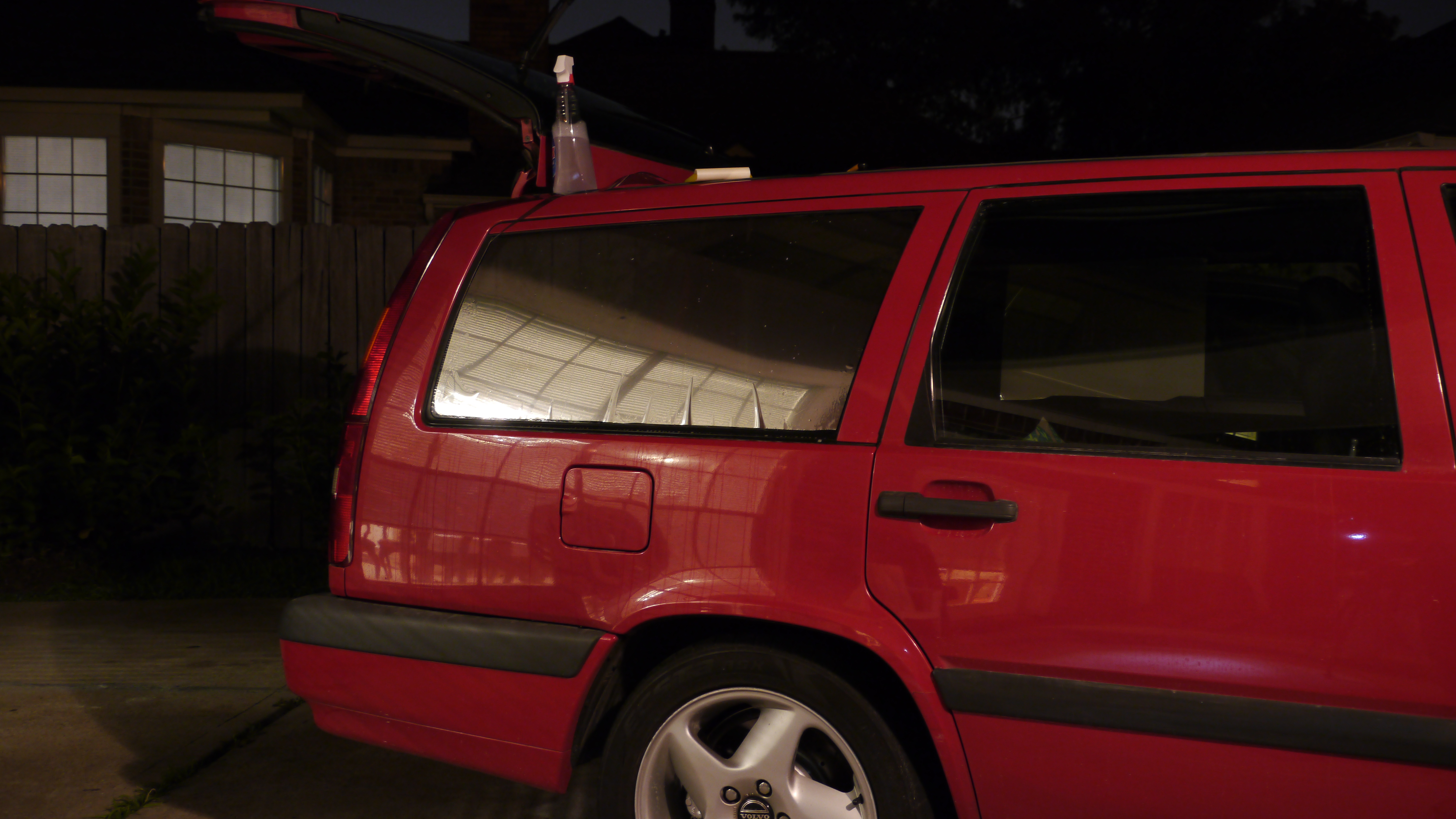

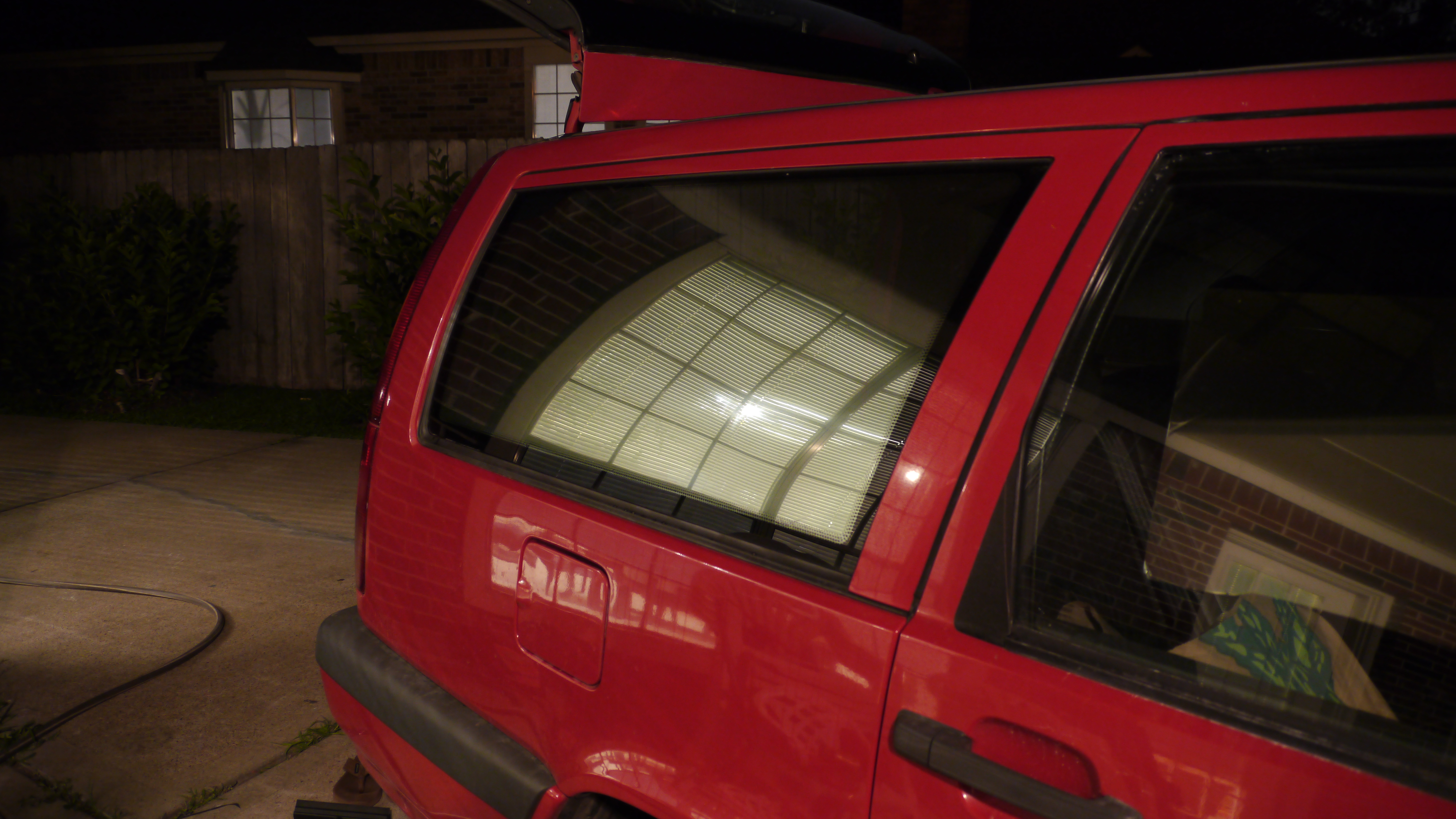

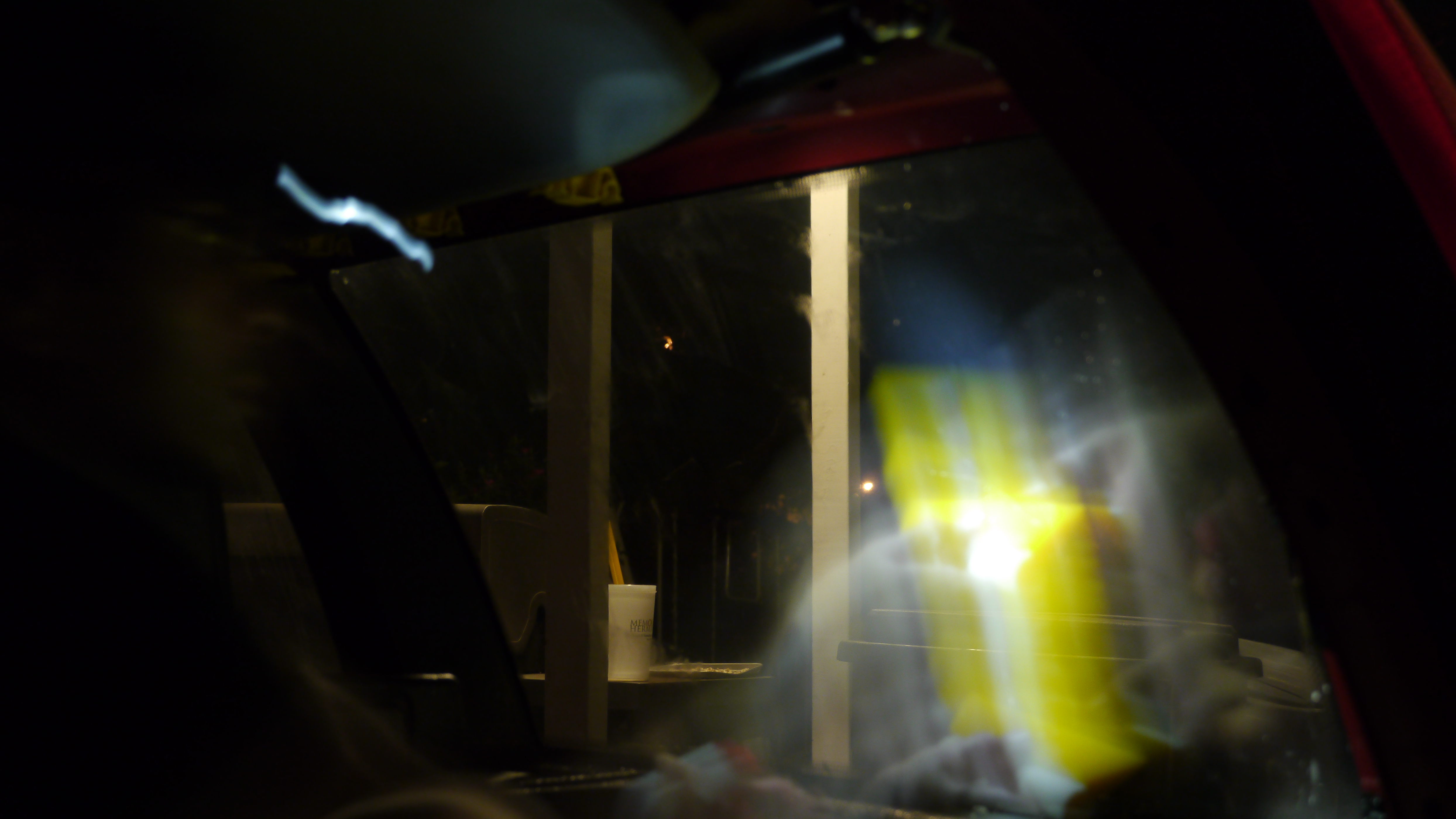

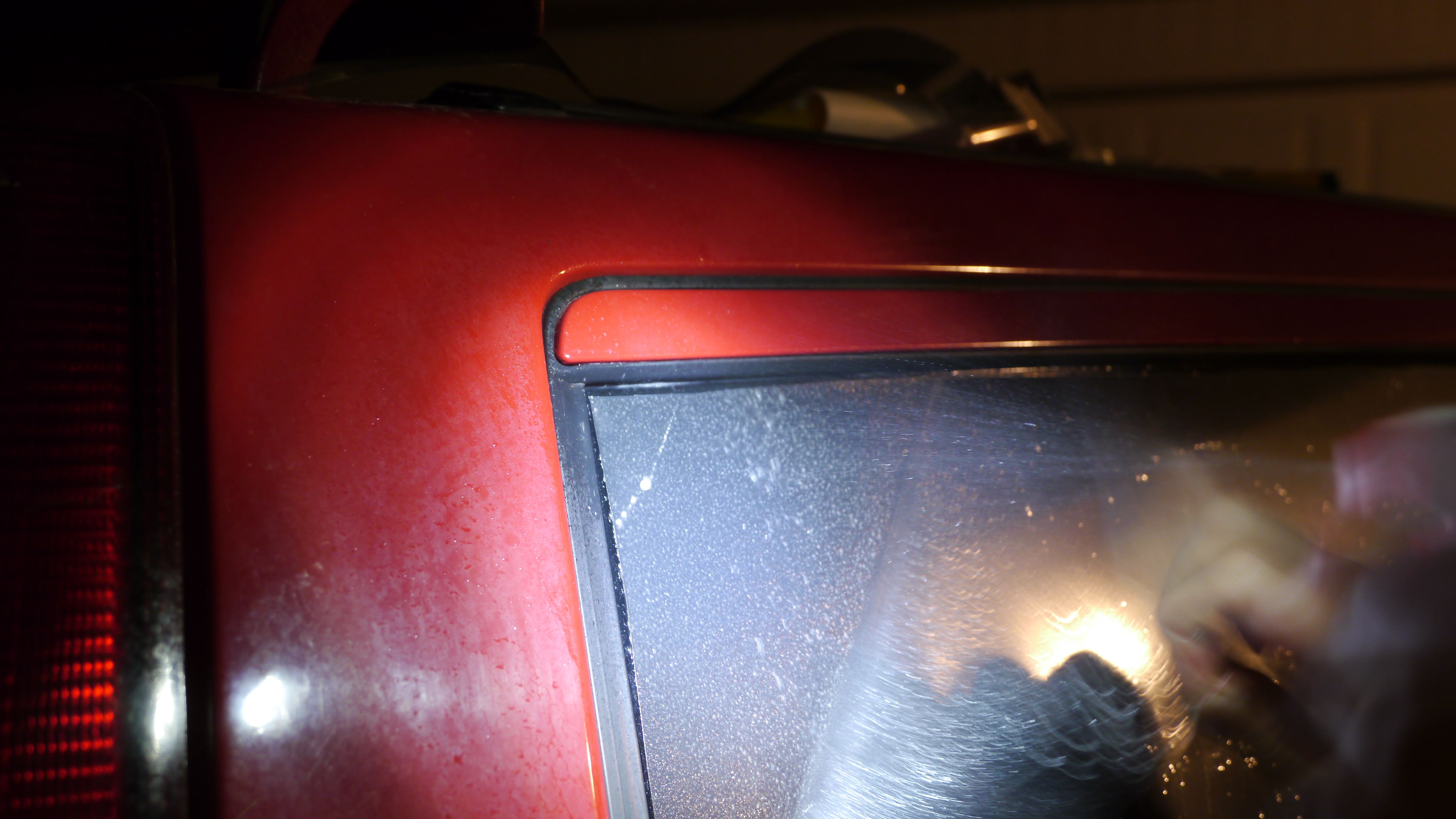

It got dark quickly so I just did the rear panel. First you cut out the film on the outside. Just go around the trim or solid black lines.

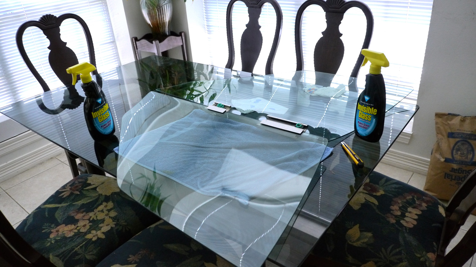

The peeling side or glue side must face out towards you. If you do this wrong throw it away. Start again.
I got a whole pile of creases which we all get. Don't panic and continue on.

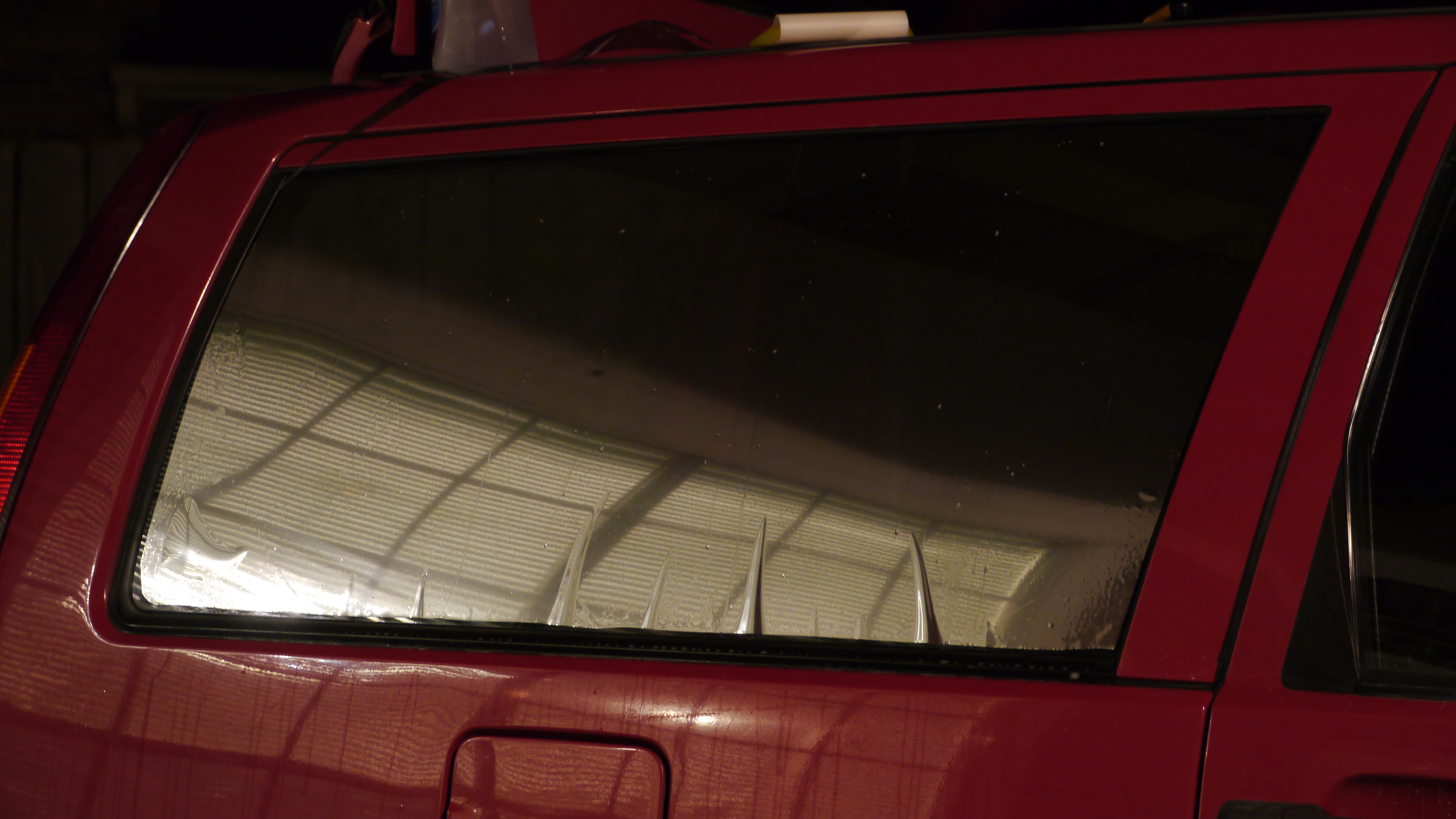

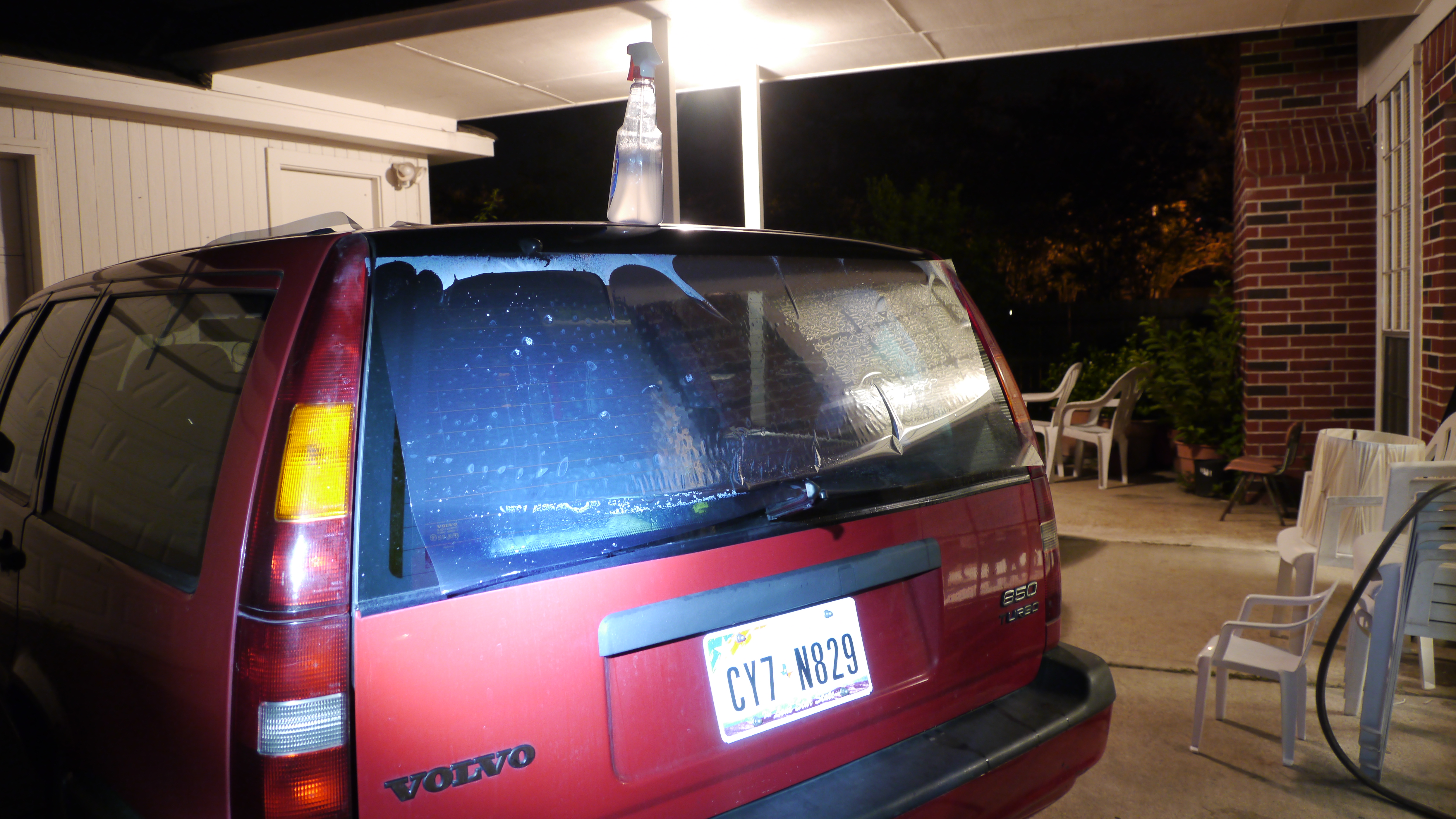

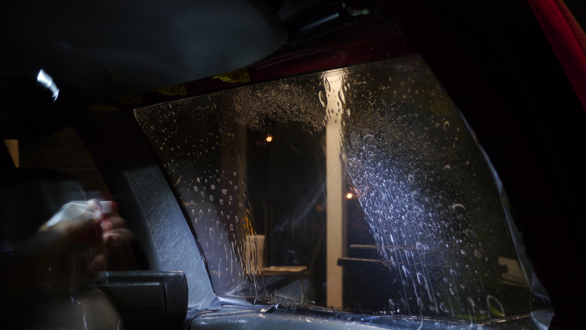

Now find the edge and peel the clear film sheet back and spray with baby shampoo water. Ration 50 to 1.
continue to spray soapy water on film.

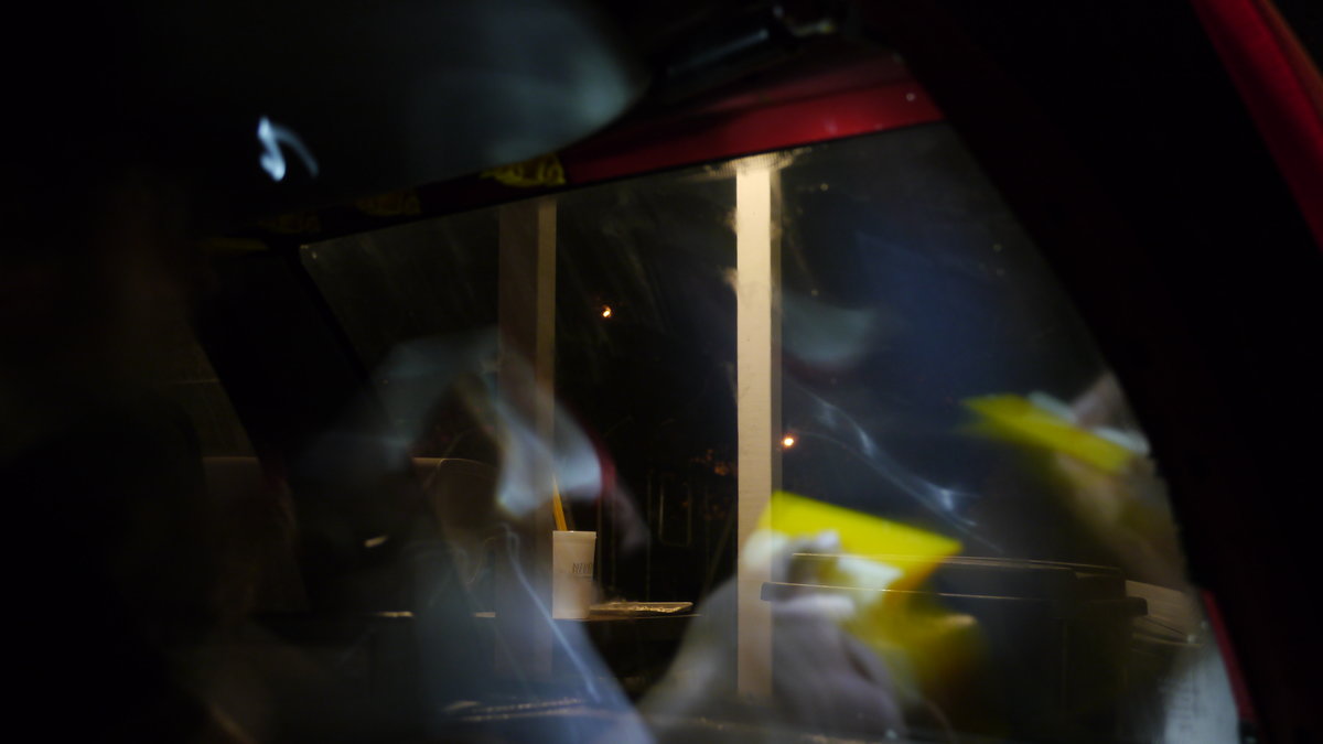

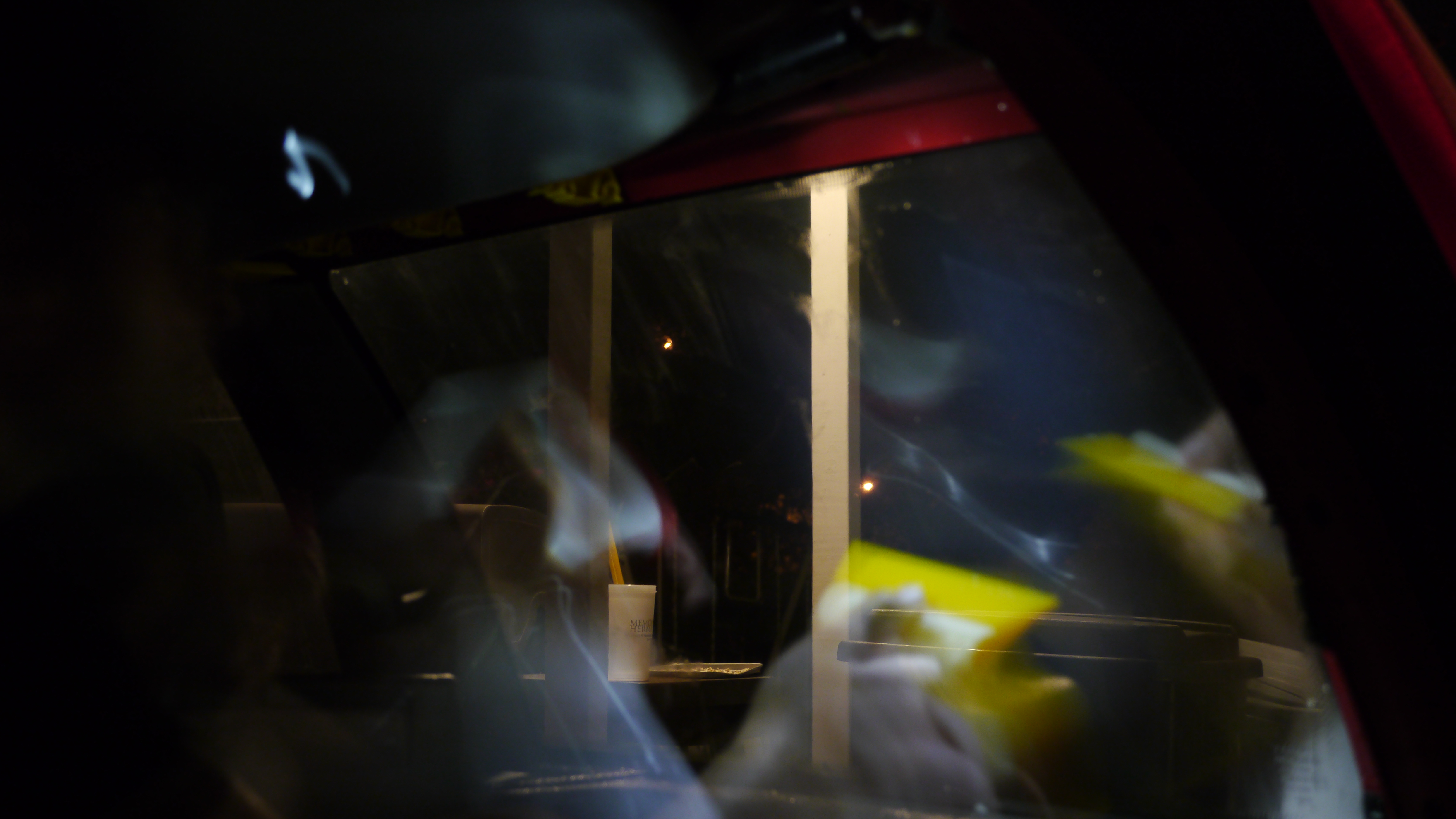

Now spray the inside window and squeegee to make sure its clean. then spray again and push film tint into place and soft squeegee the water out at first.
once your happy with no large bubbles and no dirt behind the film. spray water on the rear of the film and push all the water out hard to the edges! use the soapy water to stop the squeegee from catching the film and marking it up.

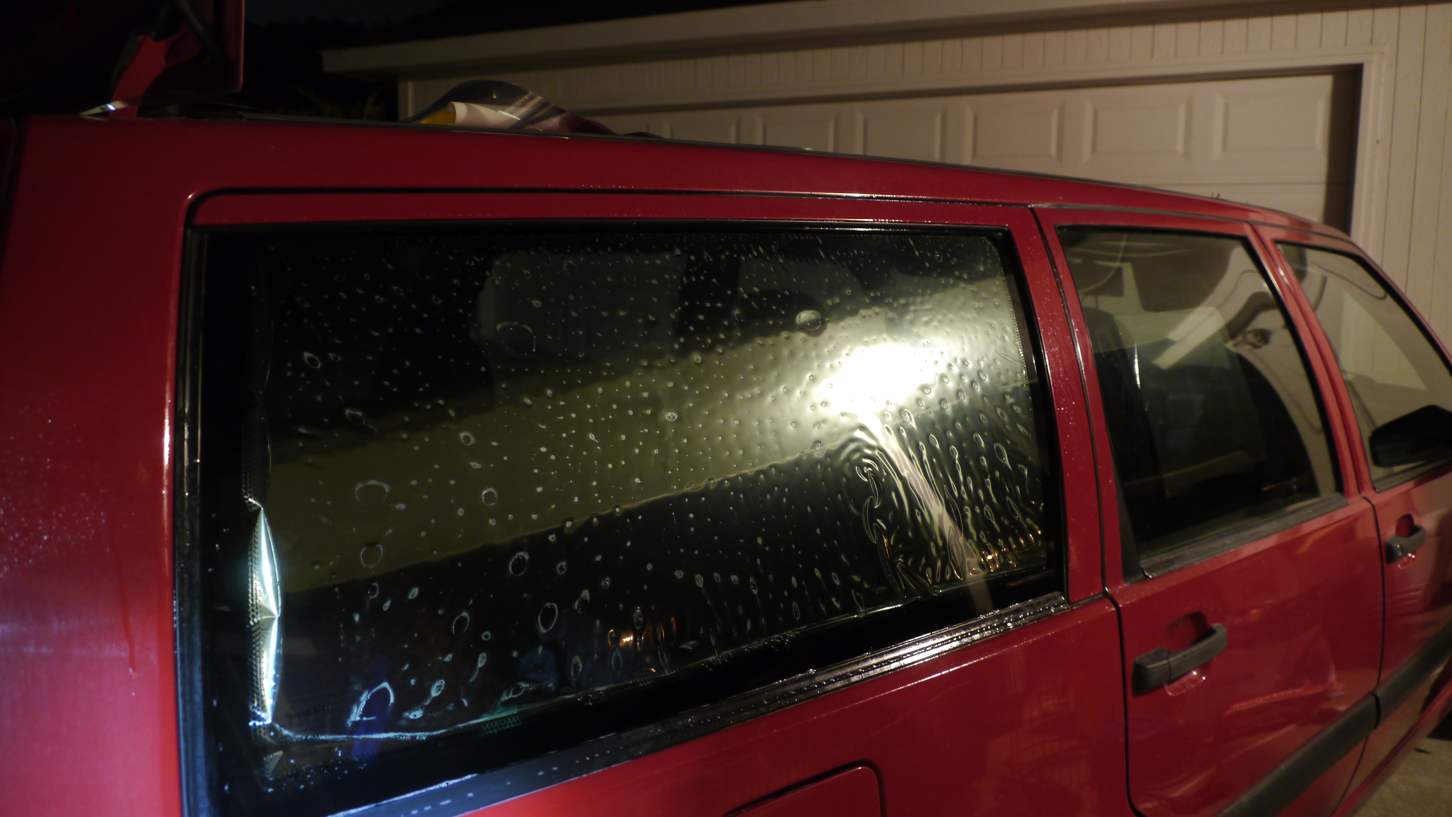

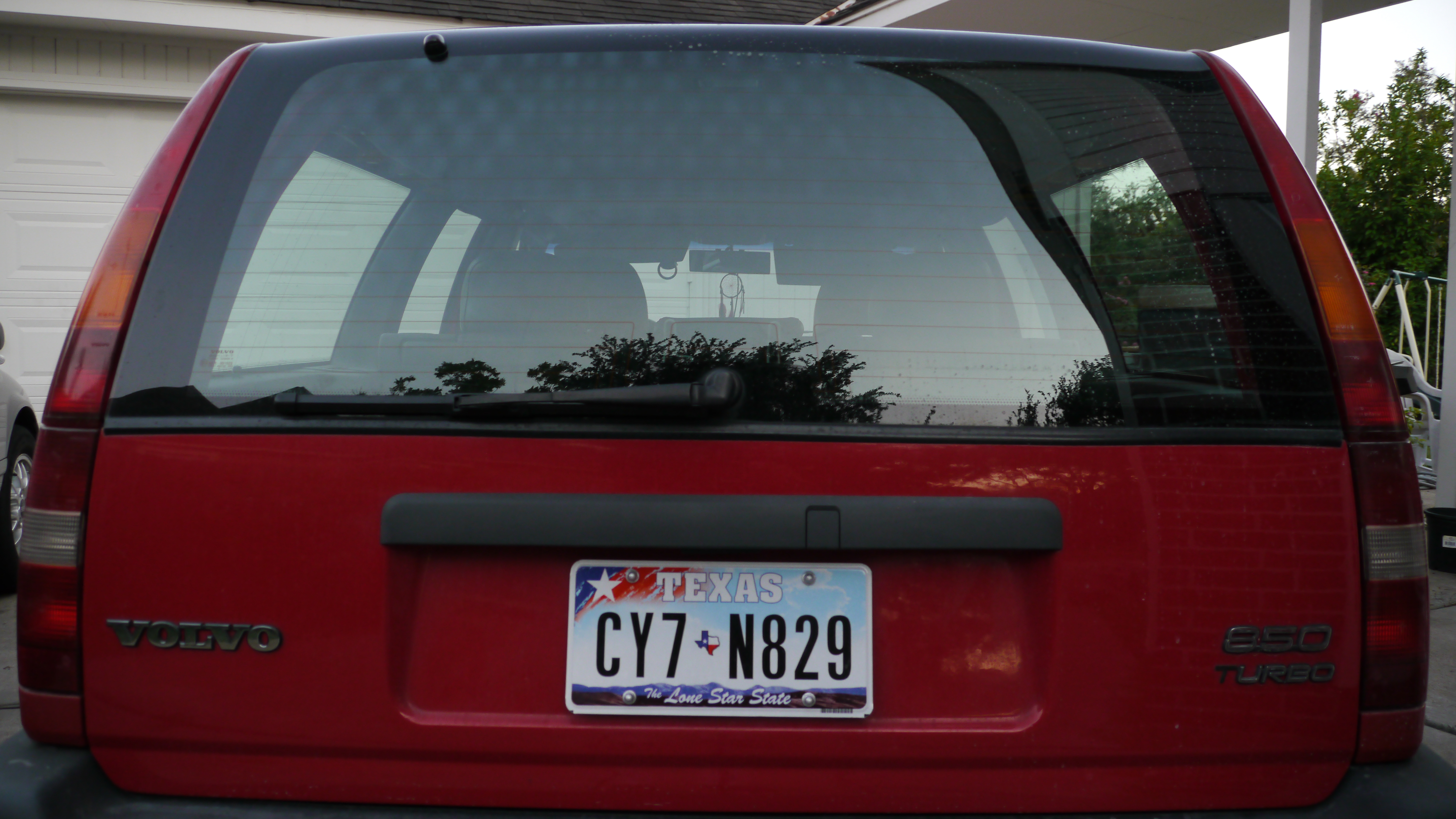

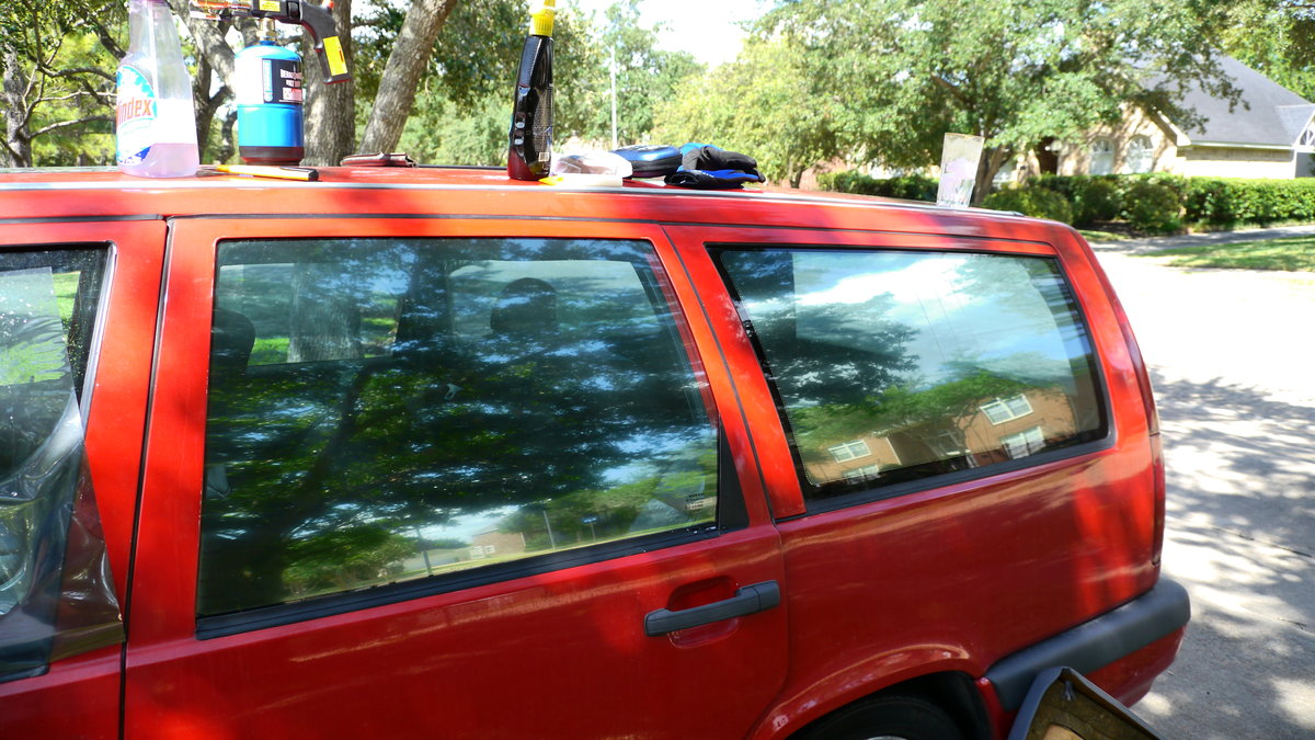

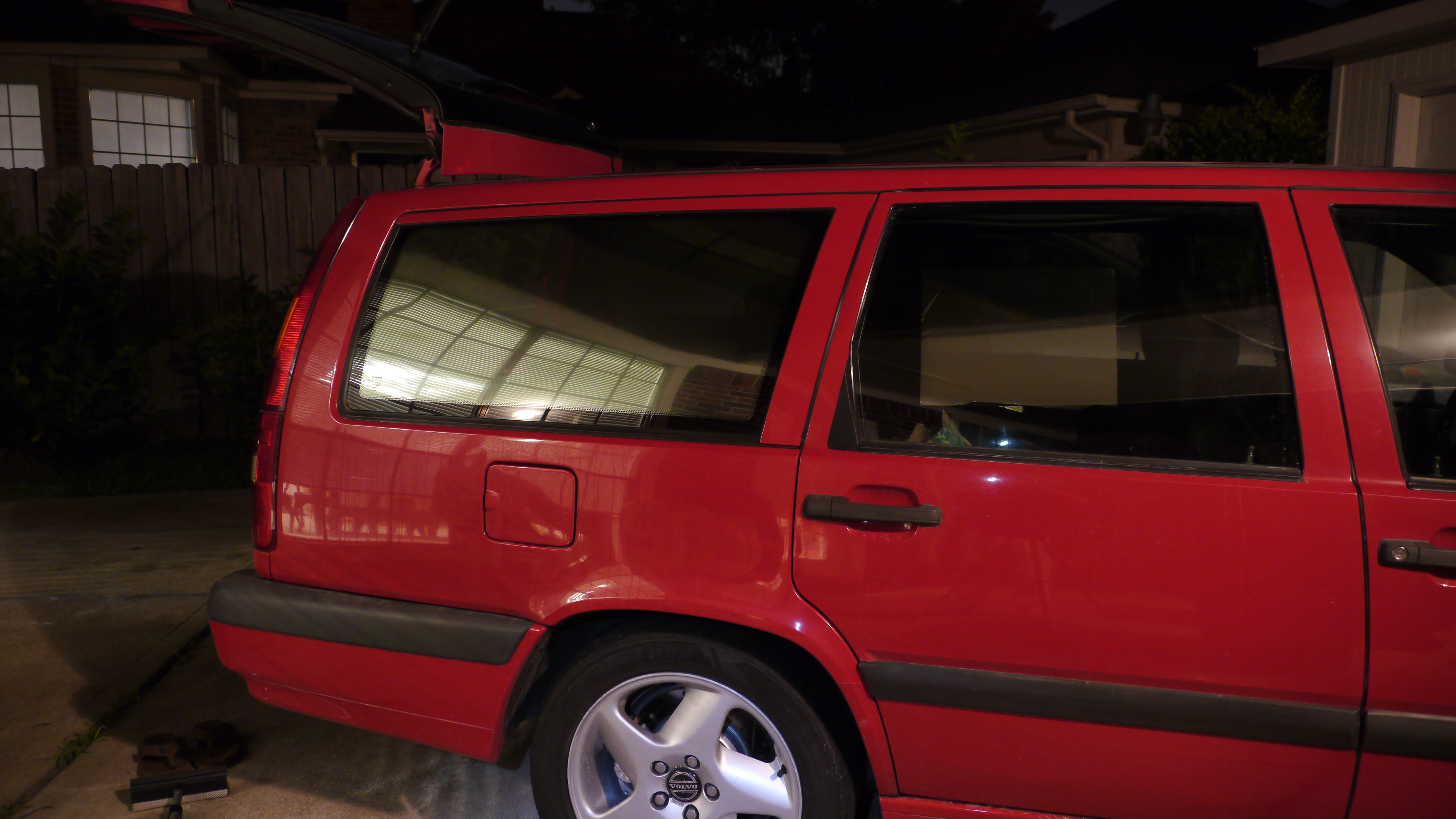

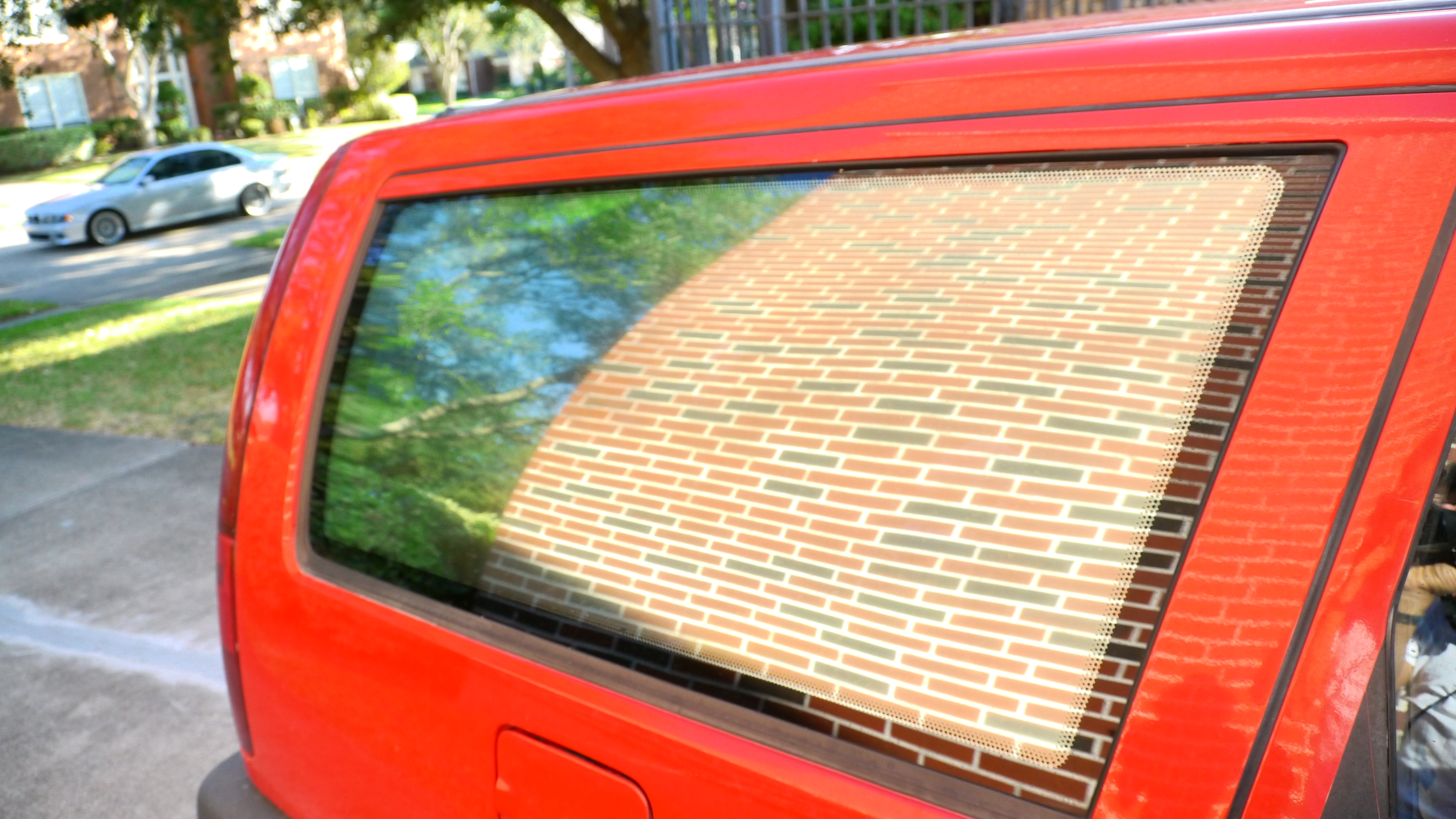

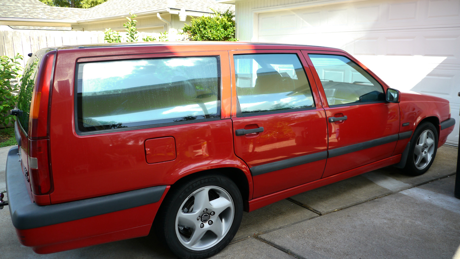

You should end up with this.
Not a great shot with only a tungsten bulb for light.

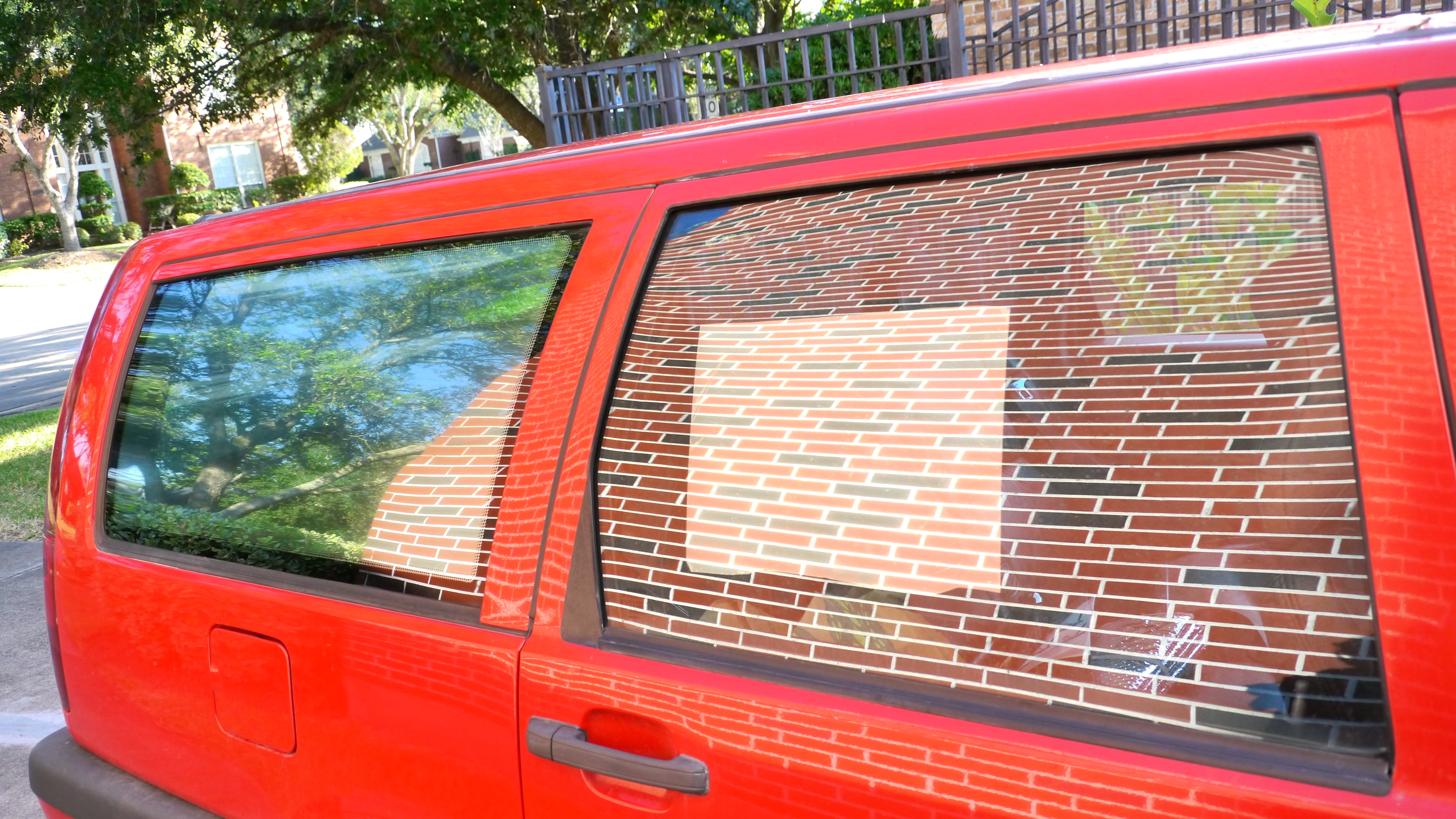

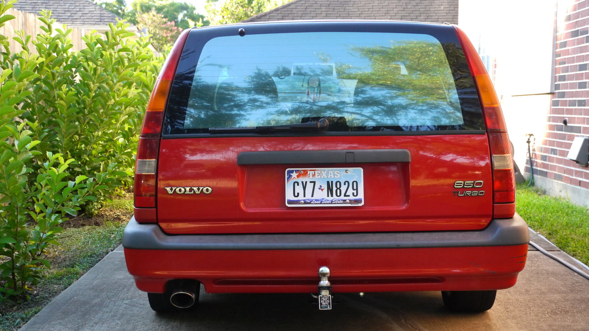

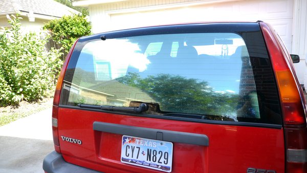

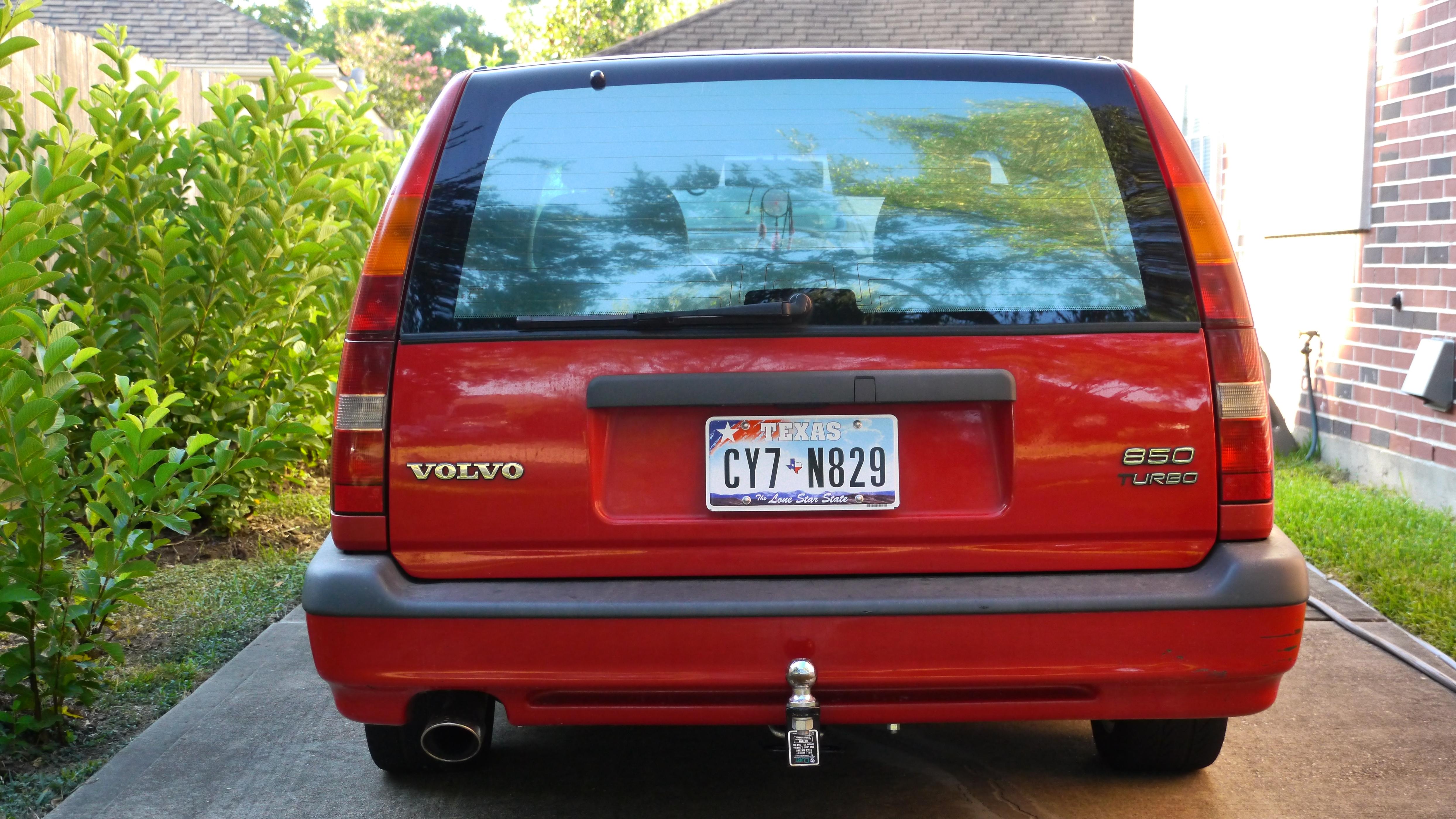

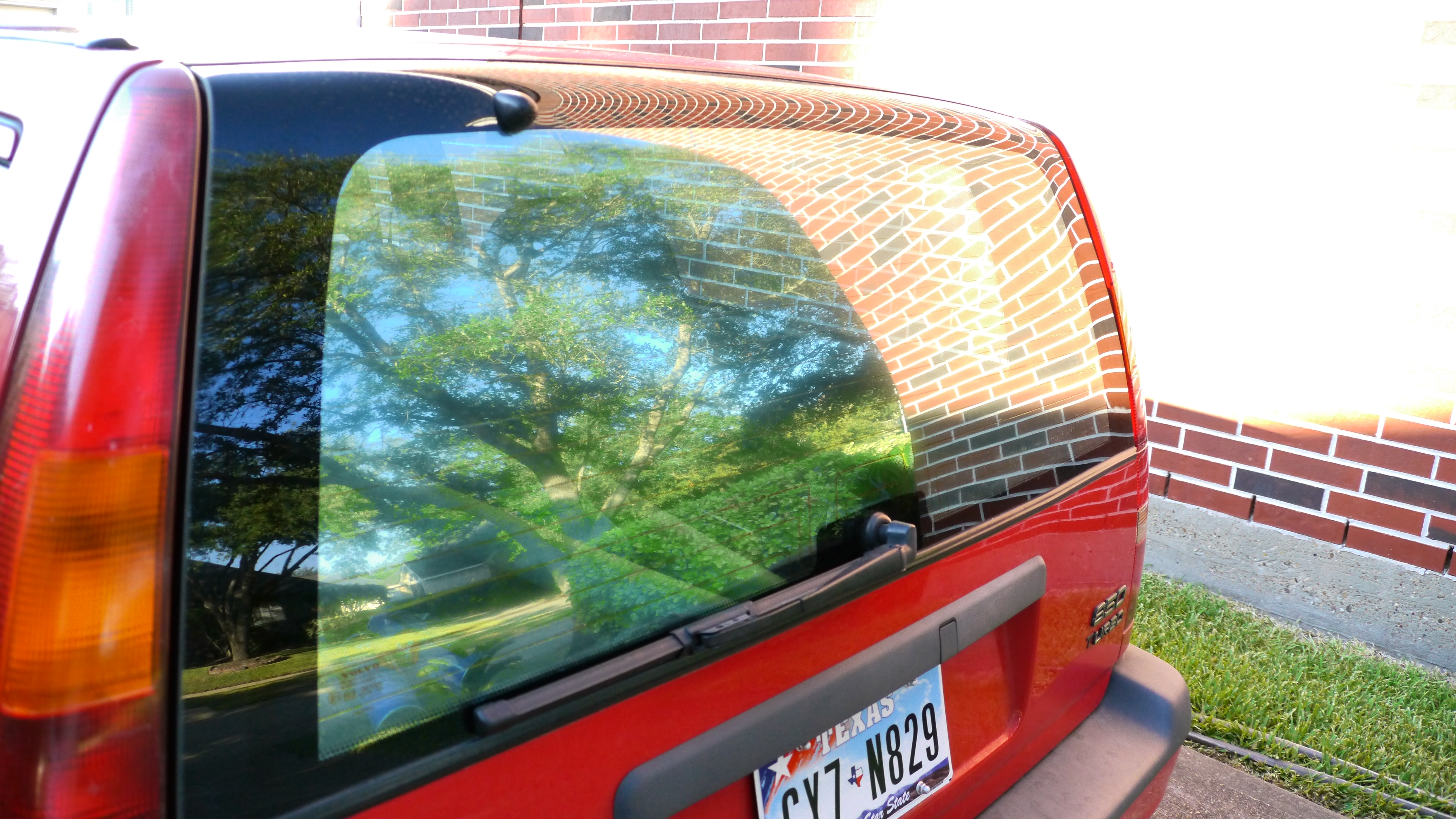

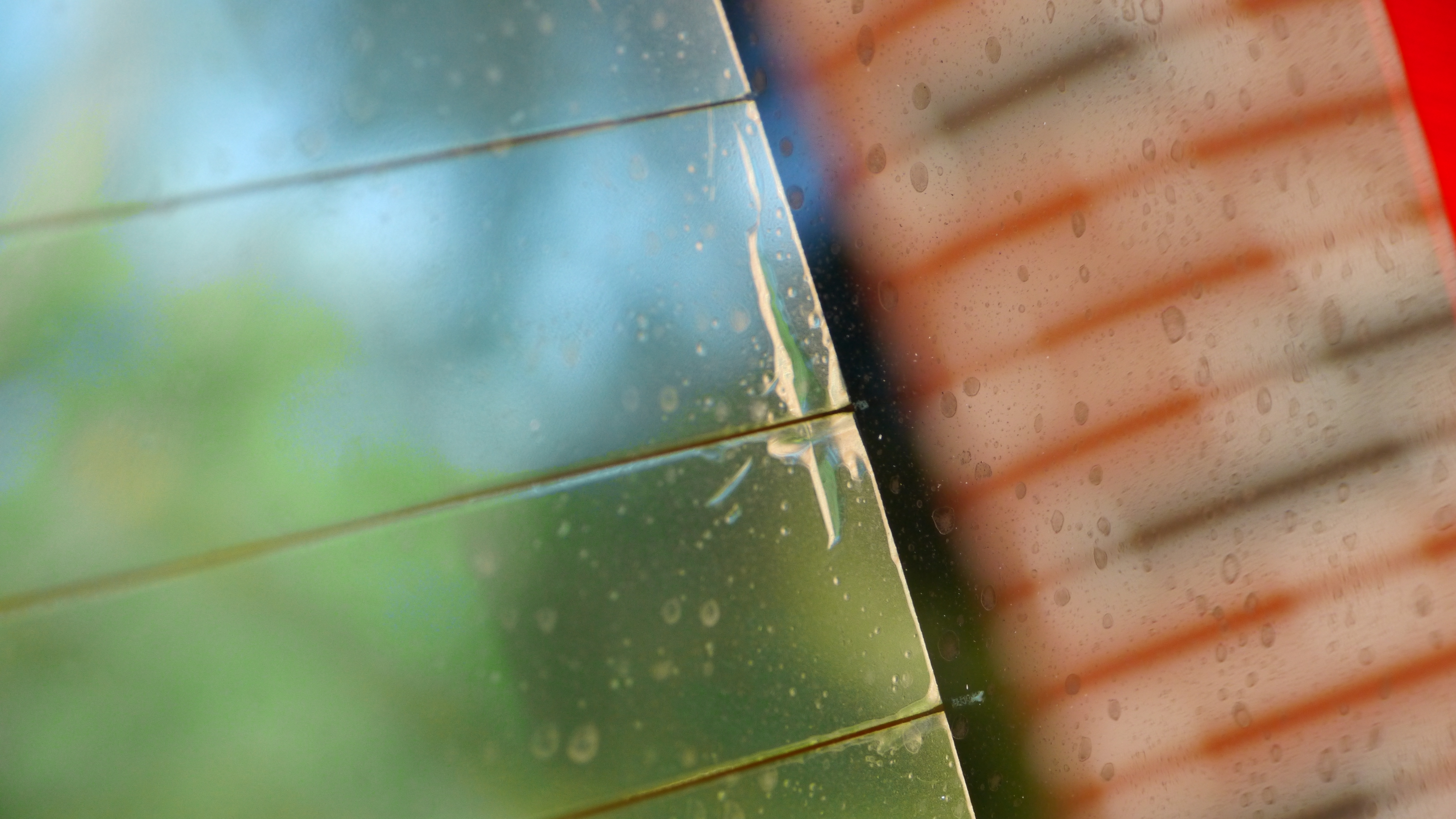

I also did the rear window but I kind of ruined it a little as you will see. Patience was sorely lacking on my end.
It looks ok in the daylight but under closer inspection I made a few mistakes on the edges and corners.

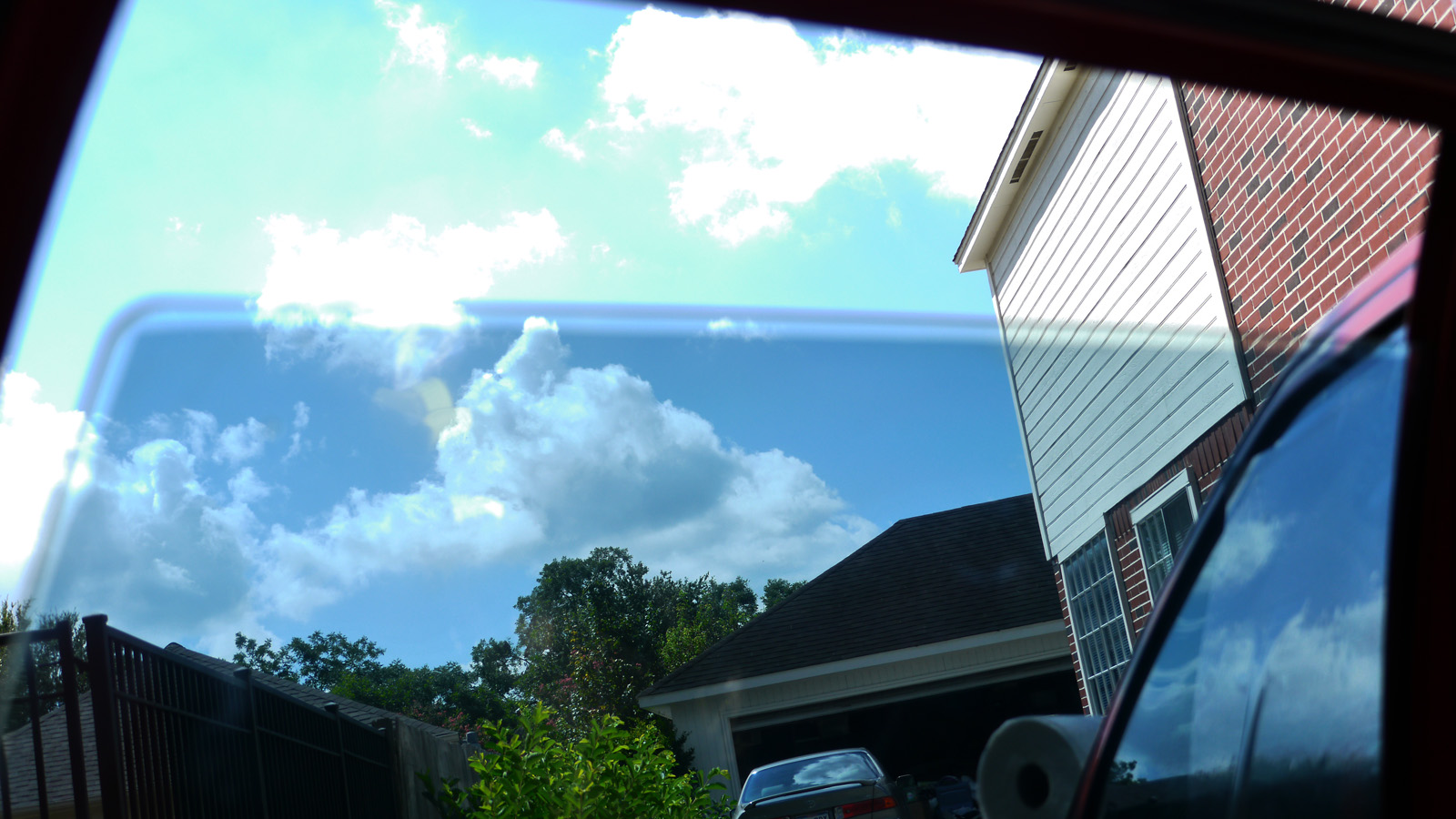

You can see its best to tint in good light. I also made the mistake of using a heat gun or blow lamp on the film. This film expanded. it did not shrink because its not automotive tint film. Its actual architectural film that I had spare from doing the house.

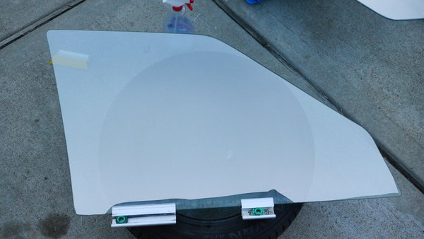

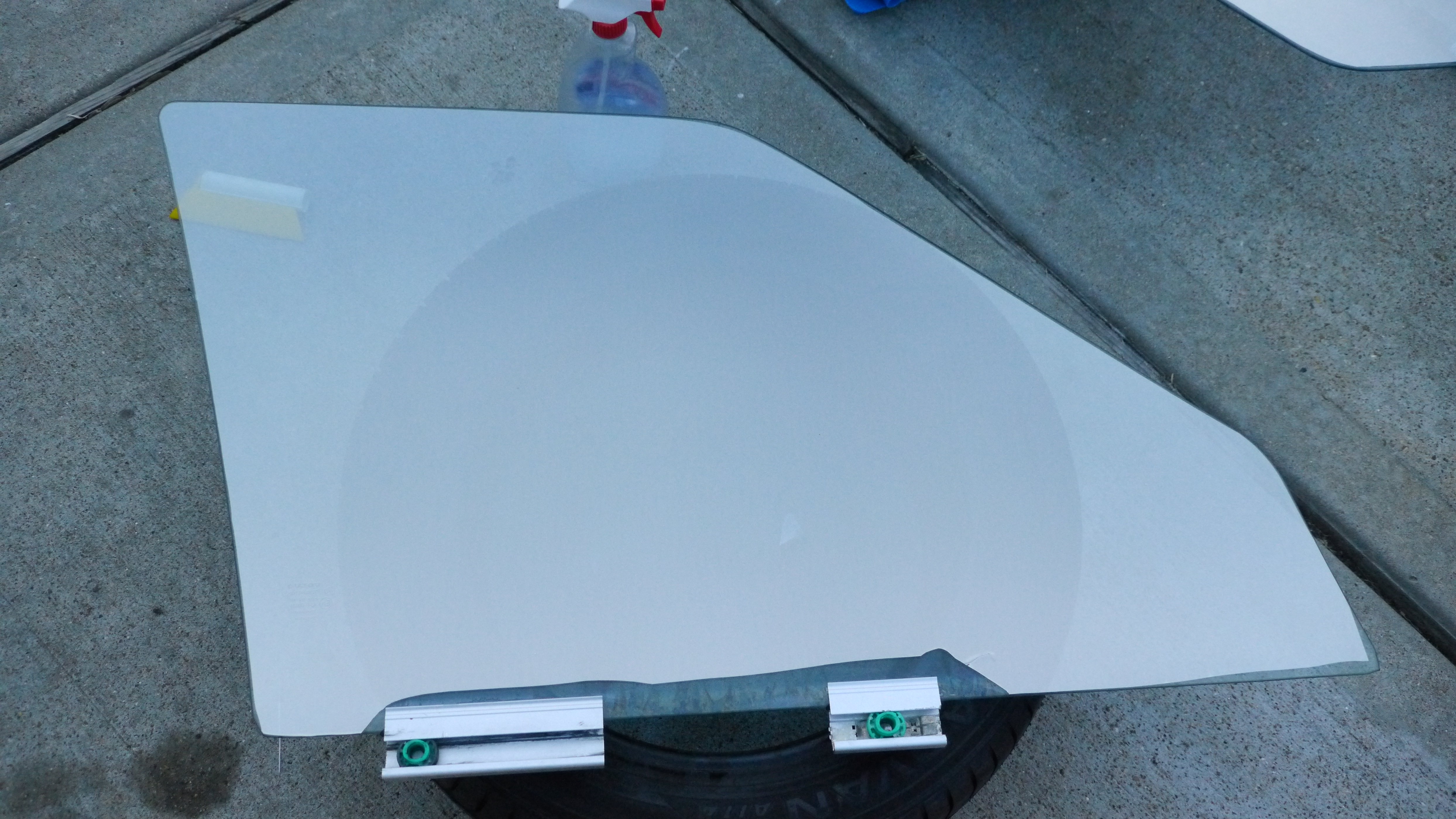

This image illustrates the difference between the tint and non tinted area.

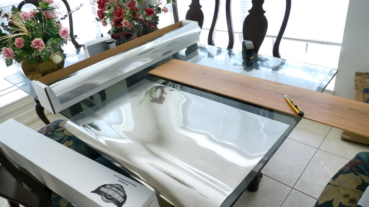

I cut the film inside on a glass table as the film roll was 3 ft wide.

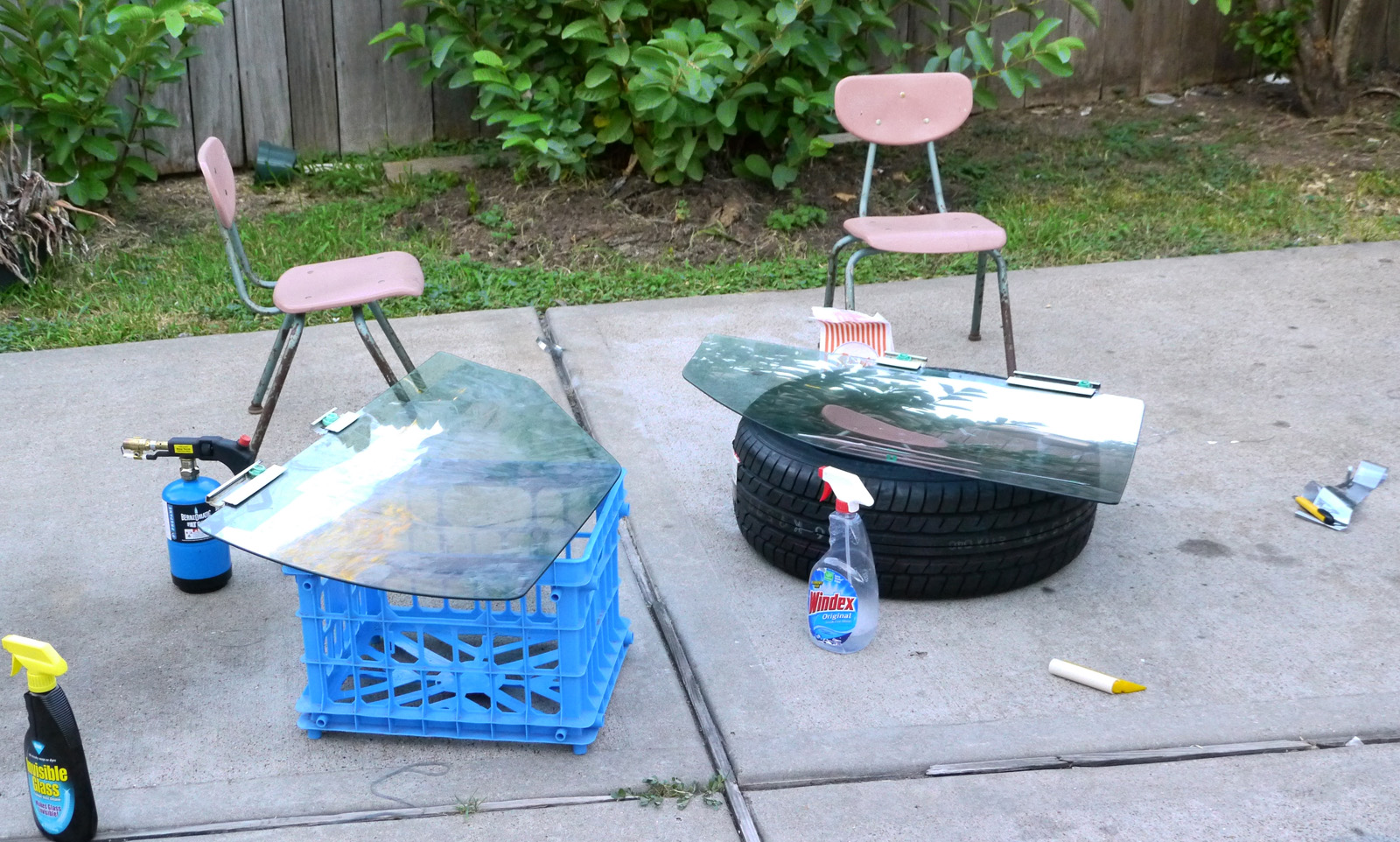

I cleaned the front windows with comet as they had glue, hand prints and all sorts on them. I just wanted it done right.

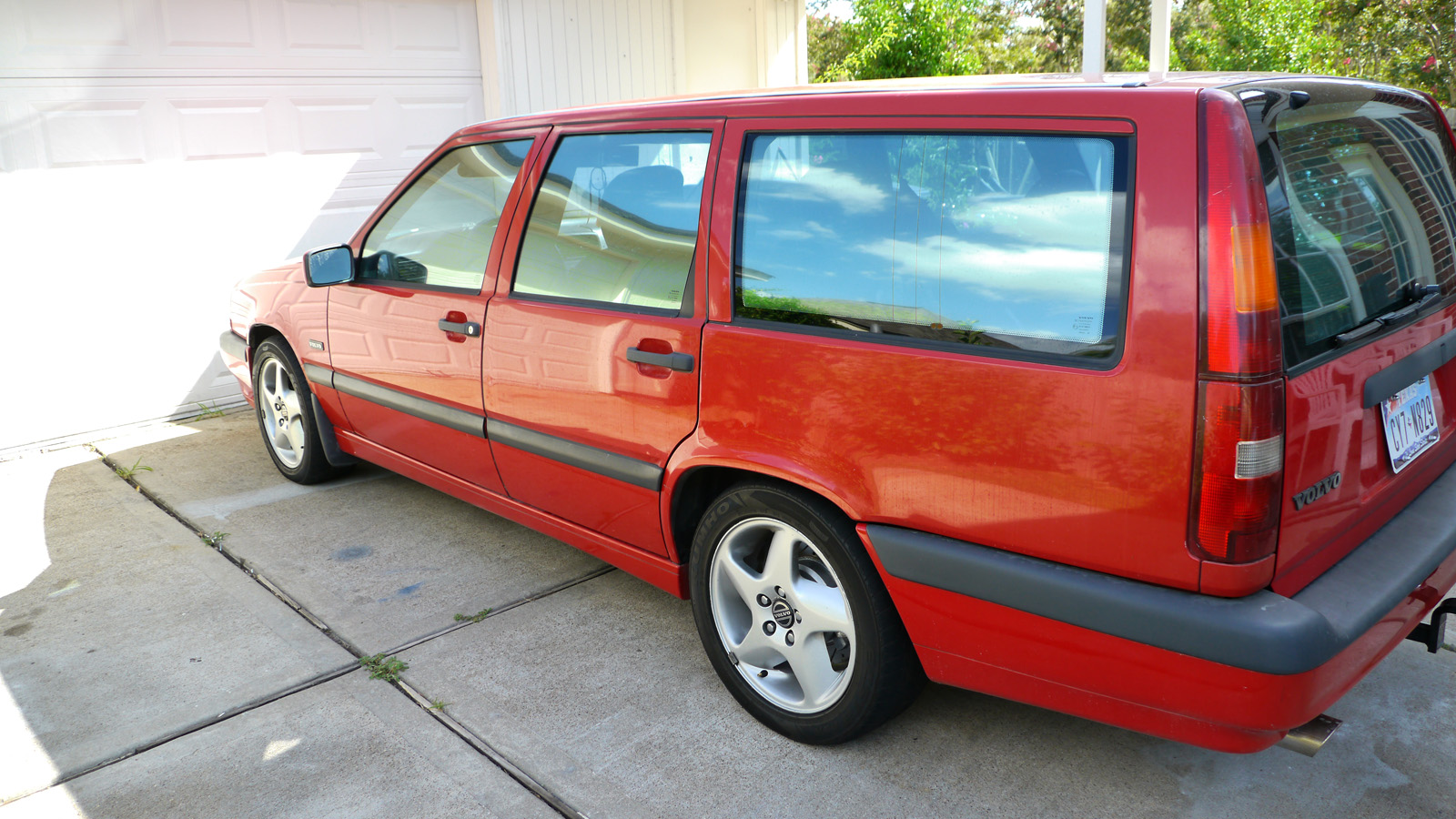

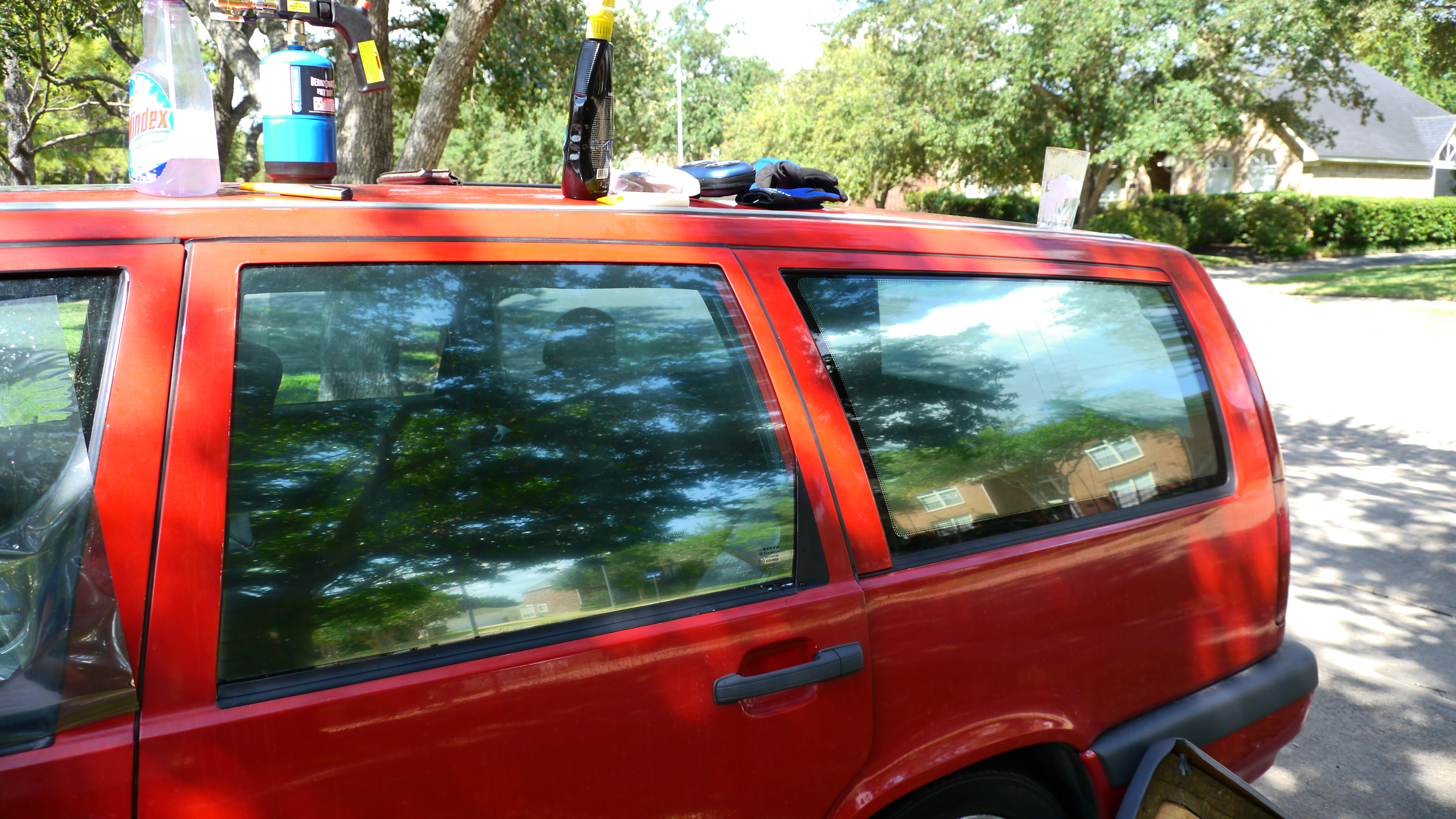

You can see the difference the tint makes. It reduces sunlight by 70% and UV by 99% I think the infrared light is also stopped by 100%. Not to sure but its something like that.
The cabin temperature has been considerably lowered and the car is in Houston Texas with humidity in the 100% range! Using the AC constantly is horrible and today I heard the compressor switch off twice as the cabin temp leveled out. I wish I could do the front wind shield but that is not possible.

Comet clean Cutting and shaping the film is the same as done on the rear.
Again using the heat gun on this film was a mistake because it metalized.

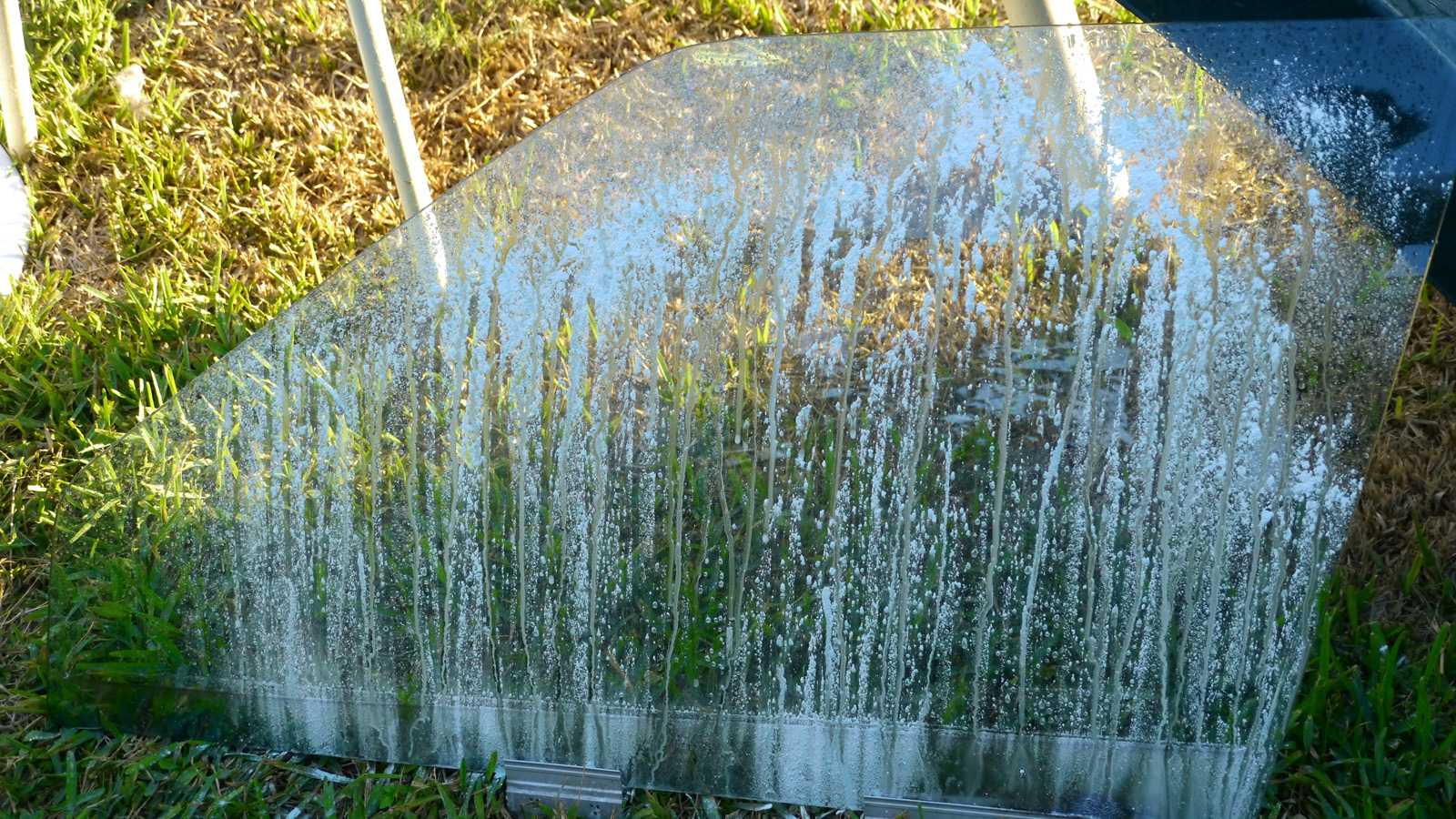

I needed the light so I went outside. I didn't use the heat gun. I just waited and kept on pushing on the film that stood up. It sat down eventually.

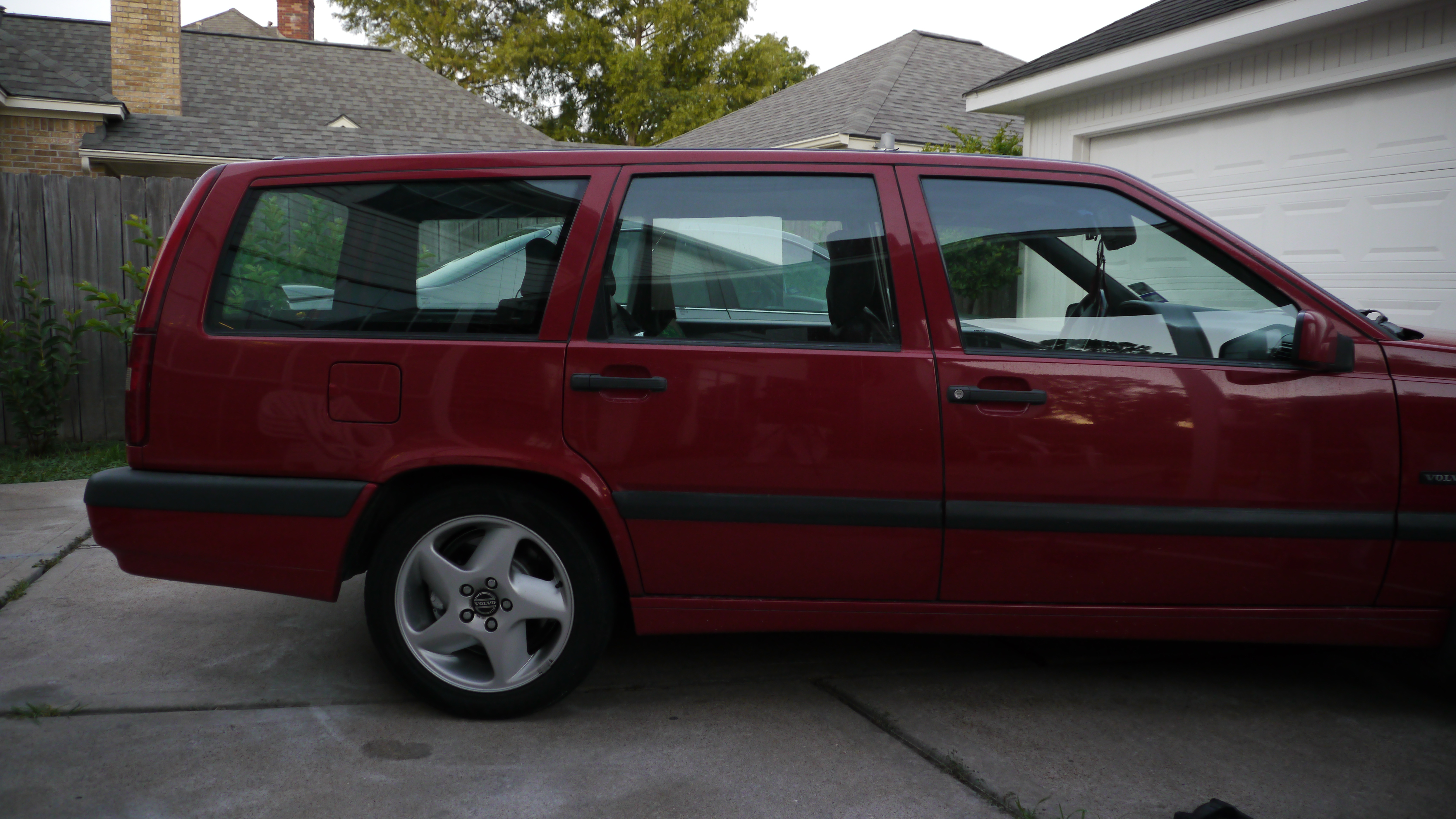

This is how it looks when its done.
And that is all she wrote.
