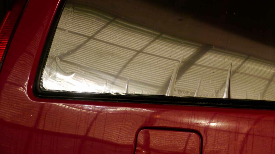

Interested in DIY windows tint on your Volvo? Well you don’t need much in the way of tools. A Olfa snap off knife. A squeegee, some Baby Shampoo and a mountain of perseverance. And quality auto window tint.
I had old tints on my glass which I painstakingly peeled off. That took two days. After that I had to knife and use a brake cleaner to make sure nothing remained. Everything was clean and ready to have a tint cut out. We start with this. I removed the trim in hopes of making the tint perfect. Waste of time but oh well.
(A cheap steam cleaner would have helped removed the old tint in a few minutes)
Tint your windows -- a tutorial
Before
After
