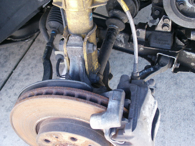

My guess is that you have a bad motor mount as well. Likely the one that Justin mentioned. Most people don't make the effort to check that mount because you have to take the wheel off and pull the skirt back. Here is a pic of a bad mount. When it's bad, the weight of the motor is in the bottom of the mount, which is rubber but it doesn't absorb the vibration like a good mount does.
Bad mount in a S70
Good mount in a S70
Bad mount in a 850
Good mount in the same 850
Bottom of the mount is often rest on
It vibrates more when resting on the bottom of the mount. When good it floats in the mount.

Just bought an aftermarket mount for my 2000 S70. It didn't fit. The motor mount holes are too far to the right about 5 mm. See attached picture. Bummer as the OEM ones are ~$125.

Well the top (old) one came off the 2000 S70, the bottom (new) one is suppost to be for an S70, but there's enough of a missmatch that it doesn't fit in, unless perhaps I lever the motor forward a half a centimeter or so.
