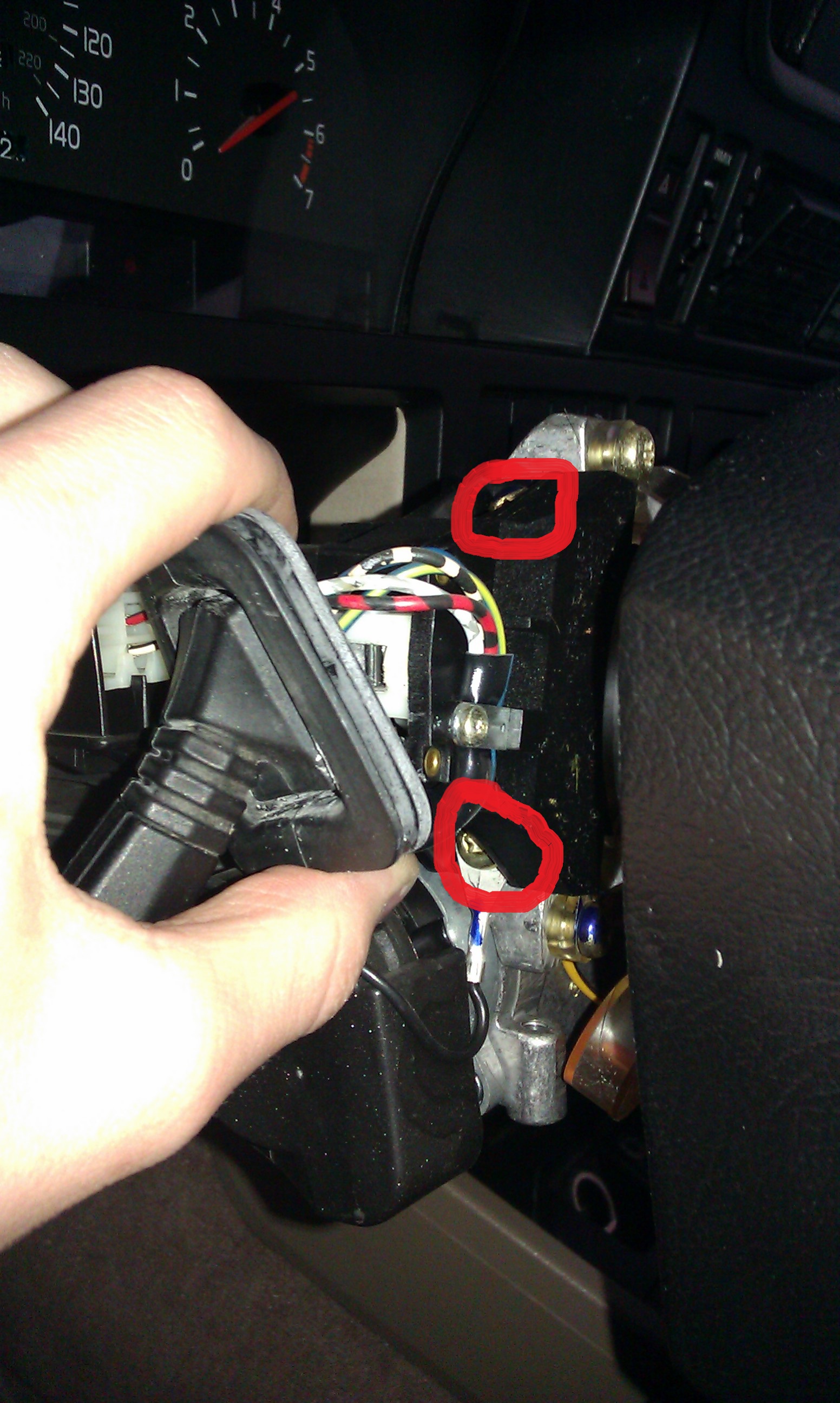

Next, remove these two bolts, the bottom one has a ground wire on it, make sure you don't for get it when you are re-assembling.

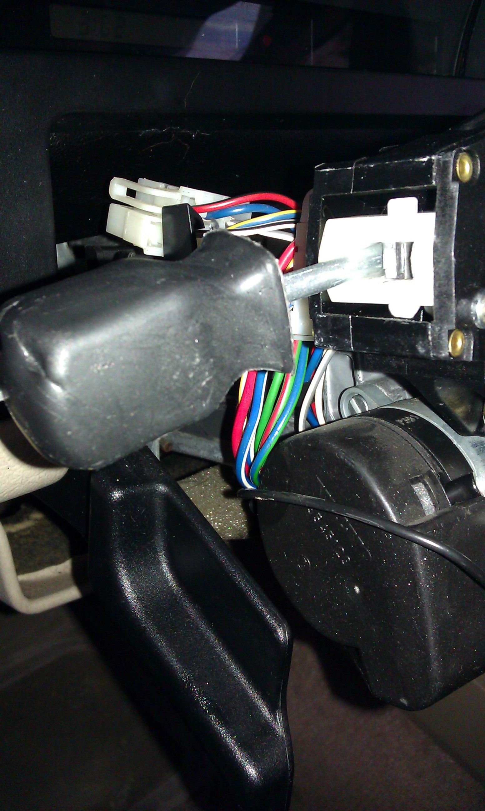

next, remove the two electrical harnesses, and take the unit off, I took mine off, and temporarily replaced it with a screw driver, and when you get the new one, re-assemble in reverse.
