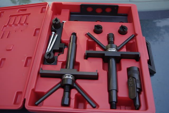

Also, I bought the KTC Tools Volvo Camshaft/Crankshaft Locking Tool, which comes with no instructions whatsoever.
I'm following a few tutorials on cylinder head replacement, so the Cam Locking Tool is mostly self explanatory. I'm wondering though, is this small piece below what you're supposed to insert in the hole behind the starter to lock the crankshaft?
If anyone has used this tool kit, maybe you could clue me in. Thanks.

Ignore the paint. I often do cam belts with no mark alignment and only my paint marks. His marks won't mean anything to your head R&R task.
winged handle rigs are used for pulling top of head down to close the gap between the two parts when going together.
bent plate at top will hold front of cams into the upper head when removing and installing.
the tool on the left, 2 short bolts, 2 long bolts, and the two round tabbed extensions are for indexing (aligning) the cams. Your will not need the extensions and long bolts for your 98.
The last tool shown also in the other picture is inserted into the hole behind removed starter and the crank is rotated CCW to stop against the pin for 100% accurate crank alignment. This is optional, especially on non CVVT engines, if you are sure to look straight down and get the oil pump pointer and notches on crank gear aligned spot on.

Those thick spacer-looking things with the fins on them are for the distributor and camshaft sensor cam ends. The two ends are different in the way the slots in the cams relate to the seam between the upper cam holder part of the cylinder head assembly, . The cam slot will sit above one, and below the other. When you put the holder tool on, it only will fit the correct way, and locks the cams into perfect position. I used the extension with my 97 to avoid having to remove the upper engine mount bracket...the extension allowed me to straddle it.

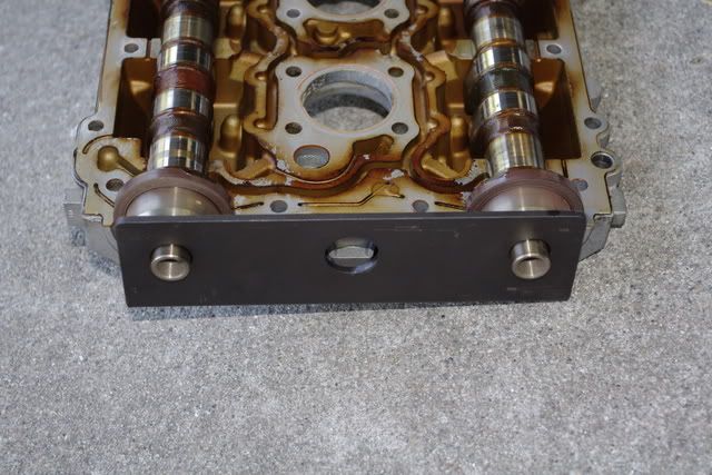

Even if you mess up and the camshafts get out of whack, you can still use the tool to secure them. (rear cams)
On the front cams, you use the upper timing cover bolts to secure the tool. The top is facing down here. I'll get a picture of that part during reassembly.

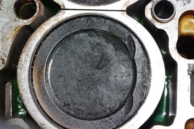

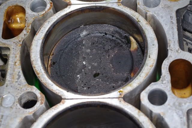

Piston crowns definitely need a good cleaning.

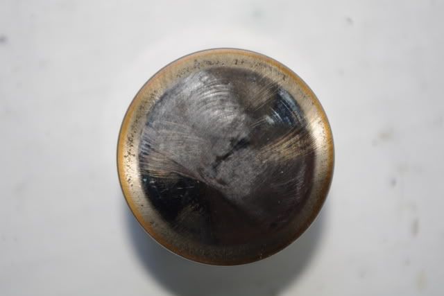

And how does this cam follower look? Is that enough wear that they should be replaced? I did run with valve ticking a couple years back, before I got the oil pan seals replaced.
Yeah so anyway, the diagnosis had been bent exhaust valve on cylinder 1. Those valves have oil cake all over them, while the rest are dry. So I think maybe the valve stem seals just blew out.

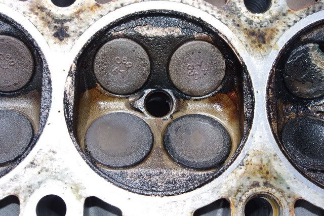

Got all the cam followers out and flipped the head over. Looks like one burnt valve.
The rest look great.
The machine shop quoted me $200, plus $35 if it needs to be decked, and another $30 to pressure test. He may have said pressure testing is included in the $200. I'm gonna bring the upper head and see if he'll throw that in the tank too.

Classic burnt exhaust valve. Unfortunately!
Not clear from your posts so apologies if this is redundant, but be sure to get the shop to put in new valve stem seals. I argue against the cheapies and for Victor Reinz, you don't them going out again. I think jimmy57 recently posted about an aftermarket brand that does OK, but stay away from Elring.

Indeed, I brought 20 Victor Reinz valve stem seals with me. Also an aftermarket exhaust valve that I bought from IPD. He looked at the oil buildup around the cylinder edges and said a little oil is getting through the piston rings. That's how a valve burns, hot oil gets through and hits the valve like a torch.

Oh yeah, so I brought the upper cylinder head with the cams attached just like in the picture above. He's putting the whole thing in the tank tonight, cams and all.
