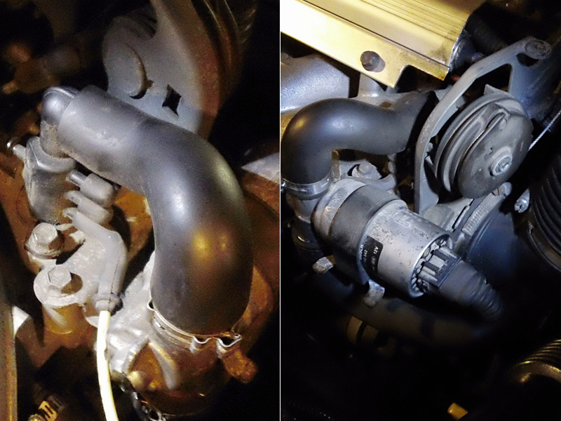

I now have tools for this job. Added a set of magnetic sockets for 1/4" drive, and flex ratchet wrench. Looked around the work area for comfort.
If recommended, I would try the crimp clamp with Oetiker.
I believe, these are fixed size clamps, there are 4 clamps of one size, and 2 of other, total of 6.
What are these two sizes?
OR should I stick to worm type?

There are several steps before getting to intake manifold, hence PCV parts replacement. There is IAC, and throttle control with their clamps, hoses, connectors, flame trap, and more. It is hard to bypass if these two need care, cleaning and replacing.
How to prevent failure of these two?
I am starting out with IAC and its hoses, which are not clamped on the other end.
The clamp is new to me, the design suggests, these are reusable, is it?
Is hose quality a visual inspection?
xHeart
- Posts: 3321
- Joined: 03 Dec 2011, 08:05
- Year and Model: 2.0/3.2
- Location: Great Lakes - USA
- Has thanked: 116 times
- Been thanked: 119 times
The two 12mm bolts underside the intake man, one fastening the dipstick assembly, are not a straight shot from below, even if I remove the air guide/pan. It would have to be worked out from the above.
Learning from fuel filter replacement, the bracket was twisted while removing the old fuel filter. Is there a need for PB Balster, would turning bolt twist and damage the bracket holding the dipstick assembly?
