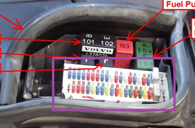

Anyone has tried to inspect the Central Electric Unit for corrosion? I am interested in inspecting contentions underneath the unit marked with purple color. Any tricks to it, or it's just about unscrewing it and lifting? Thanks
fuse box volvo.png (622.17 KiB) Viewed 11838 times
