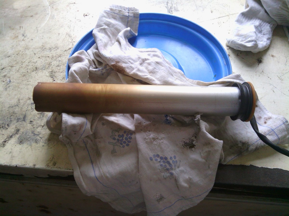

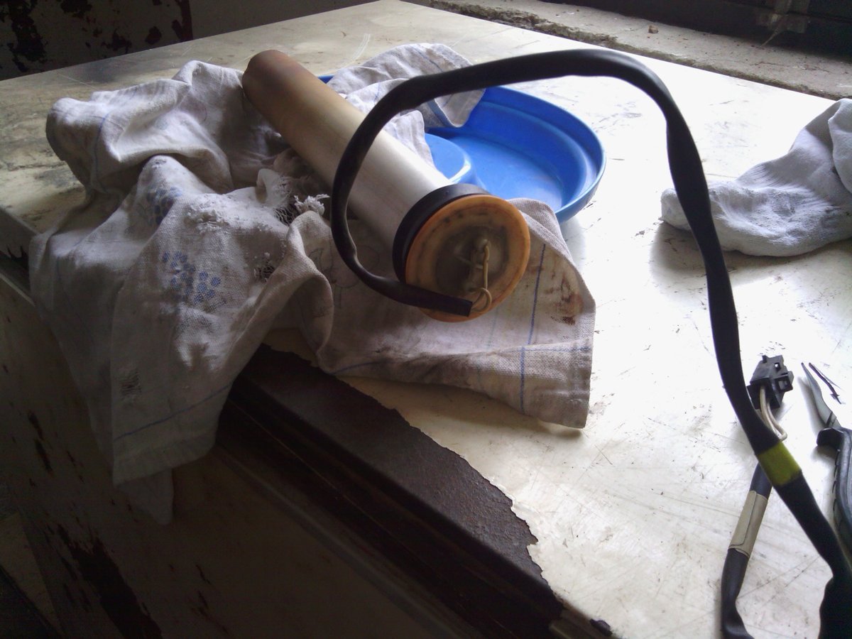

I removed it today,opened it,cleaned contacts inside,shaked it a little up & down...closed it and returned it back to its place.Everything is ok for now.
Here are the pictures of it: Never seen an fuel level sender that looks like this one!
