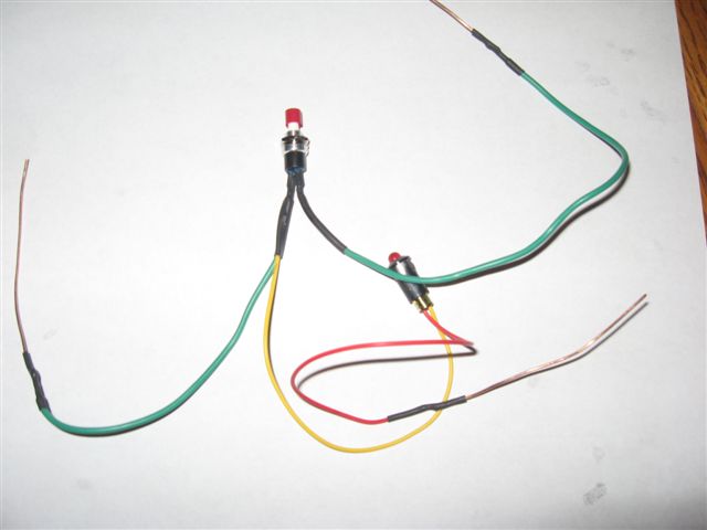

If it's of use, I wrote up a short guide on building and using a simple ECC code reader. Here is the direct link:
https://www.matthewsvolvosite.com/forums ... 43#p251189

Update - I built the LED code reader suggested by jreed and it works great on all modules except the ECC (OBD-2 connector 6). When connected to connector 6 the LED comes on when I press the push button, but no codes are displayed. In contrast, when connected to other connectors (like 3 for example) the LED blinks when I press the button and then gives me the code afterward (such a 1-1-1).
I thought well maybe this is consistent with the ECC being completely dead because it is getting no power, but I went through the pin voltage tests for the ECC connectors and as far as I can tell they are giving values within range. Most importantly, the ECC seems to be getting voltage and the ground functions. Are the DTC codes stored within the ECC unit or somewhere else? I'm thinking maybe both ECC units I have really are completely dead and thus unable to do anything or return a trouble code?
I'm tending to rule out the ignition switch as from looking at the wiring diagram it has no other function than to supply the ECC power, and power to the back of the ECC does not seem to be a problem.

I haven't experienced what you're observing -- a few thoughts:
You might have a 'dead' or damaged ECC unit. Have you opened it up to check for exploded / leaking capacitors (a failure mode others have reported).
Are the connectors on the back of the ECC seated firmly?
The fact that your code reader works to read pin 3 suggests that it is probably OK. On my ECC unit when I push the button, the unit blinks back "1 1 1" when there are no error codes to report.
What type of LED and resistor combination are you using?\
Good luck!

I'm using a 12v LED and a pushbutton switch as shown in the pic. The reader seems to work fine. I get the 1-1-1 code for all modules except the cruise control (where I got a different, but normal code) and he ECC, where I get absolutely nothing. I'd taken a quick look inside the ECC and saw nothing that stood out (burned circuit boards etc) but will take a close look today.
The OBD-2 reader is pretty cool however, even if it hasn't helped on the ECC.
thanks - Mike
thanks - Mike
