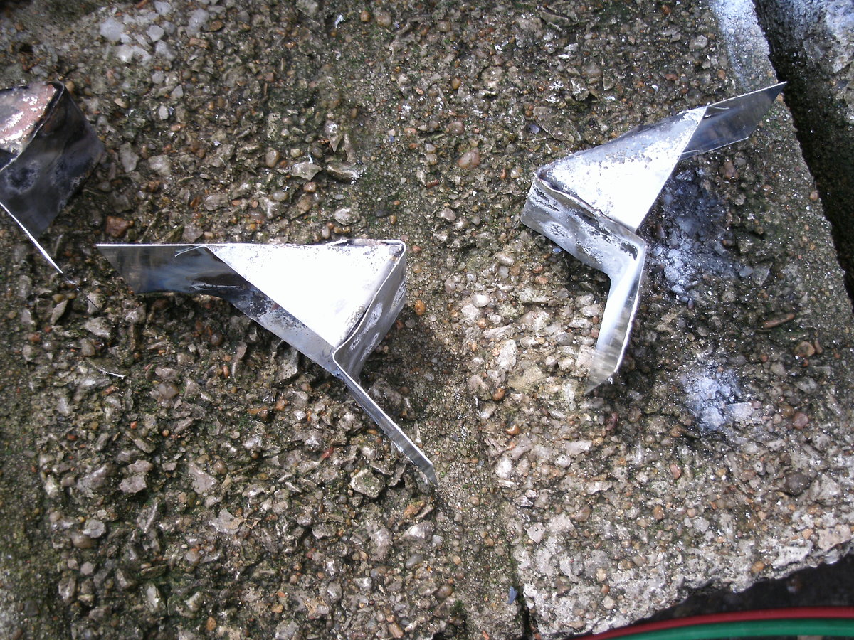

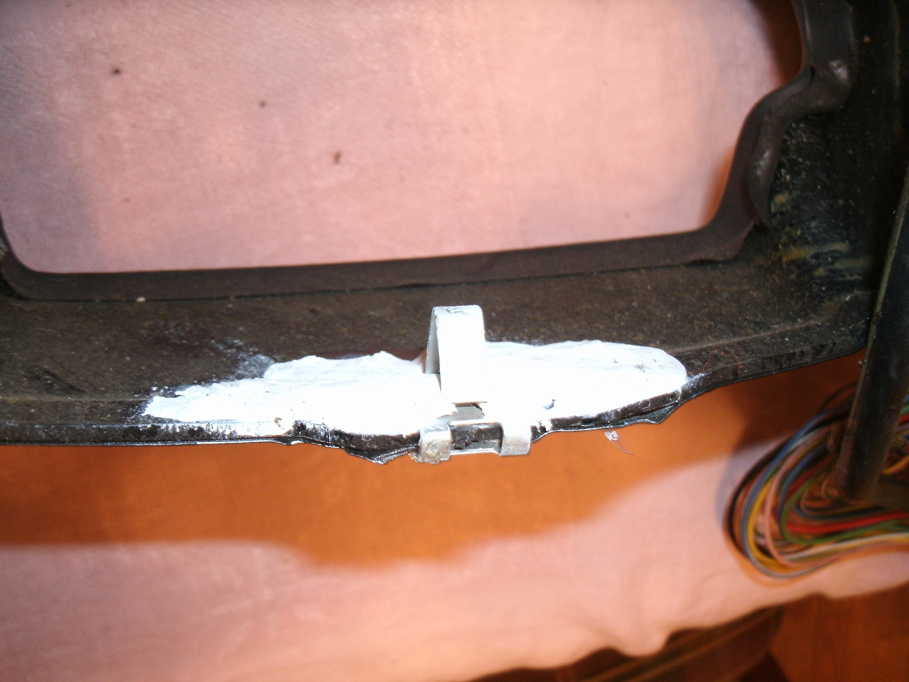

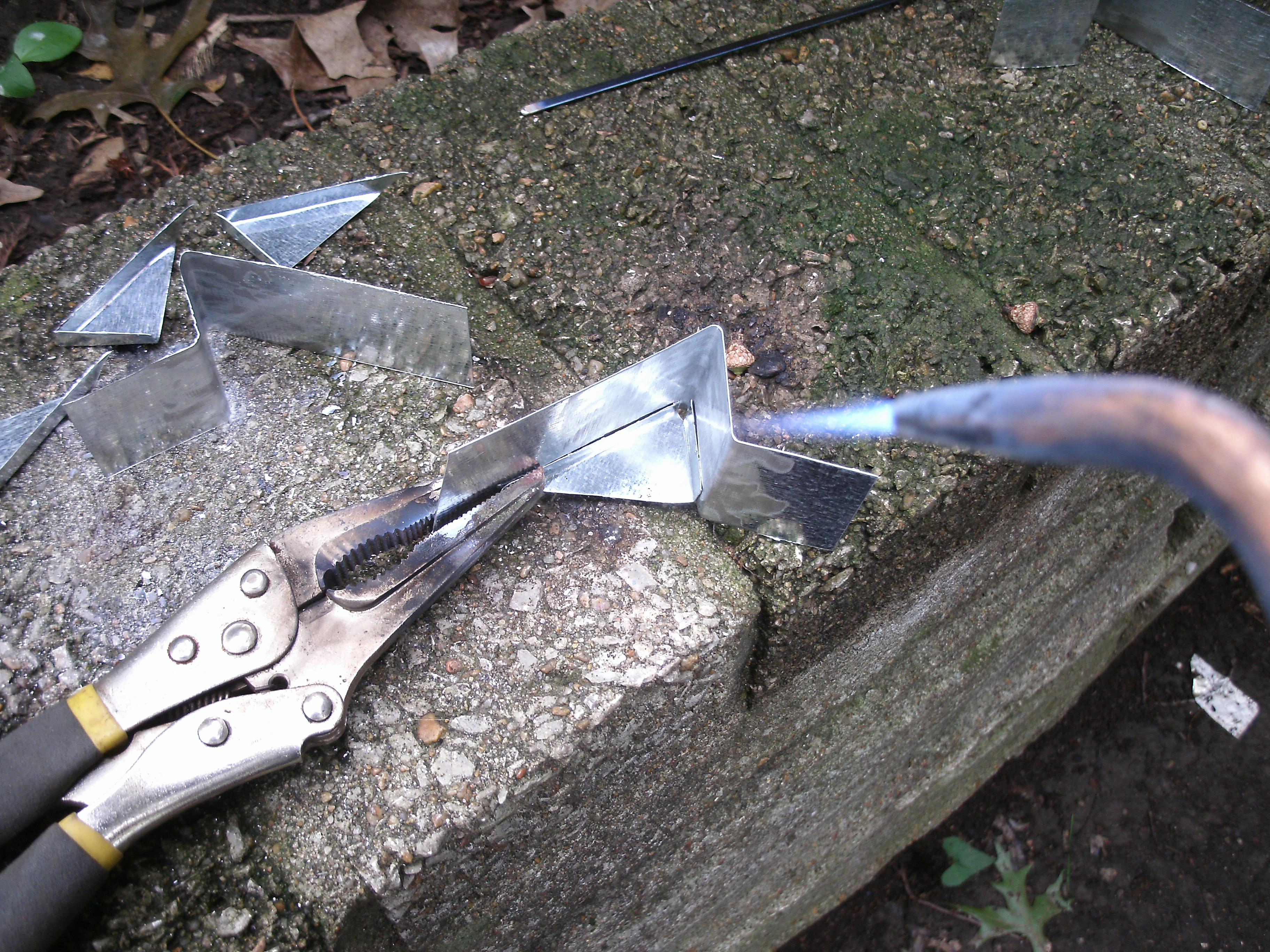

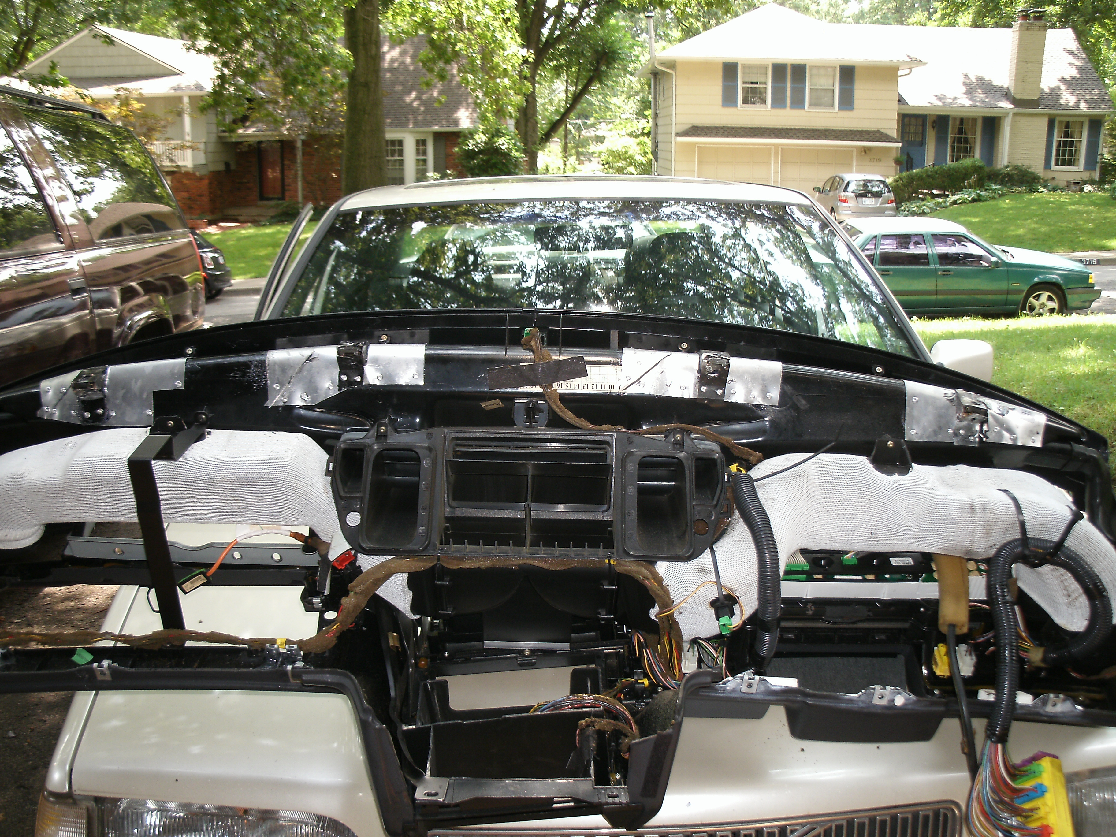

I just went through the same thing, again, on the Platinum. If you can find a salvage dash than that is the way to go if the price is right. I had a writeup about 5 years ago with a method of repairing and reinforcing the mounts. After 5 years I had to pull the same dash and the problems persisted. The reinforced mounts helped the mounts that had not already broken but they failed on the mounts that were broken like yours. The dash can be repaired but it is neither quick nor easy. Here is a preview of what mine looked like after I rebuilt the mounts. In your case this would be fairly easy since the bulk of the mounts are still in one piece.
I won't win any prizes for pretty or my torch welding abilities but here is what the dash looked like just before I put it back in.
I had to fabricate brackets to take all of the load off of the original mounts.
I am going to update my original dash mount repair writeup but this was done fairly cheap with a combination of 5" by 7" steel and aluminum roof flashing tabs and about 3 tubes of JB Weld epoxy.
While the dash is out you can also repair the lower dash panel mounts with JB Weld Marine epoxy which is like putty that gets hard.

Well, I hope the strap fix I did will hold up for a while.

This is how I repaired the tabs.
