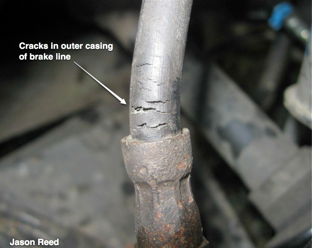

How I knew I needed to do this job:
The brake lines had visible cracks in the rubber near the metal fittings.

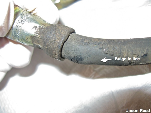

Later after removal of the lines, when I did a little inspection of the parts, I found signs of brake fluid seeping through one of the bulged areas.

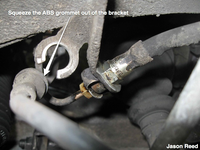

I sprayed brake cleaner on the fittings at the hard line end and at the caliper. Put a catch pan under the fitting to hold the cleaner, P’Blaster and brake fluid that will start dripping out once you loosen the fittings.
Then I loosened up the dirt with a brass brush.

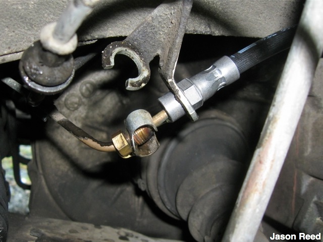

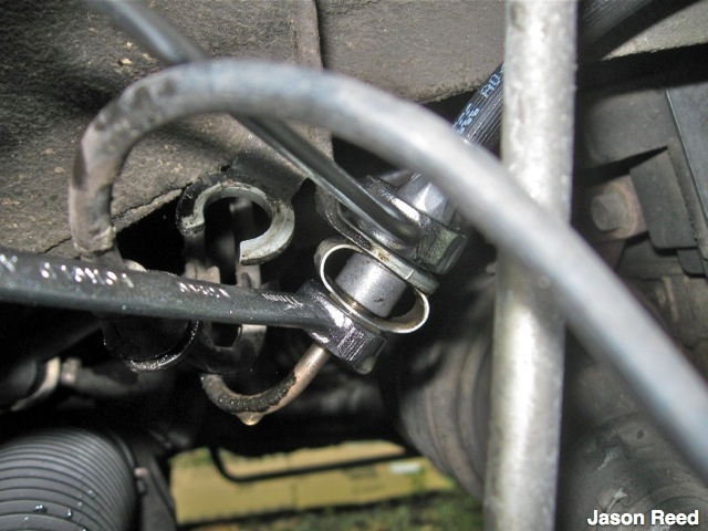

Brake Line 02.jpg (135.93 KiB) Viewed 15731 times

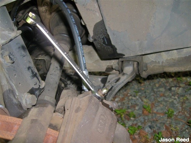

If you put the wrenches on at the right rotation, you can squeeze them together with one hand and avoid twisting the hard line.
Over at the caliper end, use a 14mm flare wrench to loosen the fitting. This one also came out smoothly.

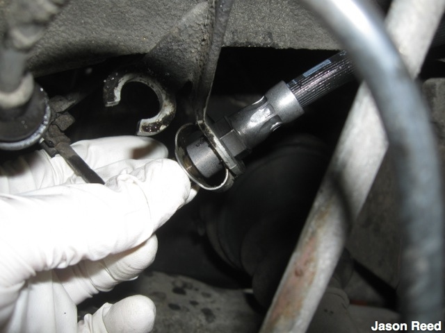

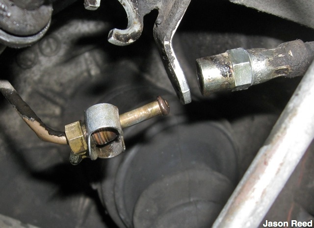

Once you get the flare nut loose, you don’t need to counterhold any more. You may be able to use a regular open end 11mm wrench at this point without risk of damaging the flare fitting. I opted to keep on using the flare wrench until I could turn the nut with my fingers.
Brake fluid will start to drip out of the connection but I found that it was a slow steady drip. If your master cylinder is full when you start, you will have a long time before you will deplete the reservoir from the drip.
Brake Line 13.jpg (101.64 KiB) Viewed 15731 times
Once you fully loosen the nut, you can separate the flex line from the hard line. Brake fluid will continue to drip out of the open hard line. Take your time and don’t worry—it’s a slow drip.

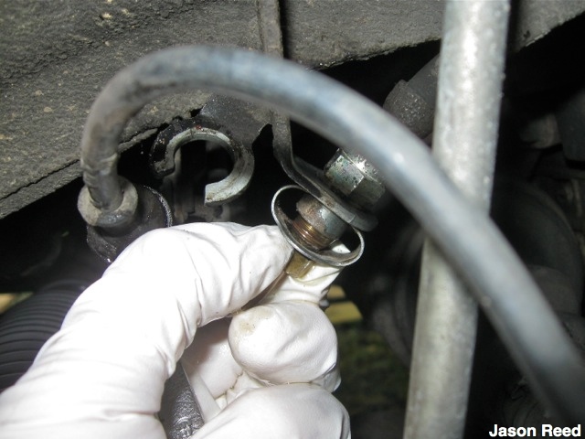

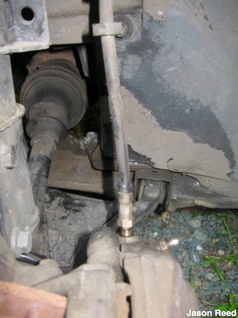

Install the new brake line on the caliper end first. You might be tempted to install the line on the hard line end first because that is the end that is dripping, but don’t do it. Install the line on the caliper end and tighten it up to final torque so that when you connect to the hard line you won’t have to twist the line.
Brake Line 16.jpg (119.92 KiB) Viewed 15731 times
VADIS specifies 18 N⋅m / 13 ft-lbs as the torque for the brakes lines. I don’t have a torque wrench that would fit these lines, so I just tightened them up “snug plus a little more to be sure” but not too tight.
Be careful to keep the open end of the line away from the wheel well wall so that dirt doesn’t get in.

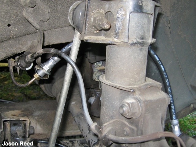

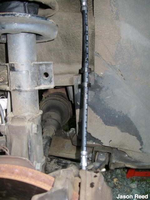

Then bend the new line over along the same route as the old line took (behind the strut tower) and fit the line into the hexagonal cutout in the bracket. Insert the hard line into the end of the flex line. Slide the clip and flare fitting up into the flex line.
Brake Line 20.jpg (107.59 KiB) Viewed 15731 times
Keep the line straight and tighten it by hand. Go easy: to get the threads to engage you have to apply a little pressure while keeping the line aligned with the fitting:
Brake Line 21.jpg (90.53 KiB) Viewed 15731 times
Once the flare nut fully engages the threads of the flex line, use the two flare wrenches again to tighten it up. When you get it tight, the dripping of the brake fluid should stop.
Brake Line 17.jpg (116.95 KiB) Viewed 15731 times

Be sure to put the ABS grommet back into its bracket if you moved it out of the way during this job. When you finish, double check the markings along the flex line. There should not be any twist in the line.

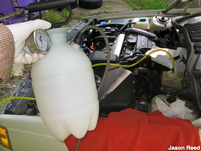

Bleeding the air out of the hydraulic lines:
There are several ways of bleeding brakes, including vacuum bleeding and ‘two-person’ (one to hold the brake pedal down while the other opens the bleed screw). I like using a pressure bleeder, which seems easiest to me. There are commercial versions available (such as the one by Motive). I built a simple one for under $20 with a garden spray bottle and an extra ATE brake fluid reservoir cap.
Brake Line 22.jpg (120.29 KiB) Viewed 15731 times
Make sure the brake fluid reservoir at the master cylinder is full of brake fluid (if you want to flush out your old brake fluid, this is an ideal time to remove the old fluid from the reservoir and refill it with fresh new fluid before bleeding the lines). Connect and pump the pressure bleeder up to about 5psi. Open the bleed screw about ¼ to ½ turn using a 11mm flare wrench.
Brake Line 23.jpg (116.71 KiB) Viewed 15731 times
Some people recommend putting a short length of tubing on the end of the bleed screw. This may be required if you’re doing the “two-person” style of bleeding and is helpful here but not necessary. Just keep your face away from the screw because brake fluid will come shooting out when you loosen it.
Allow the air to bubble out. When bubble-free clean fluid is trickling out, you’re good. I made a short video clip of bleeding the air out of one of the calipers.

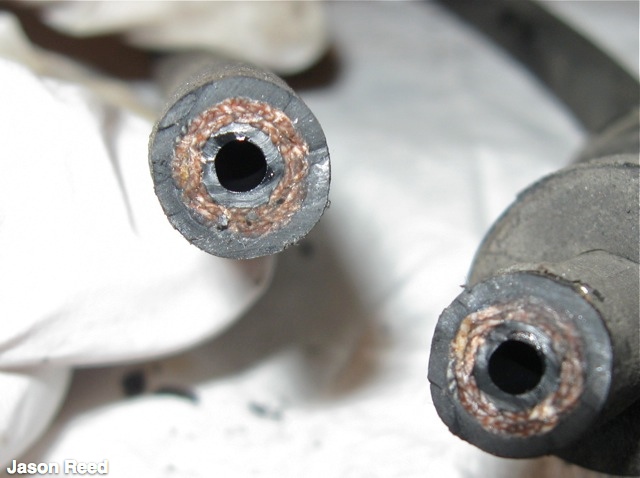

For reference, I cut a cross section through the original line in an area that did not appear damaged. You can see the black inner plastic tube core that contains the brake fluid, the brown woven wrapper in the center layer and the black rubber exterior sheath.
Brake Line 26.jpg (80.52 KiB) Viewed 15731 times

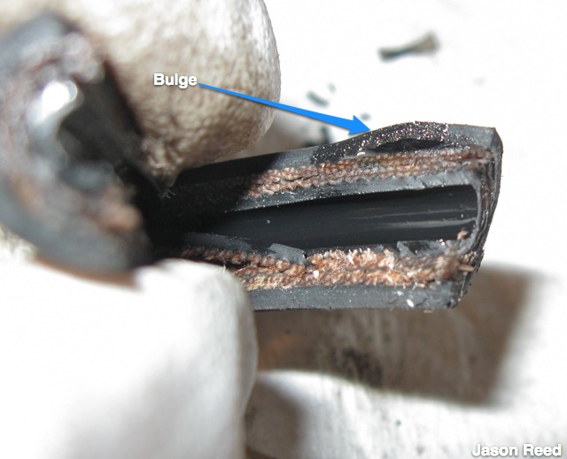

Then I cut a cross section through the bulged part of the line near the fitting. Here you can see the woven wrapper is soaked with brake fluid and the outer rubber is bulging outwards.
Brake Line 27.jpg (73 KiB) Viewed 15731 times
I sliced along the line through the bulged section and could see where the rubber outer casing had separated from the woven middle sheath.
