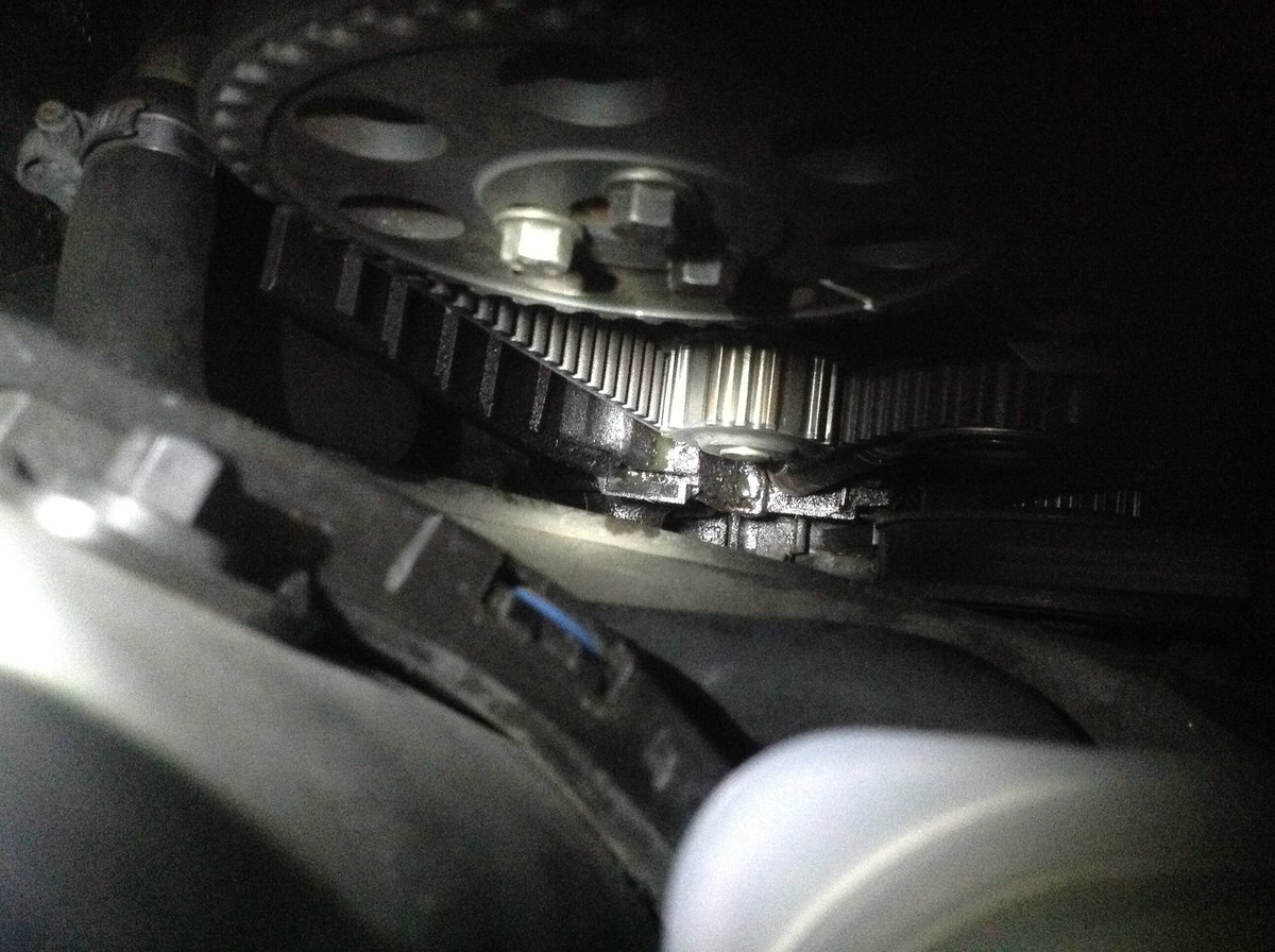

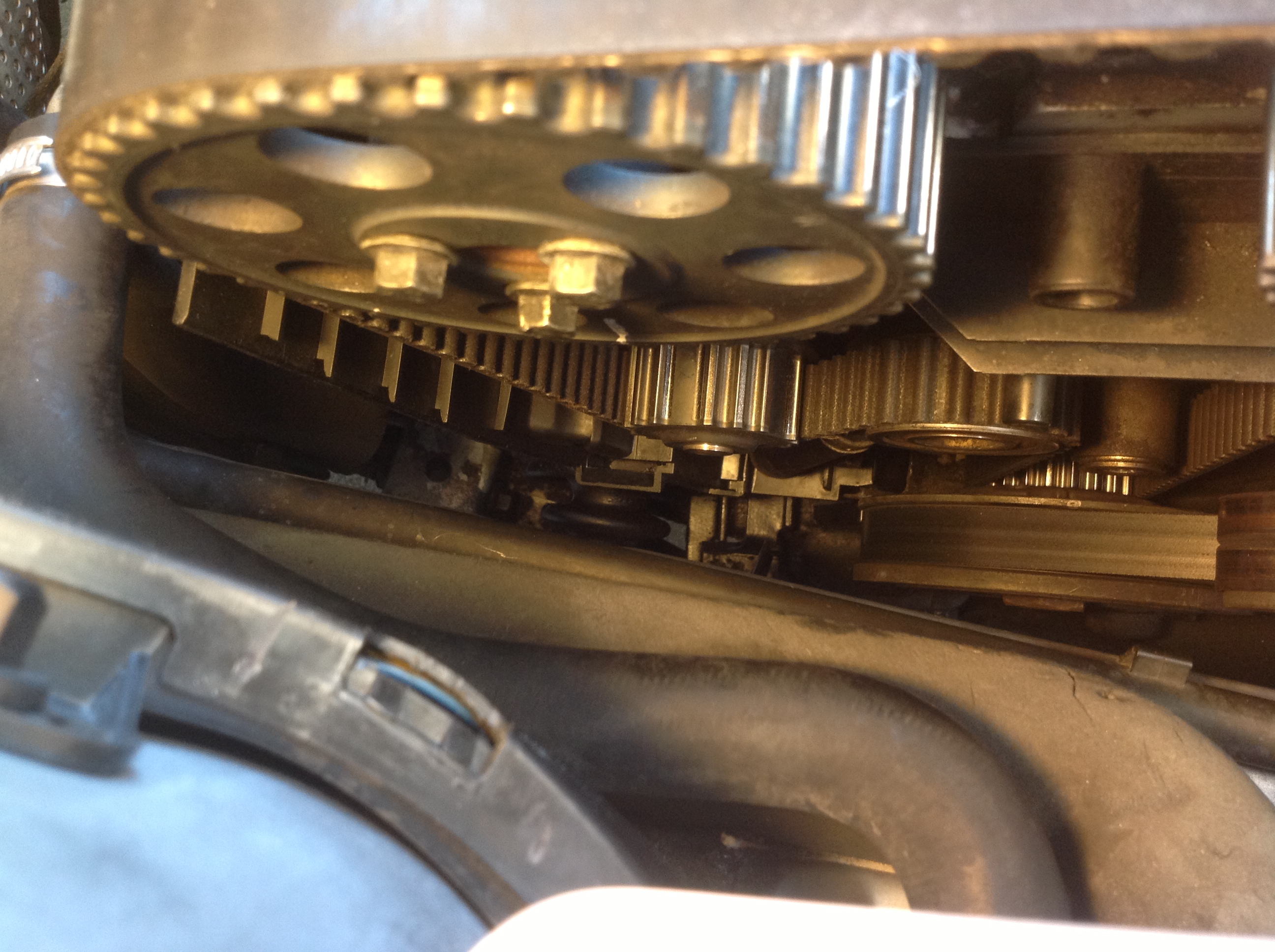

I found this website (LINK) which shows 3 sides of the engine. The water pump was leaking on my car from the car sitting for a month. The timing belt side helped with a clear view of the water pump. I was able to snug it down a quarter of a turn or so on 6 of the 7 bolts. Will look closer for the 7th but the Tensioner maybe in the way. It looks like the leak has stopped. There is absolutely no noise or looseness from the pump bearing or Timing Belt area. I believe the Water Pump was not tighten properly perhaps from the last Timing Belt job (no service records). Just did not want to do a tear down or put any more money into this car at this time as I do not drive it much.

VERY TEMP FIX! Too good to be true! Would like some help with questions with the water pump replacement. I think I can do this but really not motivated to do so. It seems to be leaking at the pump bearing seal. Anyone with experience on how long I can drive it?
I have the hydraulic tensioner. Is that more difficult to work on? Can I upgraded to the mechanical tensioner and is the Mech Ten better?
With 245K miles is it worth the expense to change all the timing parts? I have no records of the last change but it runs very quite and the belt looks good. Don't know how long the car will last before another major issue. Thanks.
