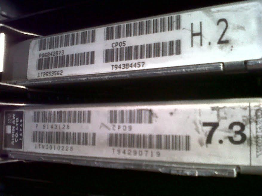

1995 850 ECU's (2?) and OnBoard DTCs

1995-96 Volvo 850 ACCESSORIES & EQUIPMENT - Instrument Panel.pdf- (550.43 KiB) Downloaded 673 times
- 1995 Volvo Electronic Control Units -ONLY TWO.jpg (45.68 KiB) Viewed 2559 times

Your car has the Motronic 4.3 fuel system.
When there are 3 ECU's the car has the Jetronic system, when there are two ECU's it is Motronic. Which is a good thing.

I also went looking for info to confirm the Fuel Managment System.
Attached is a photo of the label on the side of the ECU that is middle postition in the box, but as there are only 2 units, this is the closest unit to the motor. The label is Bosch, with the numbers 0 261 203 165
The second attached photo is the TCI ignition coil, on the driver's side upper fender. Again, the label is Bosch, with the
numbers 3 507 934
Can you help me know for sure what my Fuel Management System is (I've heard Motronic and LH3.2 per some Volvo info linked to the Vin) and/or any other info in light of the other things we talked about?
numbers 3 507 934

- 1995 Volvo Electronic Control Unit -Side Label - Bosch -# 0 261 203 165.jpg (23.93 KiB) Viewed 2521 times
- 1995 Volvo 850 - Bosch TCI Ignition Coil -# 3 507 934.jpg (36.04 KiB) Viewed 2521 times
