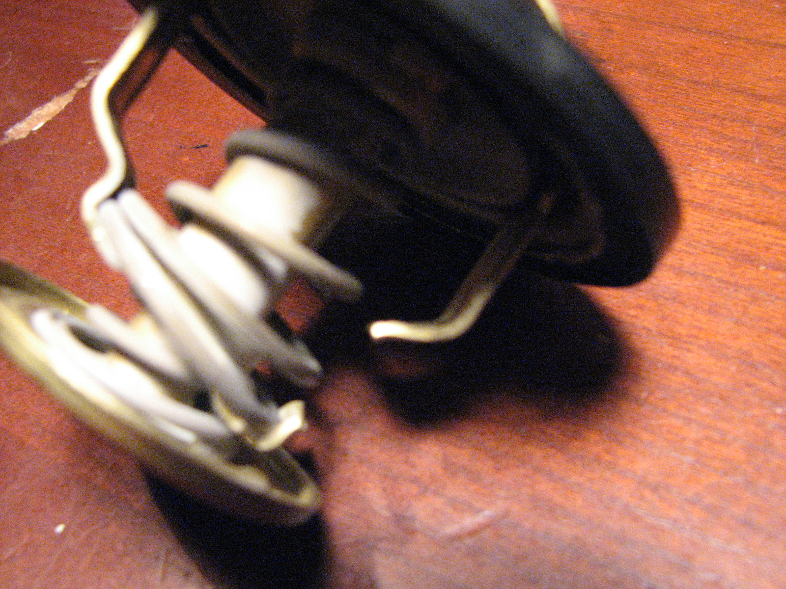

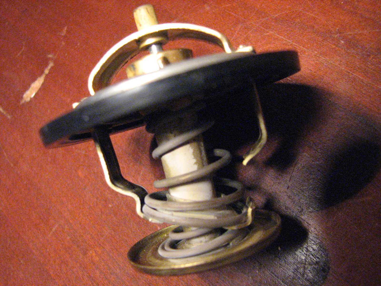

This is the Whaler that was in my wagon last year. I had not realized it looked like this.
The car did sit for three months while the weather went to nearly 20 below zero.
A full level of Zerex mixed 50/50 with distilled water was in the system.
I did end up replacing the radiator after noticing drips at the time of the silicone plumbing upgrade.
So the thermostat and ETC were also replaced with OEM Valeo and Whaler without a second glance at the old parts until recently.
I don't usually throw out old parts for reference purposes. So, funny to see this.
Now that is a fail. Would that be a closed fail? Which could be catastrophic.
I understand the whaler fails open.
I have to believe this is freeze related and I was lucky to have been replacing everything anyway.
Anyone have a definitive on this one?
850 thermostat fail. OEM.

I suppose I could try that Eric, but look at the angle the frame had broken. I would imagine it holding a pressure unnatural to the original design. Logically, it would appear to be in a locked state.erikv11 wrote:Out of curiosity: drop it in hot water, does it still open?
I must fire up the Bunsen burner right quick.

No doubt, it is badly broken and probably broken shut, I am just curious what happens.

We see this all the time in BMW with 80K+ (broken tabs as shown).
Wahler makes very good tstat. I put them in my BMW and Volvo, zero problem at all.
After 80K, I replace them as preventive maintenance and when I remove them, no broken tabs.
For the records, I use strictly Prestone Green (refresh coolant every 3yrs or so) and zero problems during the last 25 years.

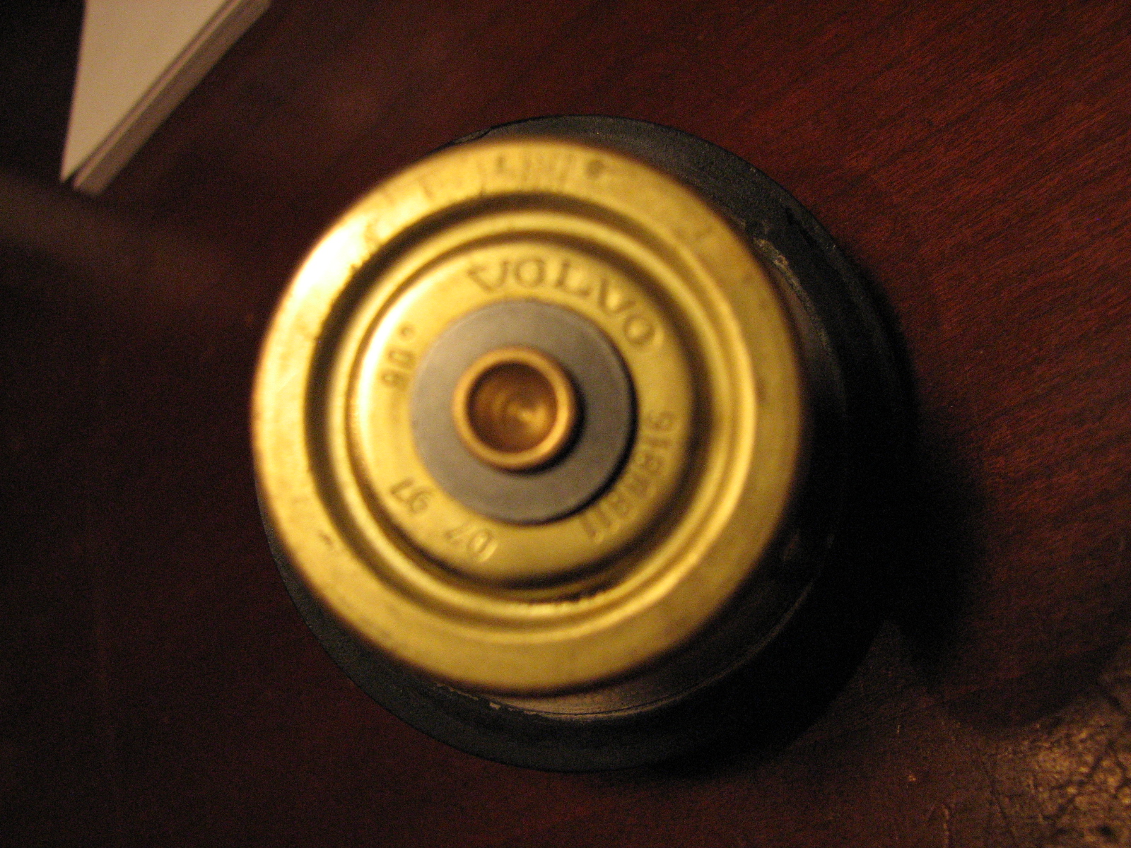

Ok, that reaffirms what I've heard of Whaler quality. It was also comforting to see the Volvo logo and date stamps.cn90 wrote:We see this all the time in BMW with 80K+ (broken tabs as shown).

Back to my point of failure. It must have happened while immobile. It ran well indicating the 3 o'clock position until I had parked it for a few months.
I'm only curious. It caused me no harm.

So do these engines all have warped heads due to the stat not opening and overheating?cn90 wrote:We see this all the time in BMW with 80K+ (broken tabs as shown). ...

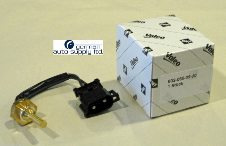

It is nice that the OEM whaler thermostats sell for about $12. The temp sensor, which I trust is SWF/Valeo , at $52. respectively but I believe it to be worth what it performs.
I had installed these in the Sedan last week an noticed the ECU immediately paying attention in a positive manor.
I can only imagine the winter heating issues will be done with as well. Throttle response had a noticeable difference.
This was not an endorsement for the supplier, but the only photo of the exact part I could find.
