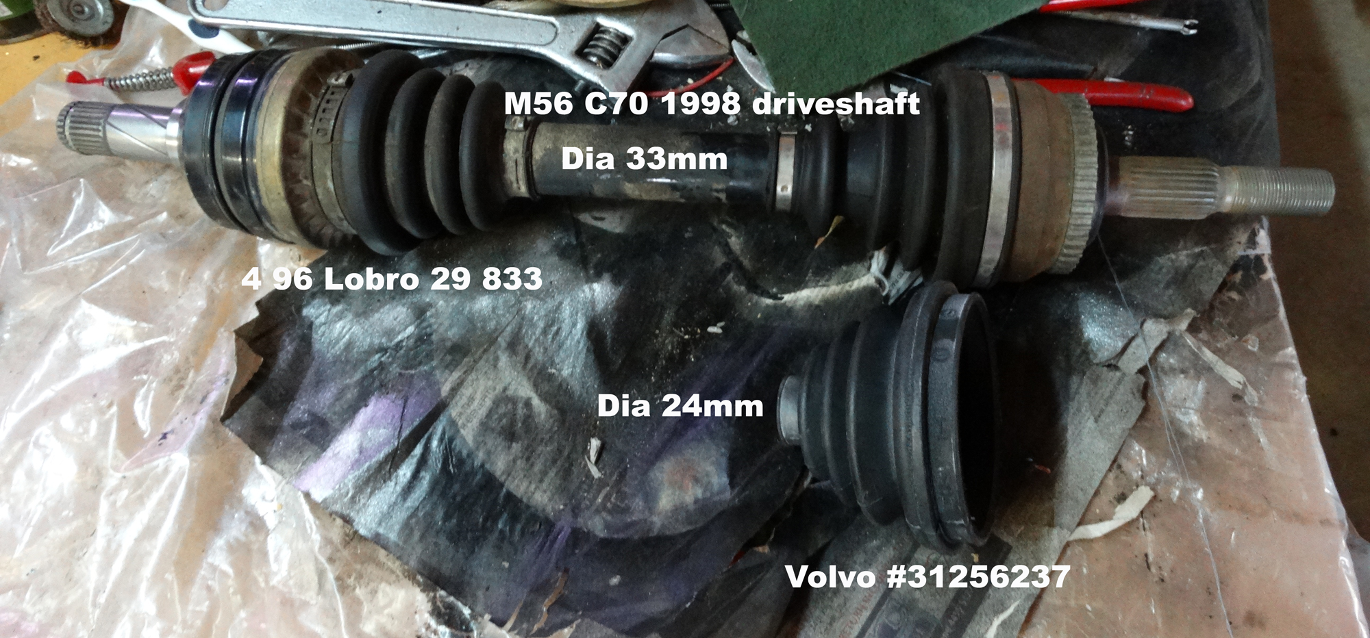

Does anyone know the part number for my driveshaft outer bellow, its not the standard size and because the stickers are not readable I cant find any info online or from the dealer.
Note part number 31256237 doesn't fit.

Manual Transmission cars with with thicker cv shaft, as you already know. Automatic shafts will fit your car fine, in cause you can't find the boot you need.

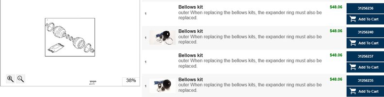

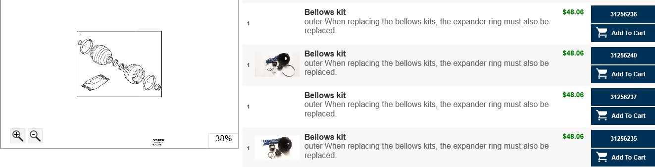

the 33mm bellow (boot) may be one of these??

Only manaul cars got the thicker shafts.cn90 wrote:
PS: I have never seen a shaft diameter of 33mm!
http://www.volvohowto.com/how-to-conver ... 70-or-c70/
The driveshafts are only slightly different. The manual is thicker (top) but the donor car’s CV joint boots were in worse nick so I stuck to my auto driveshafts for now. I’ll probably rebuild the manual ones and swap later.
From top to bottom, my auto, donor manual, spare auto. Only the outer half of the shaft appears to differ.

Hi there. Here are the part numbers you need to rebuild the manual axle:
Repair kit inner manual turbo: 31256227
Repair kit outer turbo all: 31256237
I believe you can easily find EMPI kits in the U.S. but GKN/Lobro are much better if you can find them. I can get them over here if needed.
271827 used to be the Volvo pn for a kit that contained both inner and outer but I believe they discontinued it hence the above part numbers.
