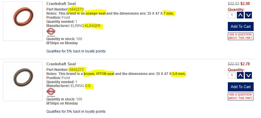

Intake, exhaust & crank seals were all replaced about 7 yrs ago (~75,000mi) by indy. I think he used Elring. I can see the intake seal is also wet, but not dripping. So both will be replaced with Corteco from RM-Euro. Problem is RME only stocks Elring for the crank:
Not sure which one I should use. Crank seal is not leaking, but thought I would do it while in there. Also, I don't own any pneumatic tools nor an impact driver, nor a crank puller nor "lock" to hold the pulley still. Haven't read up on the removal prodecure yet either. CN90 already has me on target for the cam seals.
Should I go for the crank seal or leave it alone?

Notice that though the seals posted above have the same part #, one of their dimensions is different. Odd that.....
Thanks for the links Erik and Robert.
