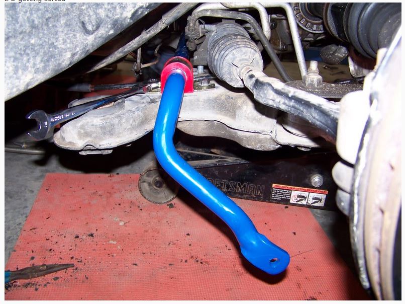

I suspect removing & installing the rear hydraulic mount would have been MUCH easier if I truly understood the definition of "dropping the rear sub-frame":
[attachment=0]Volvo_Dropped Subframe Example.JPG[/attachment]
I didn't realize one could do such a thing without damage. Evidently. I'm assuming the jack is under the rear subframe crossmember to support/lower/raise it, correct? Do the front SF bolts need to be loosened as well? I also realize the reason it is down so low is due to the sway-bar end-links being removed as they would prevent this, correct?
Main point being that if you are able to truly drop the rear sub-frame down before attempting the rear hydraulic mount, then that task will be MUCH EASIER to both remove & install.
I now understand I made the task more difficult because I didn't work SMARTER, I worked HARDER!
BUGGER ME......
