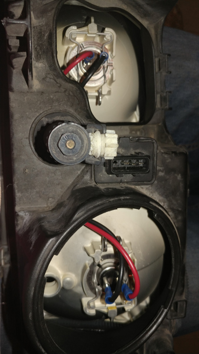

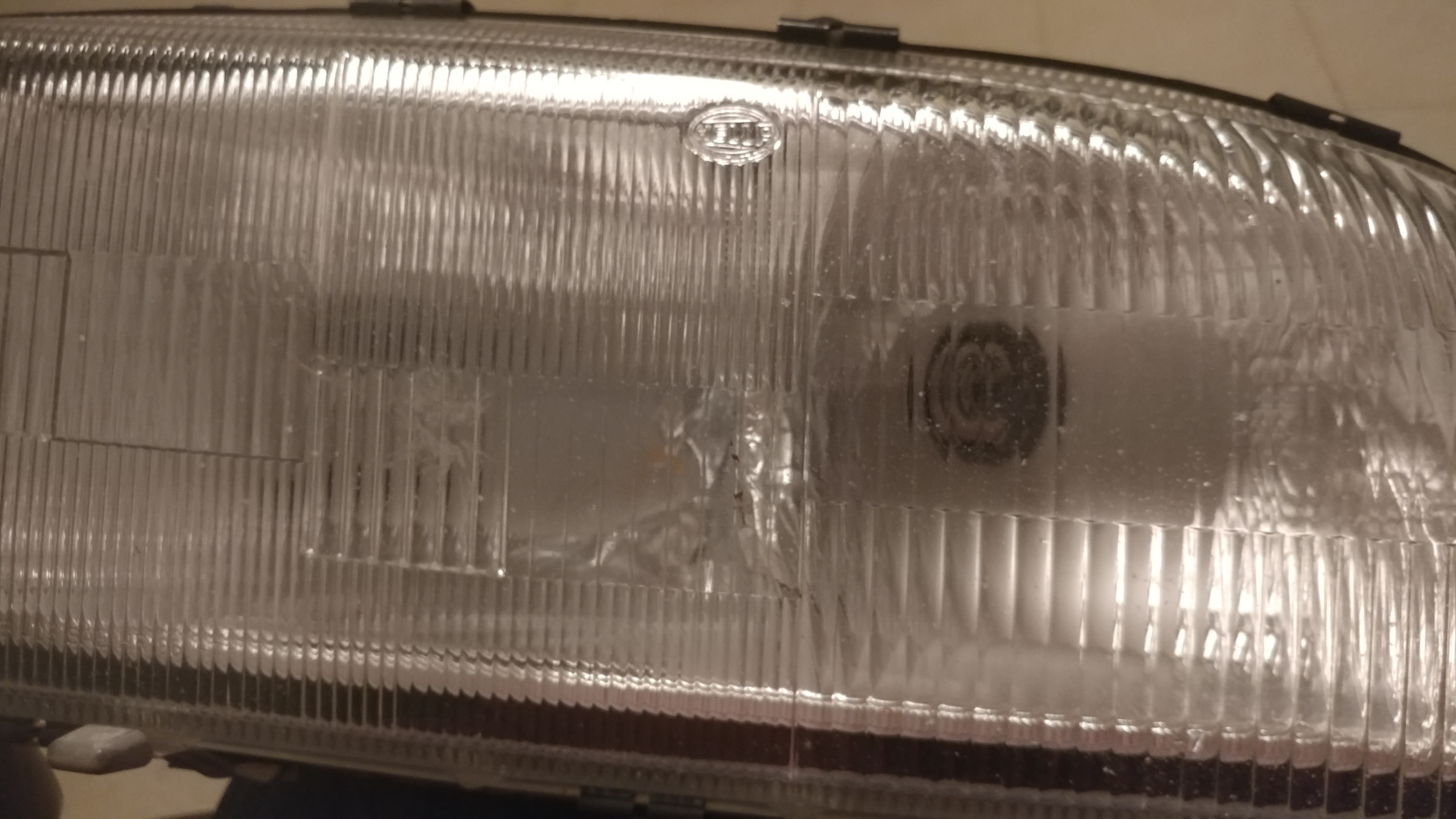

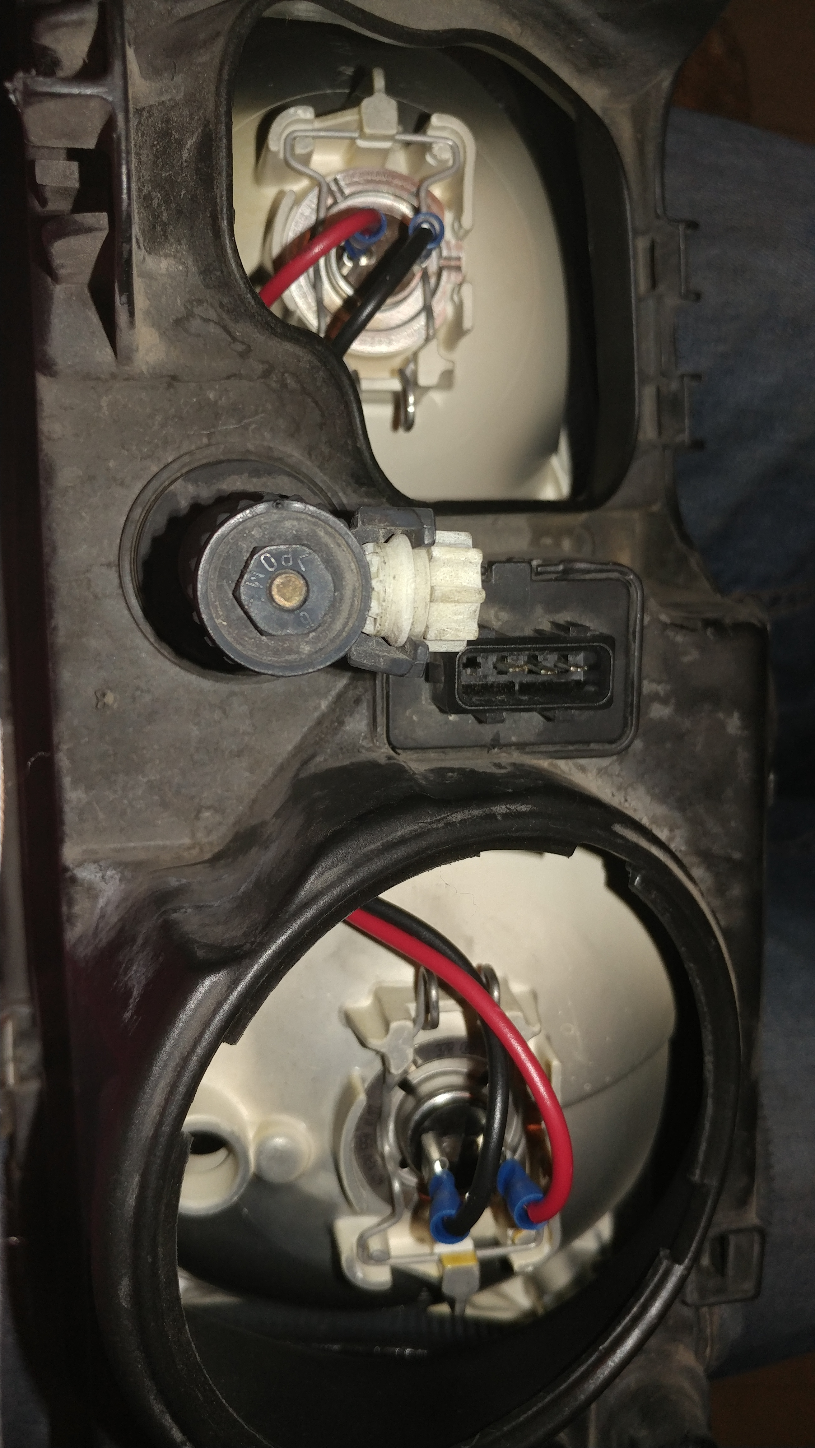

SOLUTION FOUND: thank you WhatAmIDoing for the advice. I didn't make it to research part of angling the lights, found how to do it by accident by fiddling with my own light. I did not get before and after pics. Sorry.
1. I locked the angle down
2. I added aluminum foil for reflection
These solved the issue, now I can see.
3. As an extra way to feel that I did something, I rewired the light harness with fresh wiring and connectors.
Now to do the driver side.

You mean you adjusted the direction of the light, whether up and down or left and right?
What did you use to hold down the aluminum? It looks like a partial rather than covering the entire reflector?
- CIK7
- Posts: 1702
- Joined: 14 Jan 2019, 08:15
- Year and Model: 2026 Sportrailer GLT
- Location: Antlers, Oklahoma
- Has thanked: 350 times
- Been thanked: 108 times
1. I saw 2 plastic ball joints that pivot and slide within a bracket that extends to the rear of the reflector unit. The reflector unit angles side to side SLIGHTLY. But it angles up and and down about half an inch. Look at a v70 headlight you'll see 2 gears interconnected. THAT controls one of the angle brackets. Then there is a plastic finger that slides into a rubber boot. These all seem to hold and control the light angle. Mine locked into place when I moved them.MoVolvos wrote: 26 Oct 2019, 22:39You mean you adjusted the direction of the light, whether up and down or left and right?
2. I did think about the heat when I used tape on the aluminum foil. Also the passenger side unit is the one I did first. I did a full foil wrap on the low beam socket, only the top and side on the high beam. For the driver side unit, I did a full foil wrap for both sockets. Im sorry I didn't take a pic before I put the glass back on.
