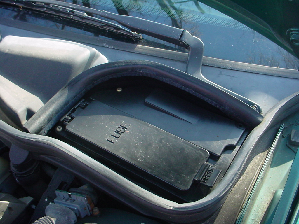

Once the fuel pump relay has been diagnosed as the problem with the car it must first be removed from the upper electrical center. On North American cars it located under the fuse panel cover, under the hood, on the drivers side of the car. Access to the relay is achieved by removing the four T-25 torx head screws and lifting the cover panel off of the electrical center.
Upper electrical center.
Upper electrical center with the panel removed.
The fuel pump relay is relay 103. I have trouble getting my fingers around the pump relay to extract without first removing the 101/102 relay combo.

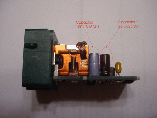

Once the cap is removed a small printed circuit board and the relay itself is revealed. Check for any obvious signs of bad things such as burned components, pitted or burned contacts on the relay, or loose solder joints. Assuming you find no obvious signs of damage the repair from here is to identify the two electrolytic capacitors. On my relay (898769000) the two capacitors were 100 µF and 22 µF respectively. The 898797000 relay may have different value capacitors.
The suspect electrolytic capacitors.

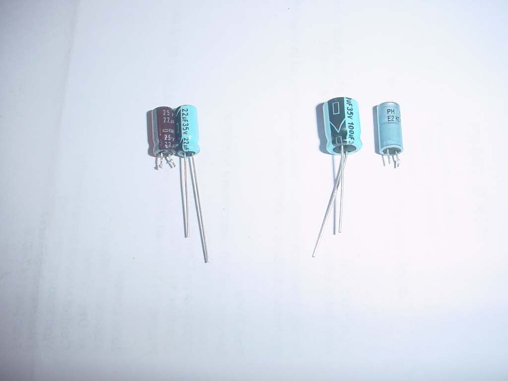

Although not exact replacements I was able to locate suitable replacements at Radio Shack, exact replacements can be procured from either on line parts houses or a good electronics supply house. The Radio shack replacements carry the part numbers 272-1028 for the 100 µF and 272-1026 for the 22 µF. The Radio Shack replacements are both rated at 35 Volts which exceeds the voltage rating of the originals. The 22 µF replacement is exactly the same size as the original but the 100 µF Radio Shack replacement is slightly shorter and it has a slightly larger diameter than the original.
Size Comparison between the original and replacement capacitors.
Electrolytic capacitors, almost always, are polarized so be sure to note the polarity of the capacitors before removing them. My relay had the negative side of the capacitor oriented to the top of the PC Board and the positive side oriented to the base side of the relay.

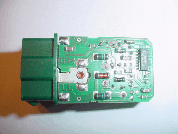

Removing the capacitors requires unsoldering four solder joints on the bottom of the PC board as shown in red circles below.
Capacitor solder joints.
There are a couple of acceptable methods for unsoldering the joints. One method is to use a solder wick and the other is to use a solder sucker. I used a wick and still had difficulty getting the old capacitors out since the PC board is double sided and has the solder connection on both the top and the bottom. A solder sucker might actually be preferable. Get the joint good and hot but not so hot that the PC board gets damaged.
