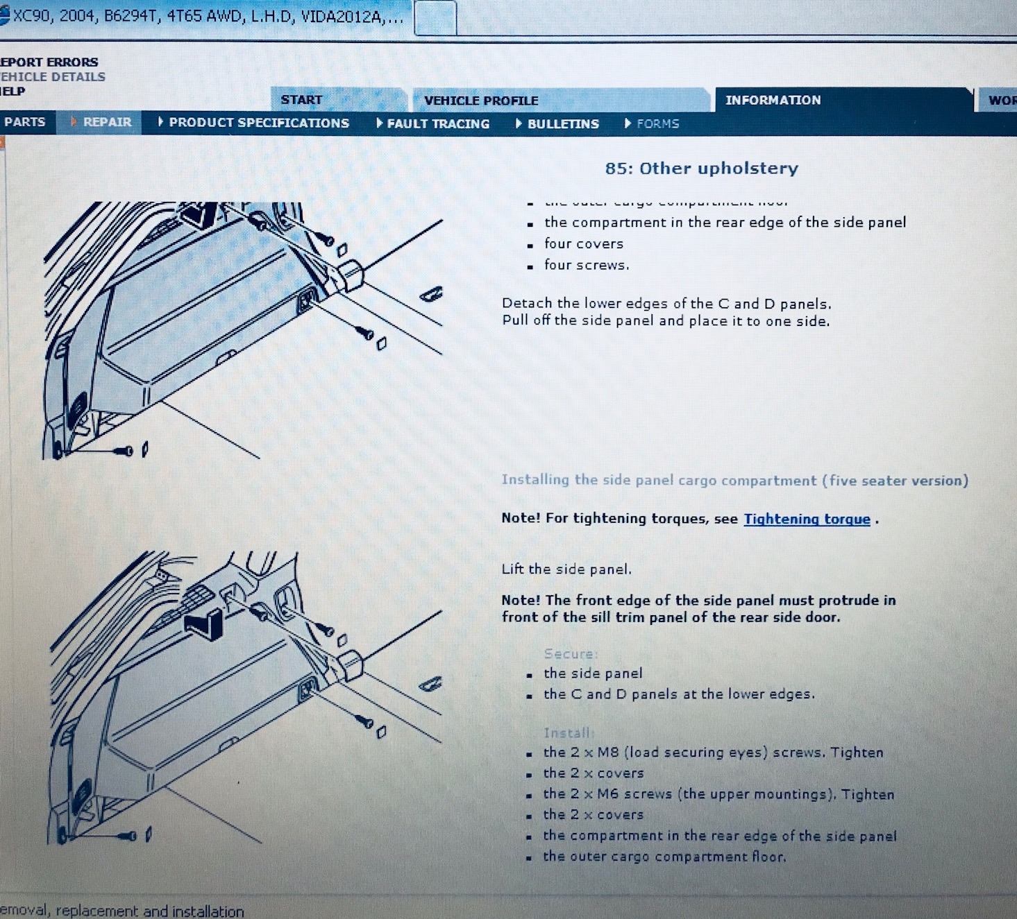

I pulled up the instructions in VIDA. What you have to do is basically the same for 5 seater vs 7 seater. Variables are whether you have rear A/C. Basically a few extra wires to disconnect. In VIDA it is found under "85: Other upholstery".
To remove the rear panel you have to remove the various floor pieces that are in the way and then for the panel itself 4 screw caps and the four screws. Then clear the C and D pillar while removing, noting how they have to tuck in relative to one another. You can remove the panels if you want. Winging it - just locate the four screw caps and remove them and the corresponding screws. Then wrestle the panel out. If you have a cargo department, open it up look down and pull the plastic clip (looks like a plastic pin in the middle of the clip) as that is a connection point.
Otherwise you can try the crow bar technique in the linked videos.
So to answer your question, if you want straight access, you have to pull that panel, which does not seem that bad, just don't break any clips.

Post by Lubectrava »
Thanks for the interesting videos. The clip for the wiring harness does not require removal of the fuse/relay module and the clip actually replacing the relay is insane! I would prefer not using a crow bar to diatort the plastic panel. Imagine that crow bar slipping and destroying your REM! Yikes! Plus my hands are too large for that technique anyway. There’s got to be a way to either remove the large plastic panel or unclipping and sliding out the relay module. I’ve mucked around with the panel and could not find the 4 caps and screws you are referring to. Don’t currently have access to VIDA :0((
Does this help?
