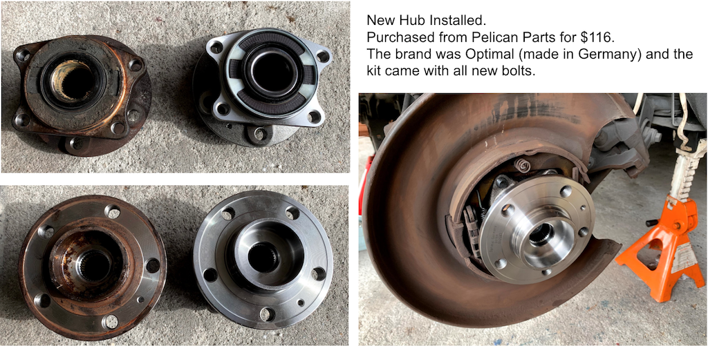

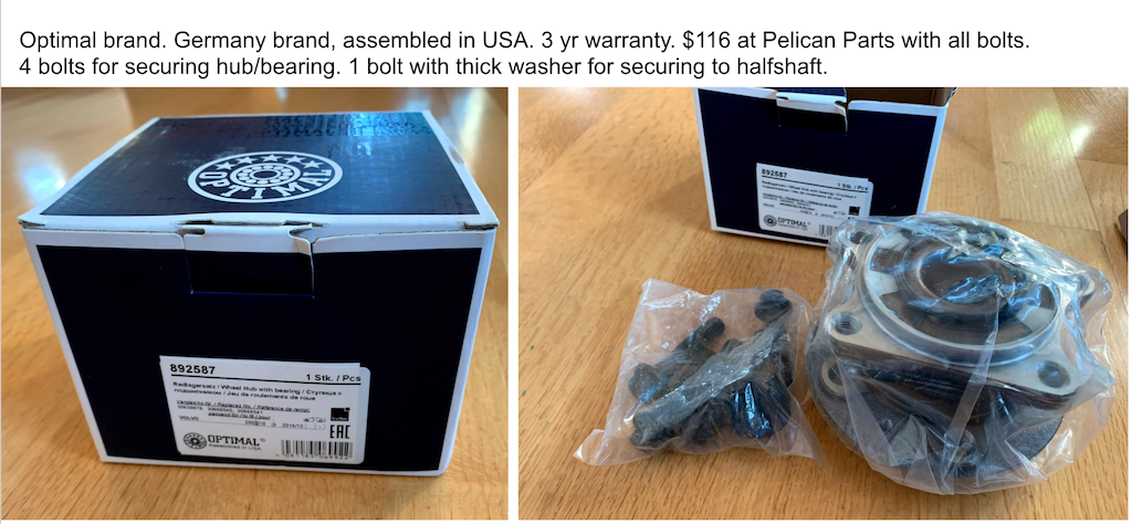

New Part
After much searching, I decided to try a brand called Optimal. It was $116 with all bolts and has a 3 year warranty.
The OEM Volvo (or SKF) bearings were about $160-250 and the bolts were extra at $4 each!

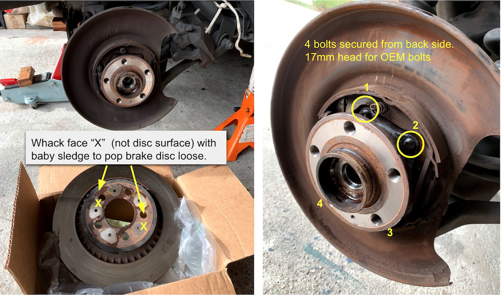

You'll need to remove the 10mm bolt that secures the brake disc and then the two 13mm bolts that hold the disc brake caliper in place. Tie the caliper up so that it's out of the way and there's no strain on the brakelines. Then give the brake disc center hub a few whacks with a baby sledgehammer and it'll pop loose. I hit it right where those yellow "X" marks are and it came right off (left picture).

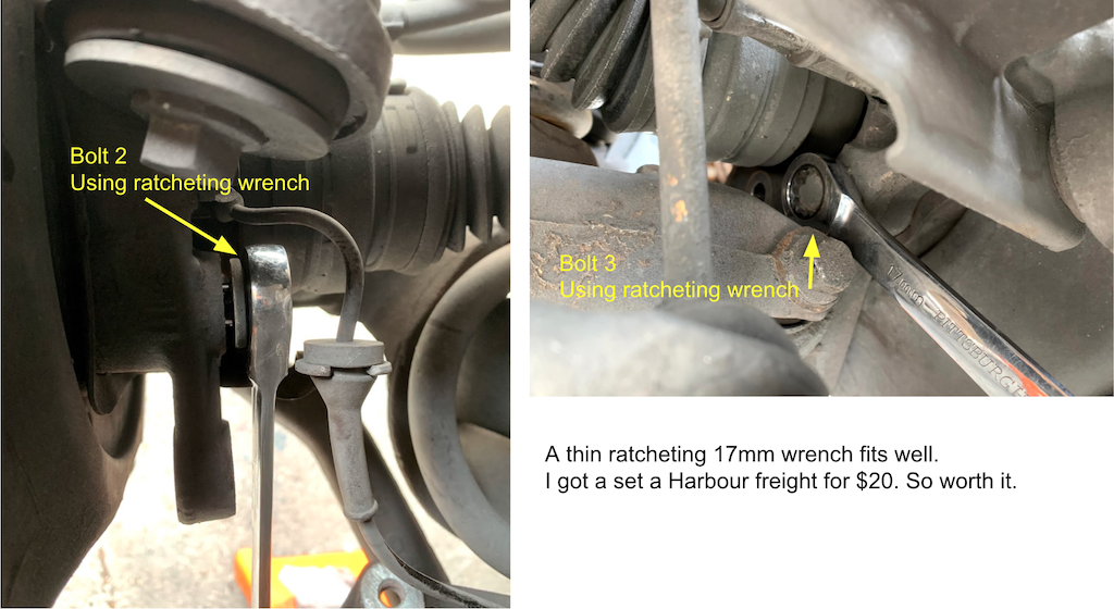

Then you'll need to get the 4 bolts with 17mm heads that are holding the hub in place. They are accesses from behind
Here are a few pictures of how I removed the 4 bolts holding the hub/bearing in place. The ratcheting 17mm wrench was key and made quick work of bolts 2 & 3. The others I had to use a socket. The are not hard to get to and if they are tight, a few whacks with a rubber mallet does the trick.
Bolts 1 & 4 were accessed using a socket wrench. Here's a picture (right) with the bolt locations very clear since the hub is off. As you can see, the hub shape will ensure that it only fits in one way.
Securing new Hub
Not much to say here. Just bolt it back in with a bit of threadlock for good measure.
I did notice that the bolts included with my hub kit had 15mm heads instead of 17mm. The bolts themselves were of the same diameter and they fit fine. However, since you are not supposed to reuse the old bolts, I just installed the new ones that came with the kit.
So that's it. At this point, buttoning it back up is pretty straightforward.
I took the car for a drive and it's back to smooth and quiet again. This whole job took me about 1.5 hours as I was going slow and methodically taking pictures. Also, my car being in California, didn't have much gunk or rust at all. Nothing was stuck or otherwise overly difficult to remove. It was an easy job and definitely not worth giving the independent repair shop $650!
