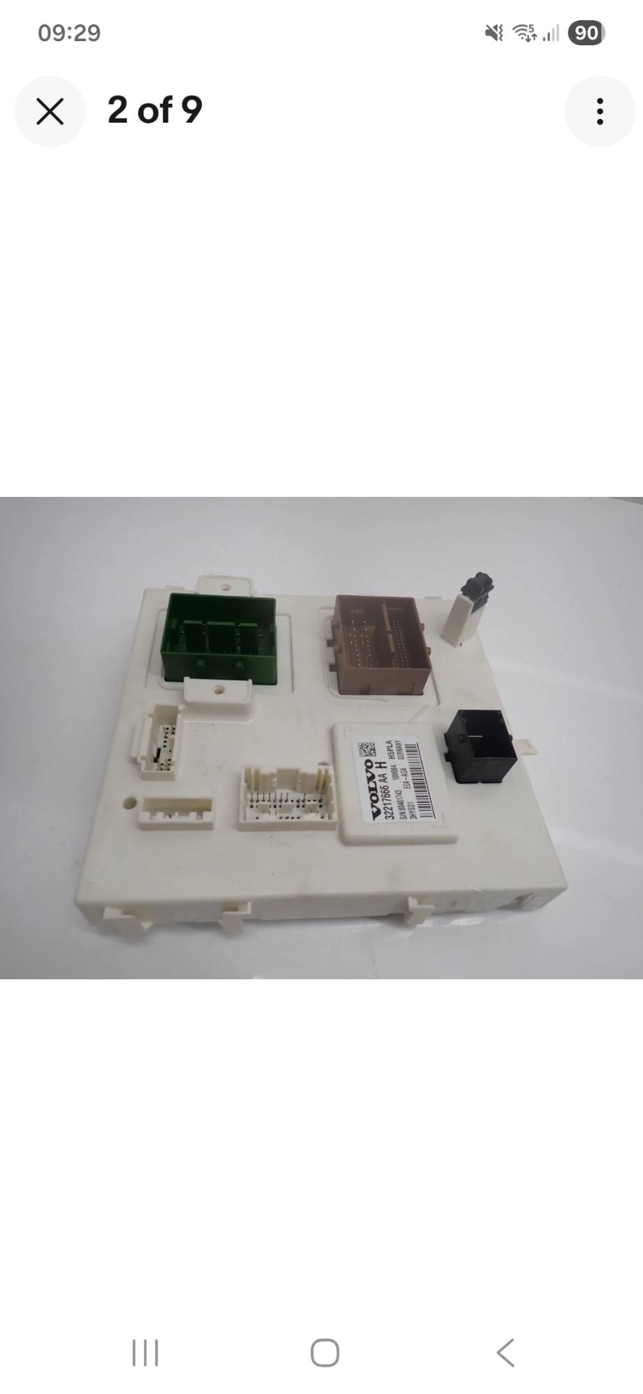

Has the CEM cracker been tried on the later delphi CEM's?
Like these one's?
vtl

oscilloscope wrote: 14 Feb 2026, 02:31 Has the CEM cracker been tried on the later delphi CEM's?
Like these one's?
Is it SPA?

vtl wrote: 14 Feb 2026, 08:35
Like these one's?
Is it SPA?
It might be yes , i tallied up the type and compared it to xprogs connnections via bdm, now at first , I saw a locksmith wiring up a xhorse programmer to the BDM connections, and i wondered if the cem cracker has been tried out on them newer cems.🤔
