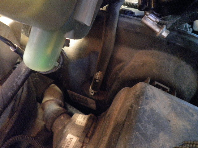

Well I made it this far but for the life of me can't figure out how to get the timing belt cover off. Even with it off I'm not sure I can get to the Tstat behind the belt.
tstat 004.JPG (84.96 KiB) Viewed 10969 times

Am I correct in thinking you couldn't download the attachment?
I have just done it three times to check and it is OK.
You need a weatherstrip tool to get the timing cover off. You can either buy one or make it yourself from strong plastic strip.
