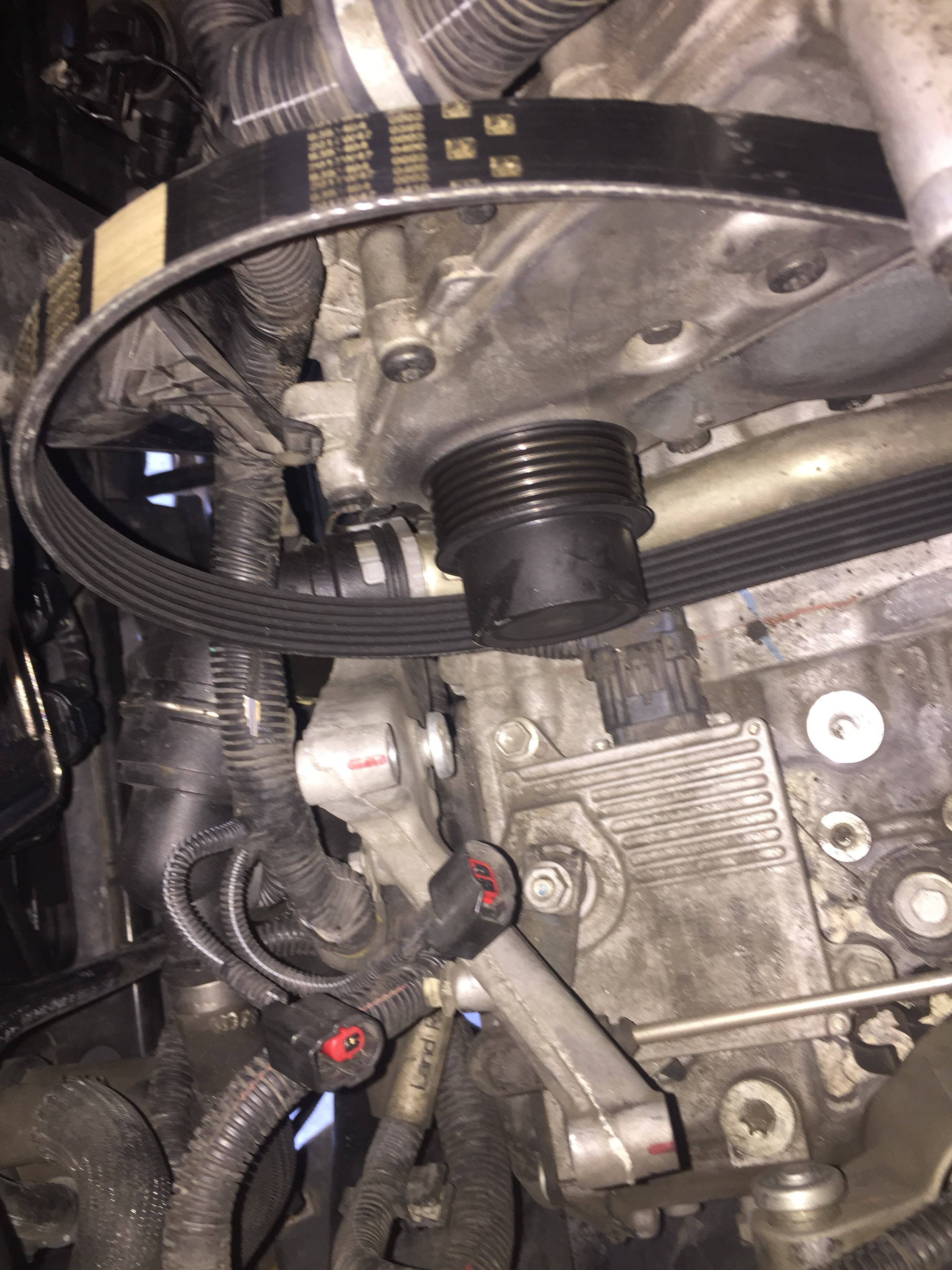

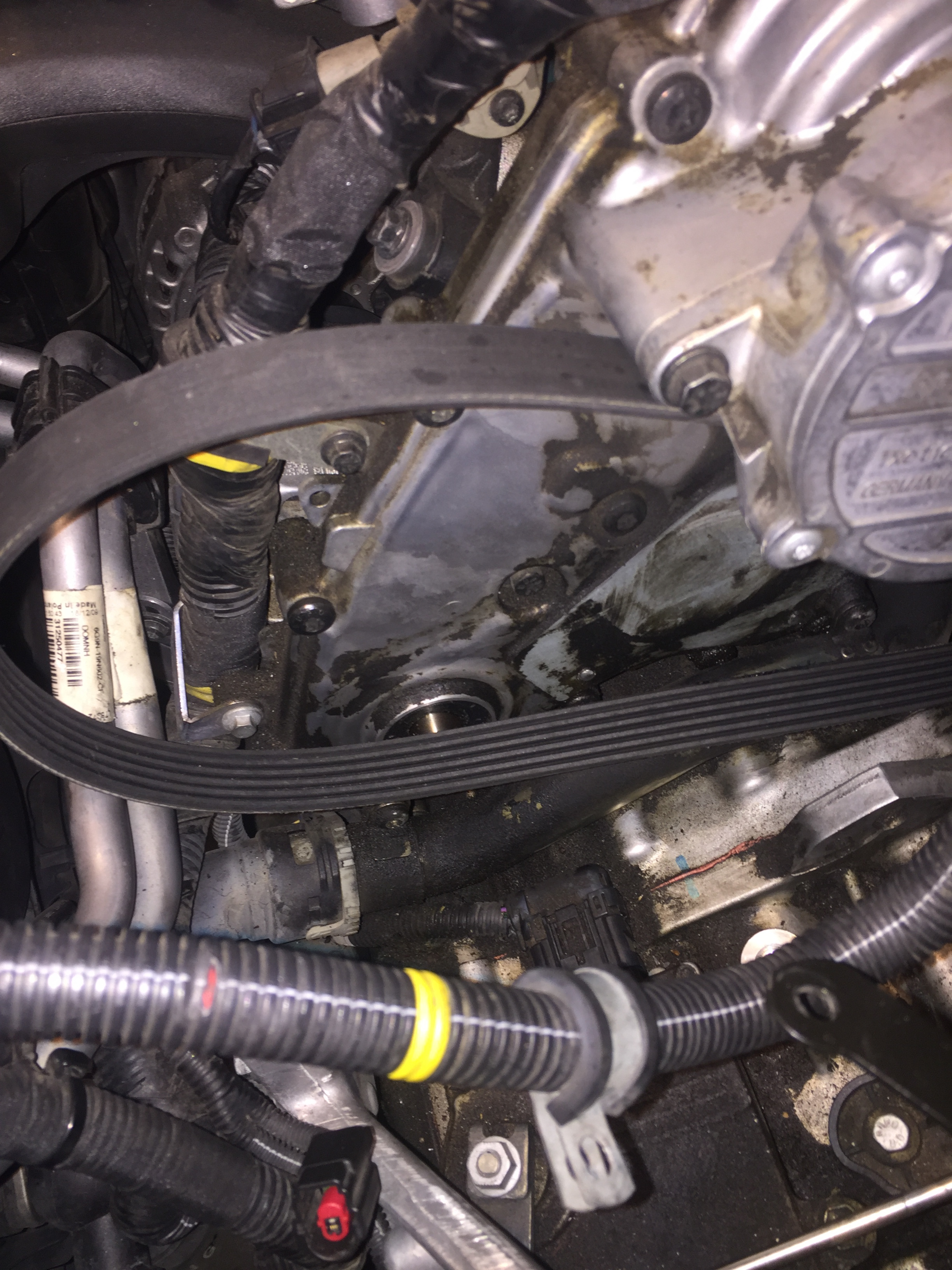

The 2013A XC90 profile in VIDA shows Service Schedule II for 150,000 miles. After engine cooling, and steering service, I was preparing on replacing the belt, pulley, and tensioner, but found the task intertwined with many other components. Here are the items in my checklist:

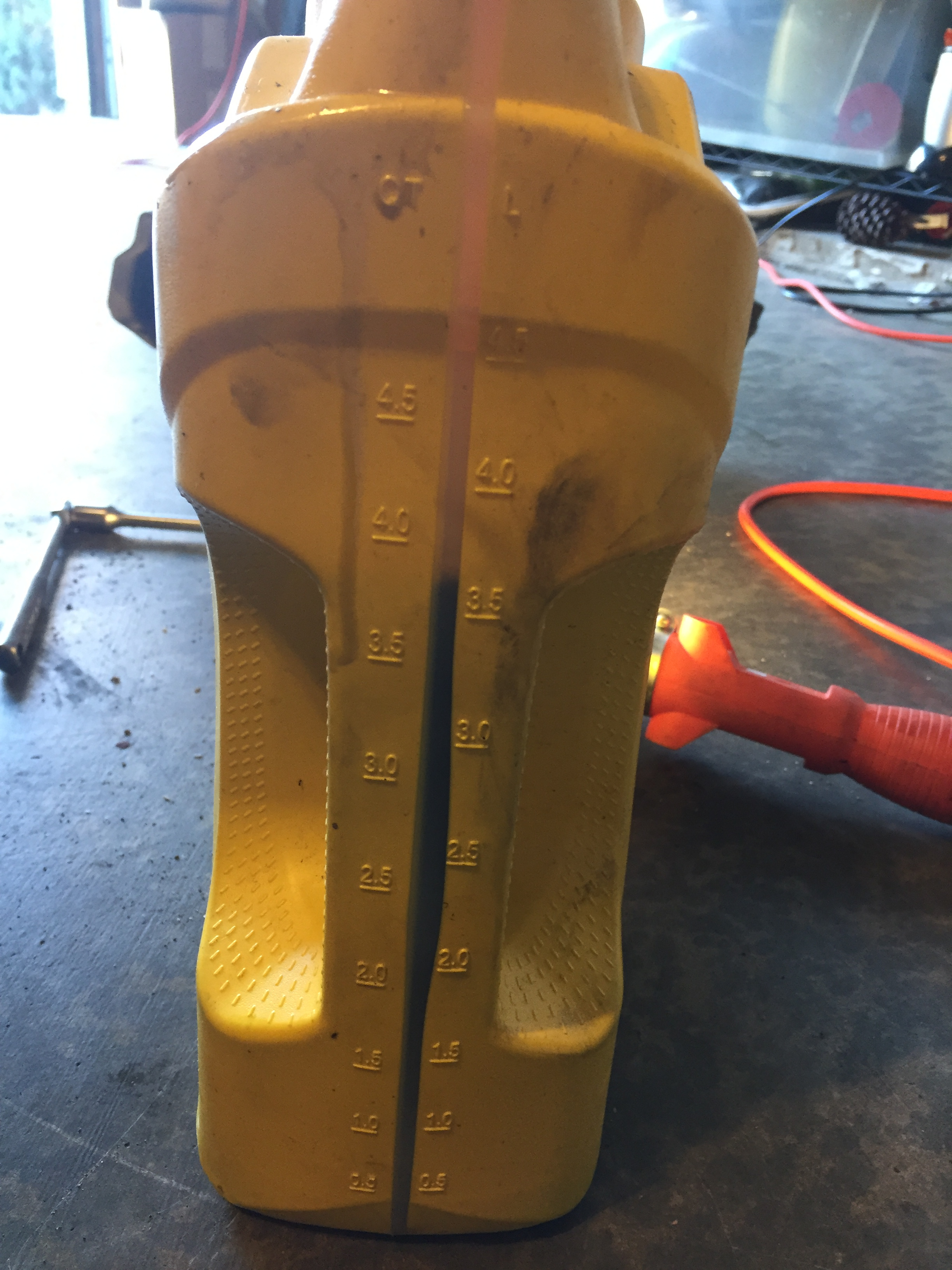

The transmission fluid change was like an oil change -- simple D&F. I used Volvo's PN31256775, it is a gallon jug. Removing air box takes disconnecting electrical connectors. Vida says to disconnect battery terminal. Here are few observations and questions:
Why would any fluid drain at the 40T Level Plug if it was at LEVEL to begin with?
It drained close to 3-qt in total (40T + 17mm). Refill was a full gallon, but after warm up to 53ºC it only drained little more than 300ml from the 40T Level Plug before slowing to drips. It means, It held close to 700ml more than it drained originally.

Based on your description it appears that your transmission was under filled.
The level of fluid in the sump is measured with the engine at idle.
If you remove the Torx 40 with the engine off then you will remove another half a quart of fluid and the fluid level will be too low.
Here is how much I removed
Its about 3.6 liters
You added 3.8 L and removed 0.3L
I think you are fine
Note: I done this on both of my vehicles with the AISIN transmission and the I am only able to remove about 3.6L using the drain and fill method.

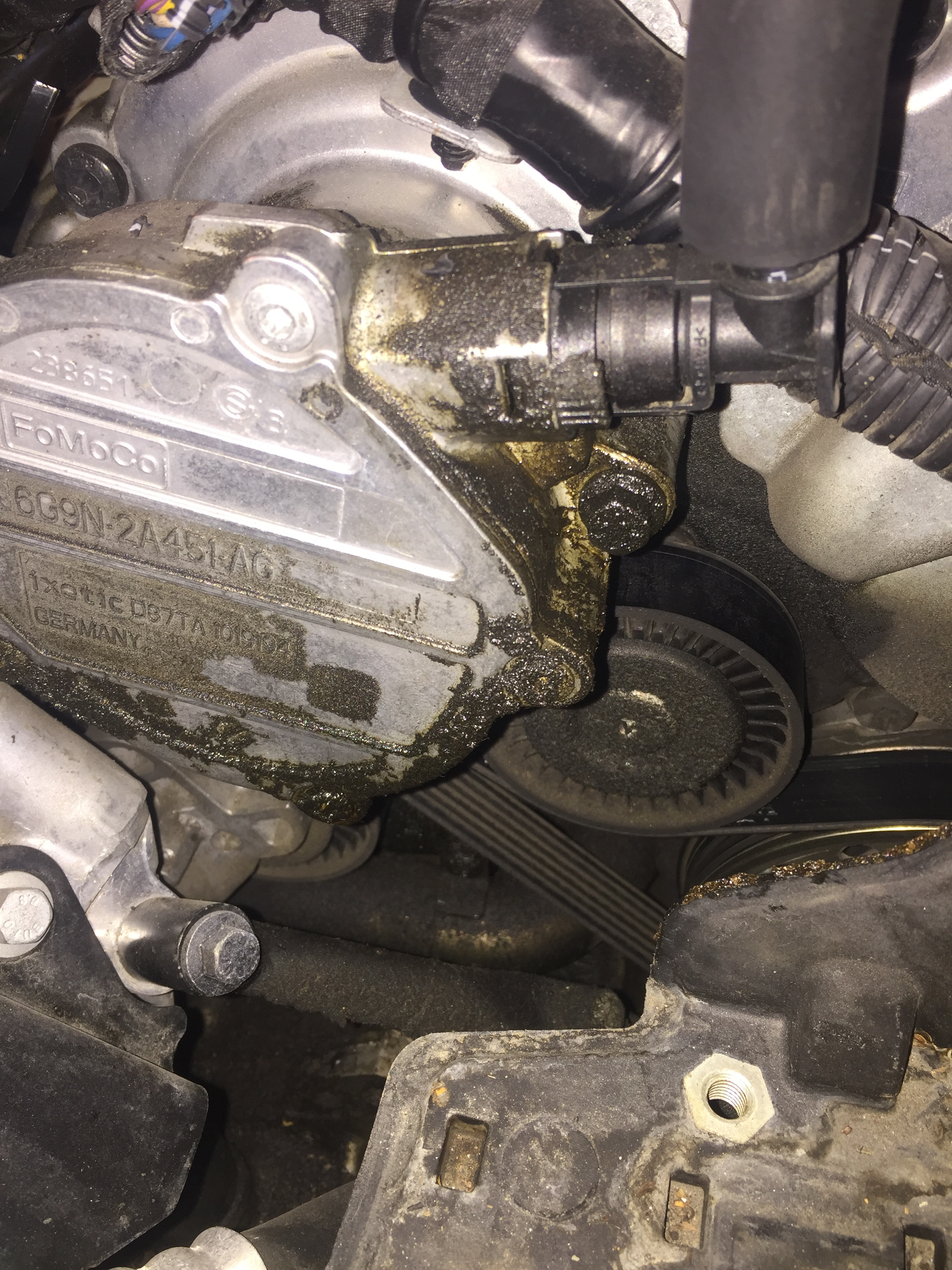

Vacuum pump is out on the bench for service using Vacuum Repair kit PN31401556.

That looks super clean.
Note: for my LR2 I didn't rebuild the o-rings in the Vacuum pump because it was very clean.
