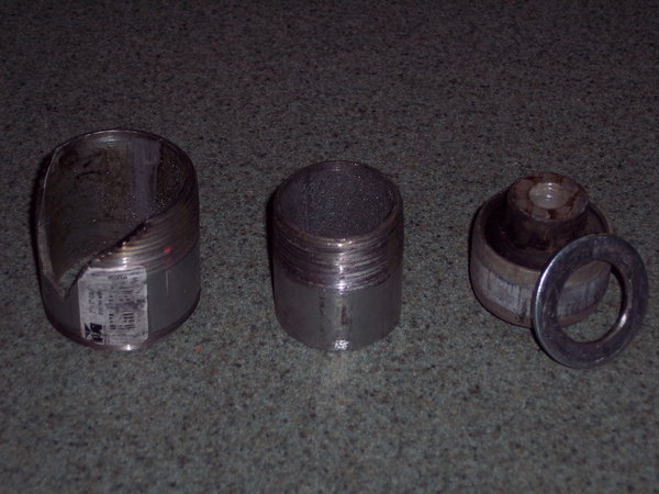

I just finished replacing the control arm bushings on my 2001 s80. I was a little intimidated to start the task, but the posts on MVS helped greatly.
I was able to press the bushings out and in using a small frame and a 6 ton hydraulic jack. I wish I had taken pictures to post. The front bushings are the only real challenge. I had to create 3 custom tools using 1 piece of 2" pipe, 1 piece of 1-1/2" pipe (threaded), and 1 flat washer. The 2" pipe is to give a platform to support the control arm when pressing the front bushing out and in. I had to remove a 'corner' of the pipe to fit tight to the control arm. To remove the front bushing, rest the control arm on the 2" pipe and set the 1-1/2" pipe (threaded end) on the outer part of the front bushing. It only goes into the bushing housing about 3/4", but that was enough to break it loose. On the rear bushing, I used a flat washer whith an OD of 2", just the right size to press the 2-1/16" rear bushing. Only catch was... I had to make the inner hole bigger so that it would slide down to the bushing sleeve. (about an hour with a dremmel tool for me) Then I put a 1-1/4" impact socket on the washer to press the rear bushing out. I first took the control arm and bushings to 2 shops to have the work done, but after talking with 2 different people and watching them try to figure it out, I frankly had more confidence in myself. I was almost surprised that it worked, but I am happy that I didn't pay $50 for a shop do do it for me.
Only trick is to start the front bushing in the right orientation so the mounting holes are perpendicular to the rear bushing thru-hole.
