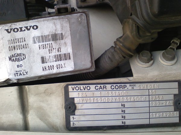

Yesterday I pulled my throttle body to clean the throat and valve. Once I got it out I noticed a huge gouge in the corner.
Take a look at the pictures I attached.
Because of the way it mounts to the manifold, I could not figure out how in the world it could have been damaged like that. Seems like it would definitely have to be removed, rather than a rock or some other projectile hitting it while driving. The pictures may not show enough detail of the hole, but it would have taken quite a lot of force to mess it up the way it is.

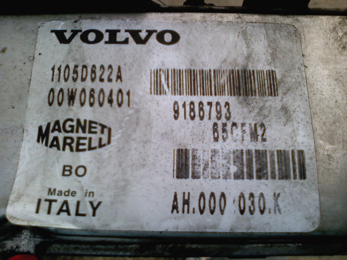

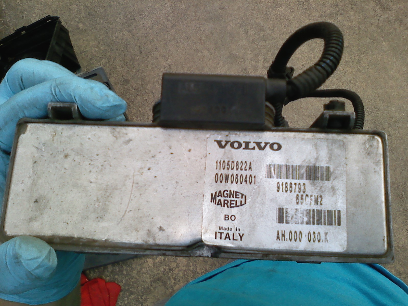

UPDATE!!!
I just found out that the throttle body on my car is for a 1999 model.
I spent 6 or 7 hours yesterday pulling it again to install a throttle body gasket. This time I noticed that the reason why it is damaged like that is so it will mount to the air intake manifold properly. The ’99 manifold and ’00 manifold are different. At some point a “genius” replaced the original ETM with an older one.

Well,
you could pull one out of a 2000. But that would not help at all. It doesn't matter what year it is from, each ETM is synced to the car. You would need programming for any ETM you use. My suggestion is to order one from xemodex.com and send that one that's in the car back to them as a core.
