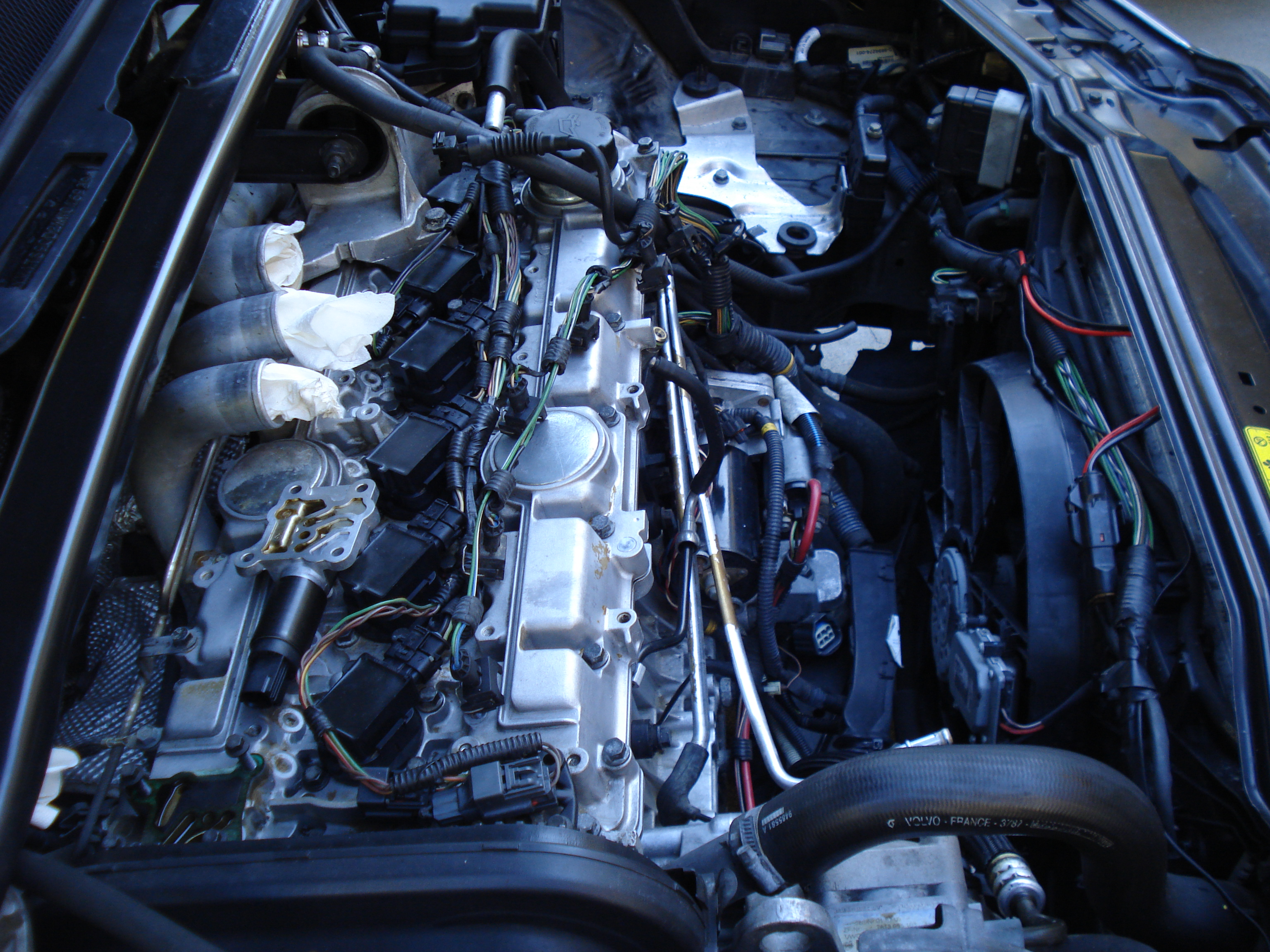

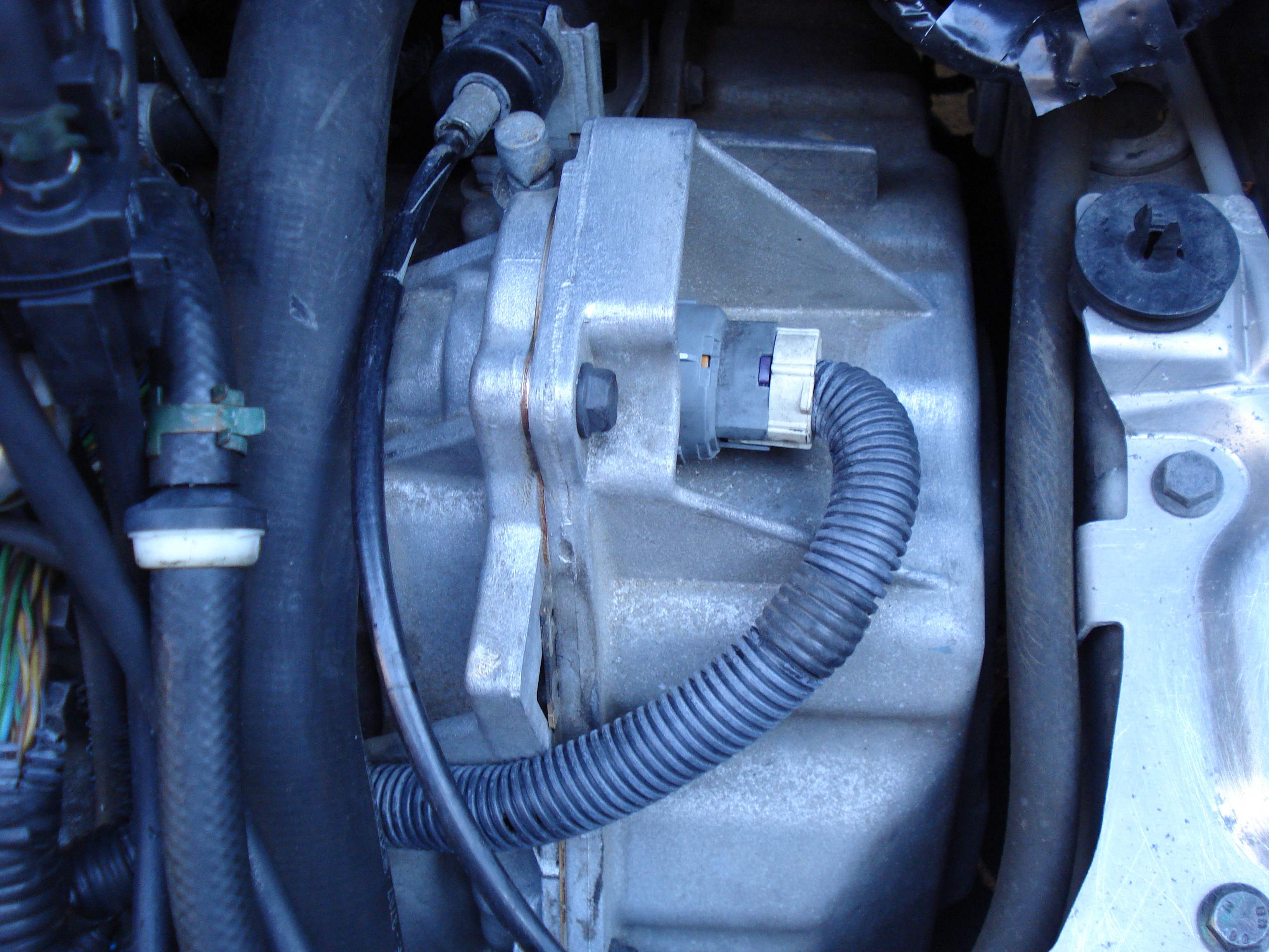

OK, so i purchased this awesome 2000 T6, with 70K on it, i knew i had to go to work, because im just sick like that lol..
parts i wanted reaplced and ordered from http://www.autopartswherehouse.com
new Elrig intake gassket
new VVTi gasket
new oil trap
of ocurse found many servicable/replaceable parts along the way. i will post pix as well.
STAGE 1 S80 T6 MAKE OVER
a few more pix for you volvo lovers, the sun is going down , so i will try to post some more pix tomorrow. happy NEW YEAR , stay safe.

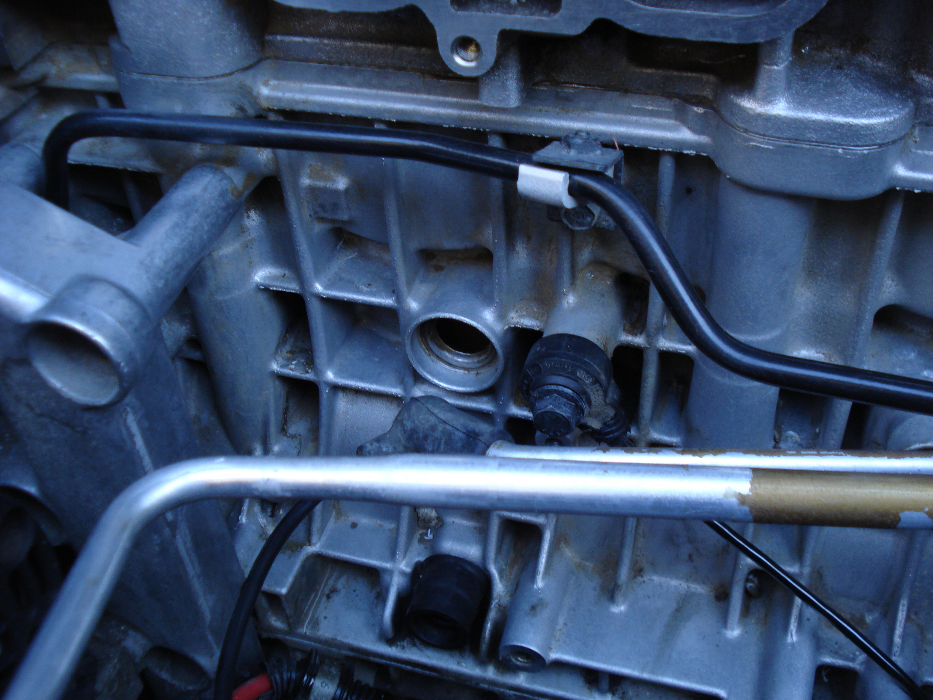

I can see that you've left the coupling on the block for the PCV box. This is where much of the crud in the block accumulates so be sure to remove the short hose and scrape out the port where the lower PCV port connects. If you can get a bottle cleaner in there and get it to go 90 deg this will do the trick. You may need to change the oil because some of the crud will drop into it.
Hello, yes i did remove the lower coupling hose, and cleaned it out, i forgot to include a pic
, i do need to find a vacuum hose routing digram, for the hoses i replaced.... i should have marked them... ill figure it out.. oh and yes im removing the oil pan and going to comepletely clean it and steam wash it in a few days, then to the 4T65E removal.. going for an overhaul... cheers!
