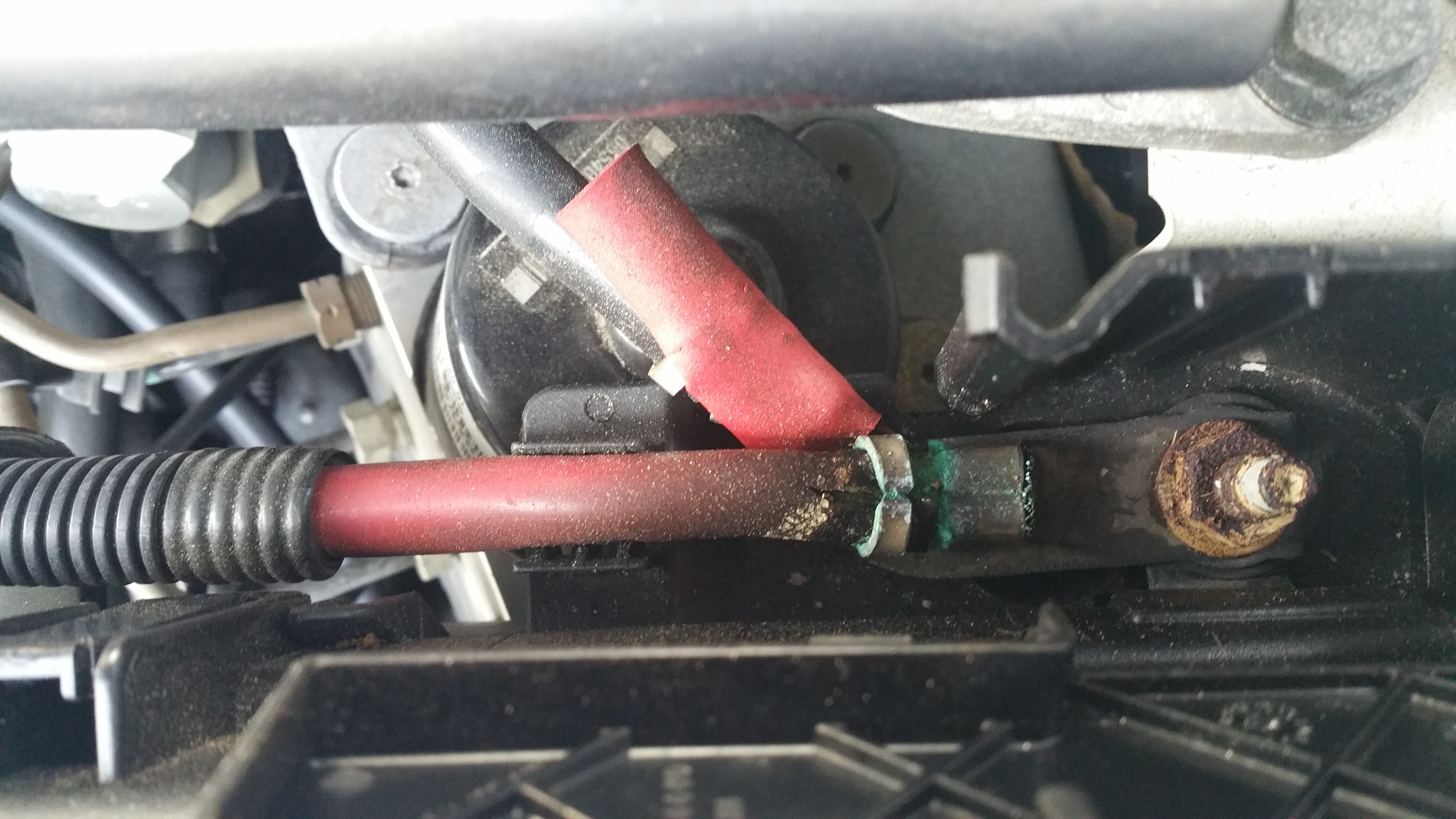

Get second opinion at a Volvo dealer. Sounds like you're guy is guessing. I believe these cars require VIDA to program things anyway. My 2004 S80 T6 died right in the dealership service drive. Loss of power momentarily then would not start and it was the positive battery cable connection under the hood was loose and the wire to the starter and fuse board beneath it fried and had to be replaced. I understand if battery power is disconnected improperly it can cause issues that have to be reset. My dealer fixed it so what resetting was done i don't know. You'll go broke throwing parts at one of these guessing what is wrong. You need the dealer or someone with VITA and DICE connector to properly diagnose the computer systems. June

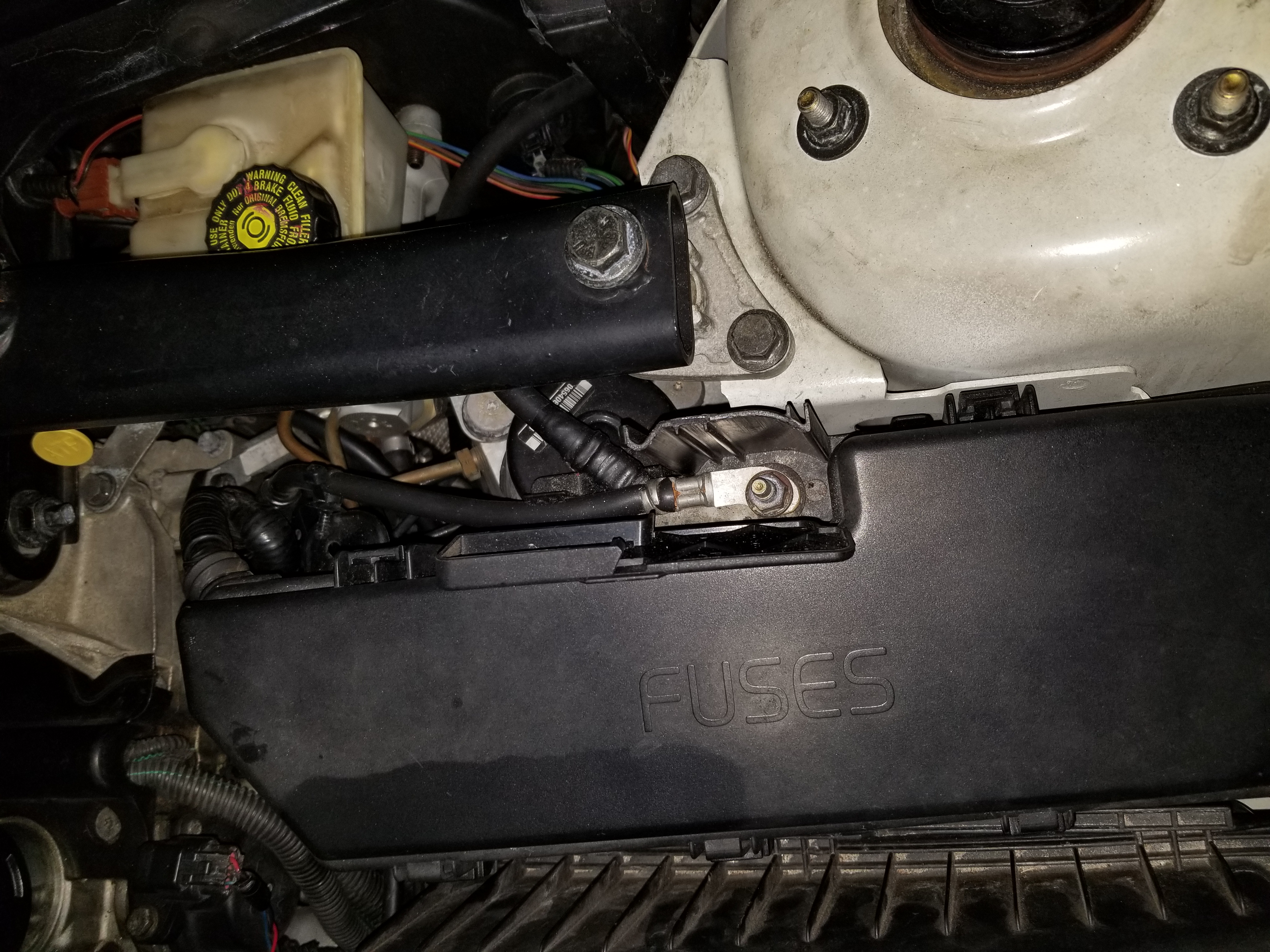

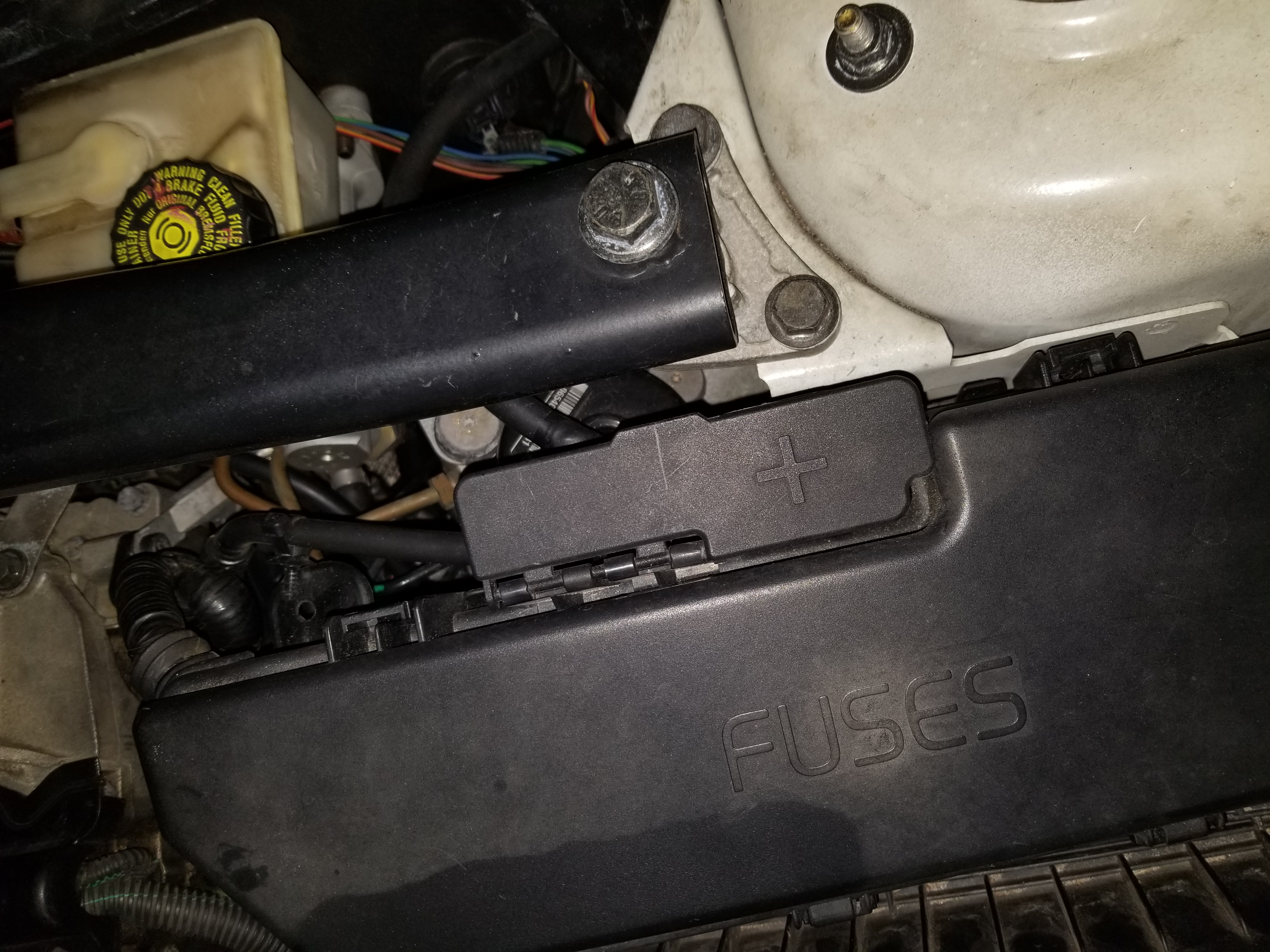

Found a picture of the problem my car had a couple years ago top two are tonight. My mechanic said it is not uncommon as these cars age. This is under the hood and black plastic cover and is where the main cable from the battery in the trunk connects to the starter and fuse pannel. It is worth checking. June

Just momentarily lost power long enough to kill engine and all power, really just a split second then power back but wouldnot start. My car loves me as she chose to do this pulling in the service drive which is a half circular shape so I kinda was turning left at that moment. They called my mechanic up to the drive who knew immediately what happened as he opened the hood and flipped up the cap then closed the hood and the car had to be pushed into the shop. He said this was a rather common problem and surprisingly Volvo sells just the bottom of the fuse pannel. My mechanic has worked at my dealer going on 30 years and seems to always know just what to fix. Apparently it is easy to piss the computer off... Junenicole0725 wrote: 28 Nov 2018, 16:27 Thanks so much for your response! Unfortunately the closest Volvo dealer to me would be a pretty expensive tow. I will ask him tomorrow about vida and dice, if he doesn't have the correct stuff I think I know someone who does. I had great voltage coming from battery and all my lights and what not worked. Did you permenantly lose power? Or just briefly, I lost power for literally half a second when it stalled.
