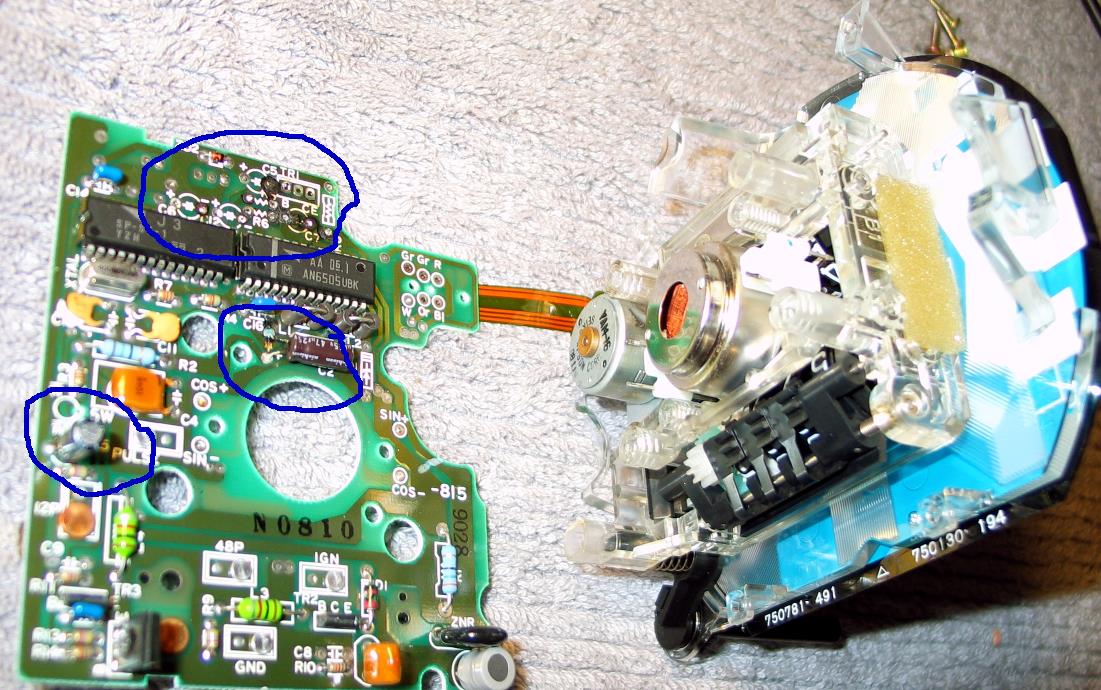

My moneys on the speedo its self.
My father has a 91 940, and I've repaired the speedo.
It had leaking electrolytic capacitors.
If you can solder it's not to hard a job, just time consuming to do right.
Pic shows what I'm talking about.
If you want more info etc, lemme know and I'll help out as best I can..
EDIT, had the same faults, speedo would read anything upto 80klms/hour while at traffic lights.
And anything from 0-100 while driving.....
- Speedo Dissassembled.jpg (172.56 KiB) Viewed 6524 times

Been elsewhere for a few days, like whale wathching down the beach. Waiting for a speedo cluster from E bay real cheap. I fixed a bad joint on the cap your talking about. The speedo runs all the time now but still has that silly offset voltage standing on it. The voltage does not show on the sensor input so it must be generated in the speedo. Sensor measures 1800 ohms on the money and puts out about 2.5 volts AC at 35 mph and about 4 volts at 70 mph. I guess its some kind of sawtooth voltage. Will be back to announce any cures.
