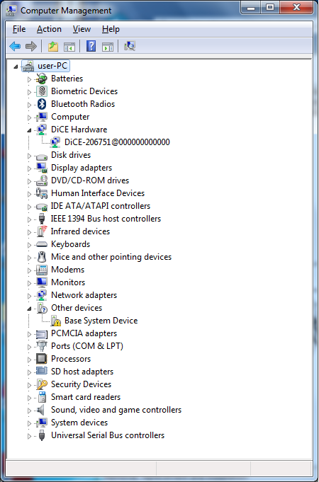

So without Vida even being opened on the computer, and with the dice device plugged into obd2 and the USB port... should the computer be able to recognize the dice unit?
I would think so... Am I wrong?
Thanks
Thanks
- RickHaleParker
- Posts: 7129
- Joined: 25 May 2015
- Location: Kansas
- Been thanked: 958 times
Yes and it will look like the first picture unless you got one of the oddballs that runs as a Com port as in the second picture.
The odd balls require a VIDA that is hacked to work with the odd balls.
Normal:
Odd ball.

Try looking in Device Manager, then go to Ports (COM&LPT) You will probably see USB Serial Device (COM 7) or plug in your DiCE and see if it appears by plugging it in and unplugging it and seeing if anything appears or disappears, and see if your computer is registering it, this is what happened with mine but I used chat gpt to help but when I plug my DiCE into my laptop the usb comstatus light is red meaning that the volvo DiCE is getting power but is not binding.
