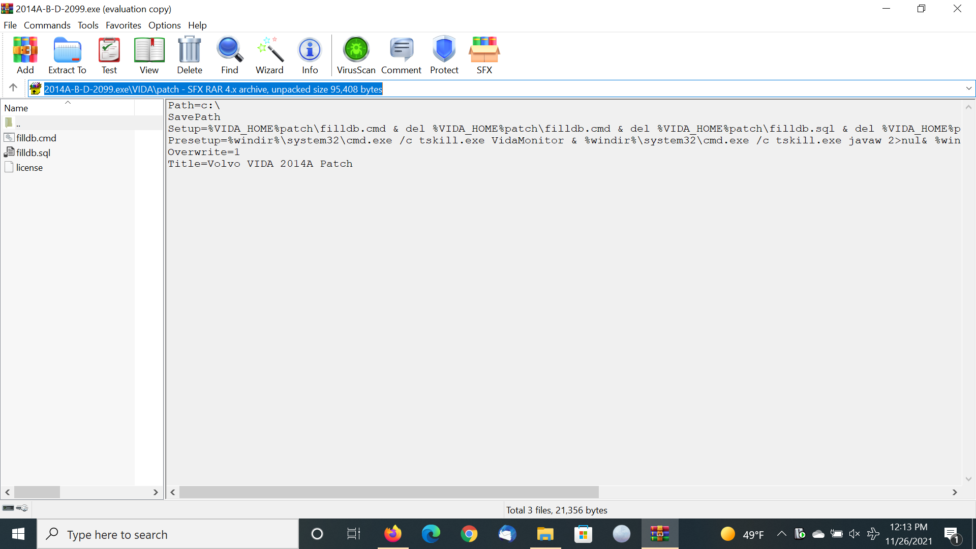

Having some difficulty getting VIDA installed on Windows 10 Home and am hoping you can point me in the right direction? I followed your instructions verbatim, but when I try to install the patch I get the following error message:
"Windows cannot find '%VIDA_HOME%patch\filldb.cmd'. Make sure you typed the name correctly, and then try again."
I did have an issue where my system tried preventing running scripts 1-3 so I granted the appropriate permissions, disabled the virus protection and then re-ran the scripts again.
Thanks in advance for any help you can provide!

GearBoy454 wrote: 25 Nov 2021, 06:11 "Windows cannot find '%VIDA_HOME%patch\filldb.cmd'. Make sure you typed the name correctly, and then try again."
The patch is a self executing WinRAR archive. %VIDA_HOME%patch\filldb.cmd'. referrers to a path within the archive. For some reason your system is having trouble with the archive. Bad sectors due to download errors can cause this. Delete the patch and try download it again.
