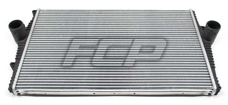

Stock mount replacement
Aftermarket intercoolers that replace the stock unit and mount in the same location do bring a great deal of simplicity to the addition of an intercooler. Since they fit in the stock location the install is typically straight forward and little to no modifications are necessary to make them fit. Some FMIC kits are 100% bolt up but many ‘ebay’ kits are not. Additionally since there is more area (width and height) in the stock mounting configuration this provides a thinner intercooler core which promotes better cooling at lower speeds. Of course being behind the condenser this can allow some heat from the A/C system to be transferred to the intercooler but in most cases this isn’t as big of a concern unless your climate has considerably higher ambient temperatures.
