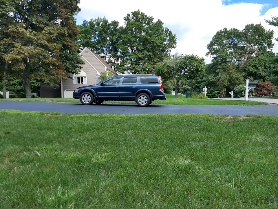

With the springs settled down in a few days:
In action:
I'm going to upgrade rubber from stock 215/65R16 to 235/70R16, lift should allow that.
Sway bars are XC90/front and V70R/rear. The car was also converted to Nivomats.

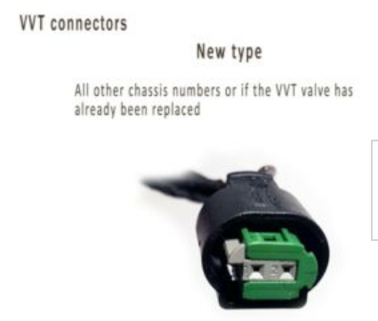

I have this type connector for VVT and I assume I can reuse it.
Also, I got this info from his ebay add: "Please check and inform the type of solenoid connector when ordering" so I guess he can attach correct connector?
