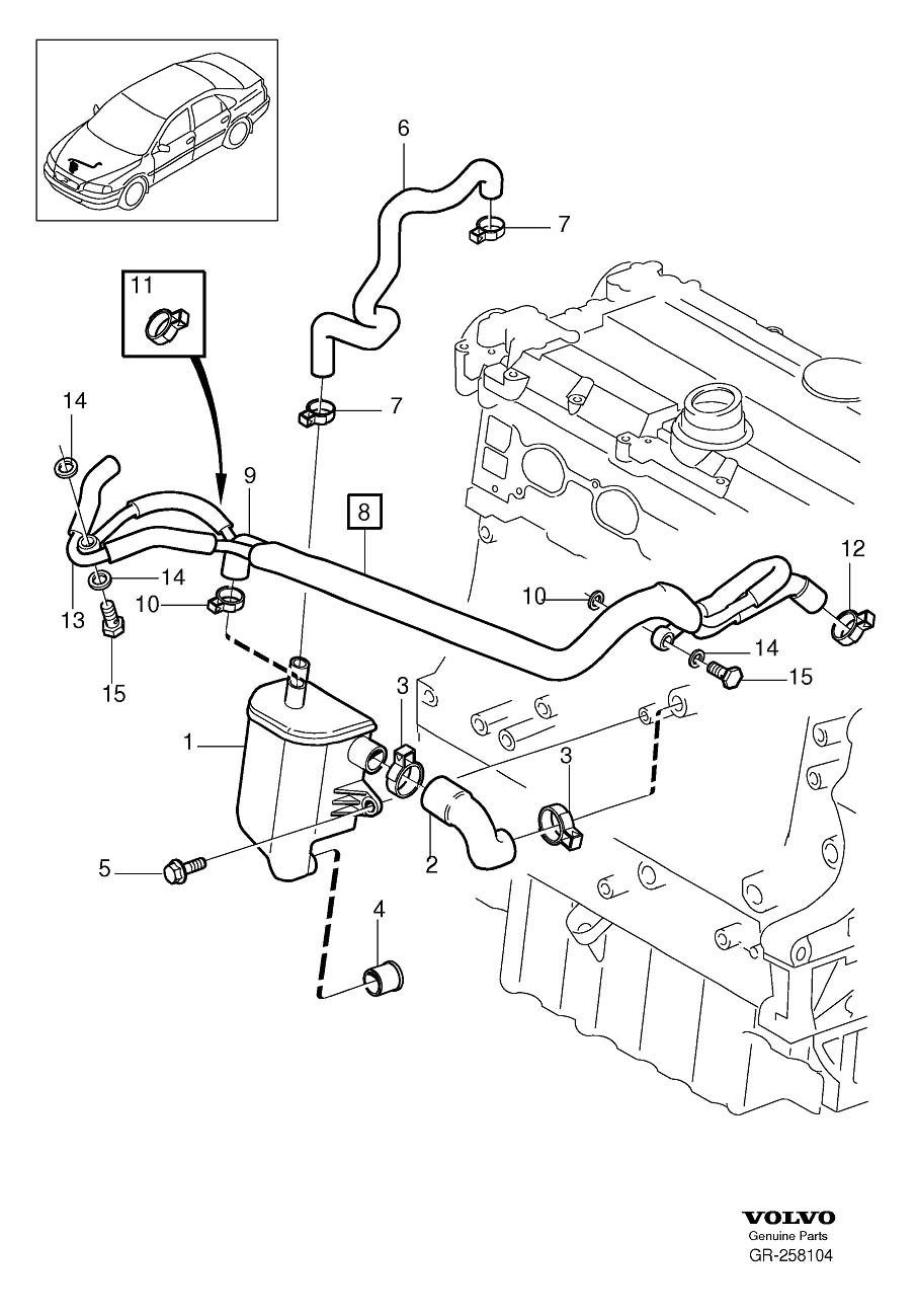

I made some simple blow tests (see below the diagram to identify the hoses by numers):
1. Inserted a suitable diameter plastic tube into the oil level check tube (oil stick removed). Blew air through the tube: I got massive resistance and the air came back from the tube (behaved like a party balloon) => the system is airtight (or clogged). Removed the oil filler cap and blew in air again: no resistance realised, pretty easily the air came out through the oil filler hole; so tube #2, #6 are clean. May be the PTC nipple clogged.
2. Cleaned the PTC unit (whole intake tube between the turbo and the MAF removed) and performed another test: connected a suitable size hose to the end of the L-shape tube (#12) and blew some air; some resistance realised; removed the oil filler cap and now the air came out pretty well. It means: the tube #8 is clean.
3. Everything put together and blew air through the oil dipstick tube: slight resistance realised, but the overpressure gone away within some seconds. Removed the air filter cover and blew again: very well audible hissing noise at the ir filter house detected, no resistance. It means: air flow channels are free!
4. Oil consumption is less than 1 quart per 6K miles, no oil leak visible - bottom of the engine is super dry; my understanding: tube #4 and related oil gallery in the oil trap are clean
BUT!
Glove test failed again (very minor positive pressure). Probably reason: the combustion gases bypasses the worn piston rings and causing overpressure in the crankcase system.
Any comment to be appreciated!
(Some photos about the PTC nipple cleaning.)
BUT!

It's near impossible to get perfectly balanced neutral pressure in a crankcase, so a slightly positive (for turbo engines) or negative (for N.A. engines) pressure is not unusual IMHO. Sounds like everything is working as it should.
Many engineers over many generations have struggled with this and continue to invent new ways, just check GM's new L5P diesel engine oil separator design (text, video).
Positive pressure could be coming from the rings as you mentioned, or from turbo blowby. Some amount of blowby is to be expected, even on a new turbo. Turbo seals are simultaneously simplistic and highly complex beasts. By design they have clearances to the ShaftWheel Assembly, and thus leak small amounts of air (bringing some oil along with it).
Keep up the good work Zoli
