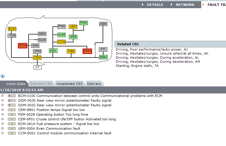

This morning's festivities attached...
Car has about a 5 PSI variation from the pump at idle until it warms up.
Turned fuel pump on from VIDA and on the 3rd or so attempt, she fired right up.

Without VIDA I was able to get to fuel pressure sensor, pump ekdctronics module, or fuel pump as cause
VIDA now tells me to check fuel pressure sensor, PEM, or fuel pump.

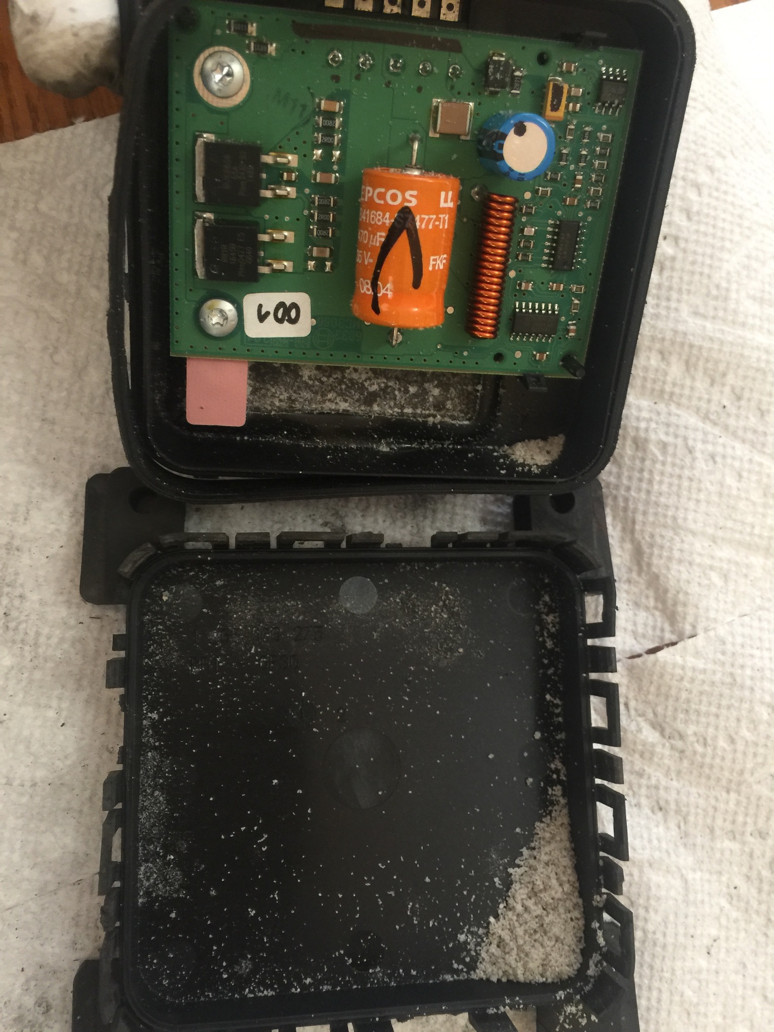

Nailed it
Checked voltage from A16 CEM to PEM and it was perfect at B+
Pulled and opened PEM and it was full of crud
Cleaned with electronics cleaner and car started
New one on order
Too much leakage current. Did you figure out where the crud was getting in and seal it?

All used PEM fit all cars from S60 XC90 S40 etc from early 2000 up to about 2012 for the S40. Late S40 have them inside the car under rear left seat unde the carpet corner away from humidity. On those located outside, corrosion builds on the cooling plate and
damages the circuit board inside. By the way these are pretty funny to split open as the cooling plate is attached to the circuit board with several welds, I think a heating gun is needed.
