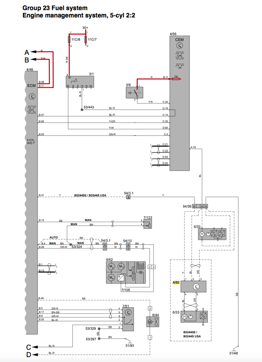

OK - I think Im going to spend a lot of time looking for a relay for my Gas B5244S engine...it doesn't have one.
The CEM (4/56) talks to the Fuel Pump control Module (4/83) which runs the pump controlled by feedback from the pressure sensor on the rail.
Ill need VIDA to move forward and figure out what isnt talking to what.
Reference Fuel Pump control Unit 30742823 $322 at FCP in stock
