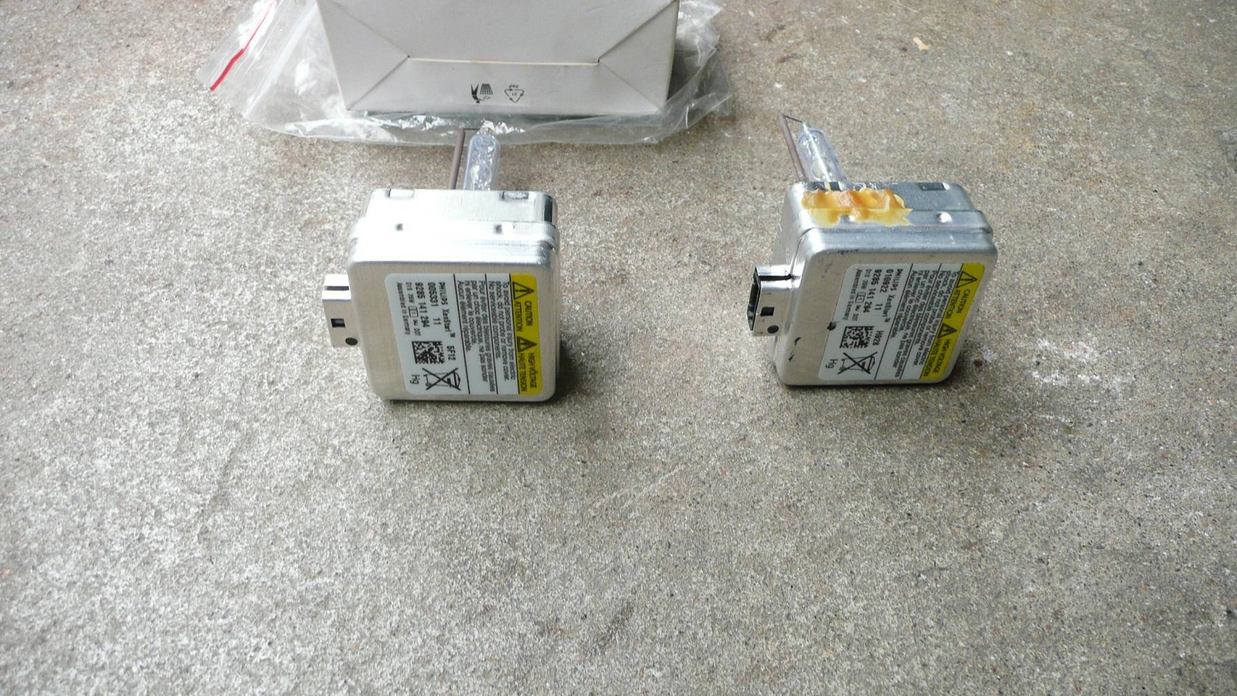

I took a random photo from the internet to show you what I have in the car now:

Turned out (I had to remove the HL assembly from the car to find out) I have D1S bulb, held by prongs and some yellow glue!!!
For the RH headlight, if you look from the passenger seat, then connector sits at 6:00 and glue is at 9:00 position.

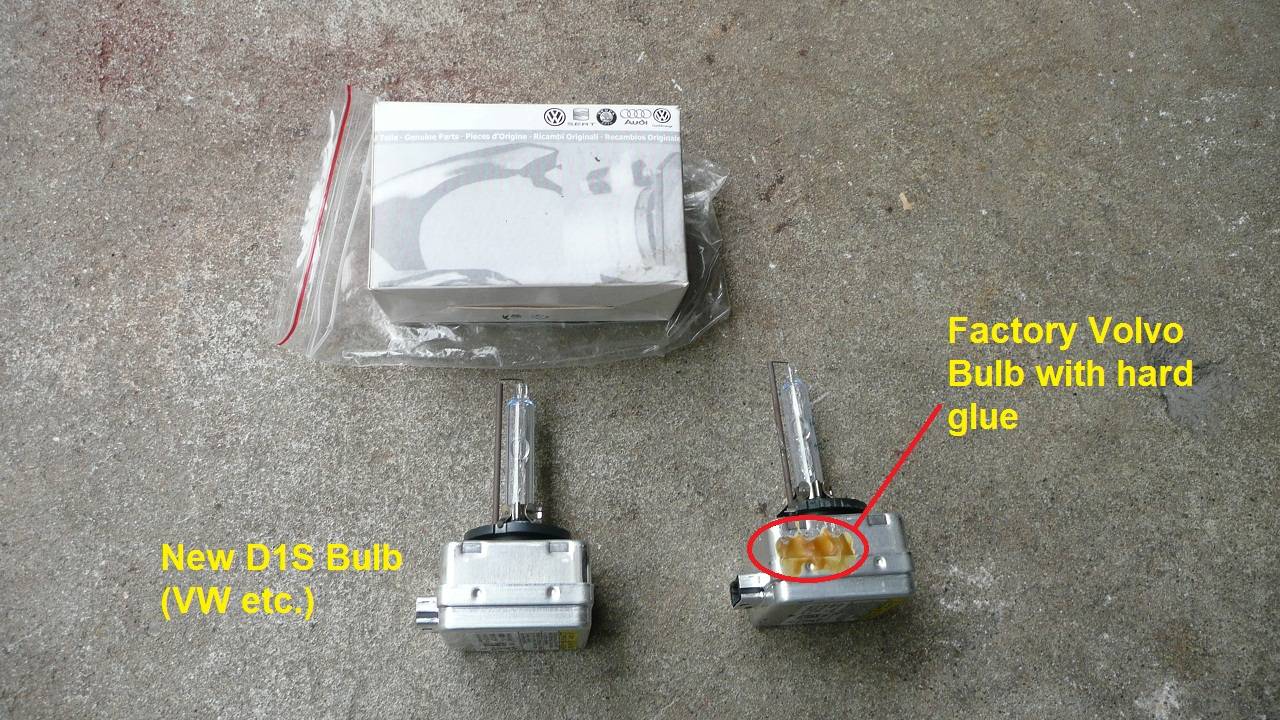

As mentioned above, the D1S Bulb prongs setup is bad engineering.
The bulb is held by a whole bunch of prongs and hard glue!!!

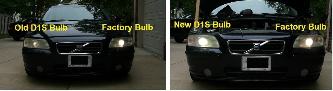

So @yanga001 was right. D1S bulb intensity goes down with time.
The R side was bad, the L side is about 80% of new.
I got lucky, bought a set of VW D1S bulbs (New Old Stock) on eBay for $20/each, so $40 for two (2) D1S bulbs.
It is identical to factory bulb.
This is usually $80-$100/each at FCPEuro etc.
I replaced just the R side for now just to show ppl the difference in intensity using photos.
Pay attention to the notch at 12:00 position on the bulb during installation.
You can see the R side is about 30% of new.
I left the L side factory bulb in place so you can see.
PS: I still prefer halogen to this D1s thingy but it is much better now...
