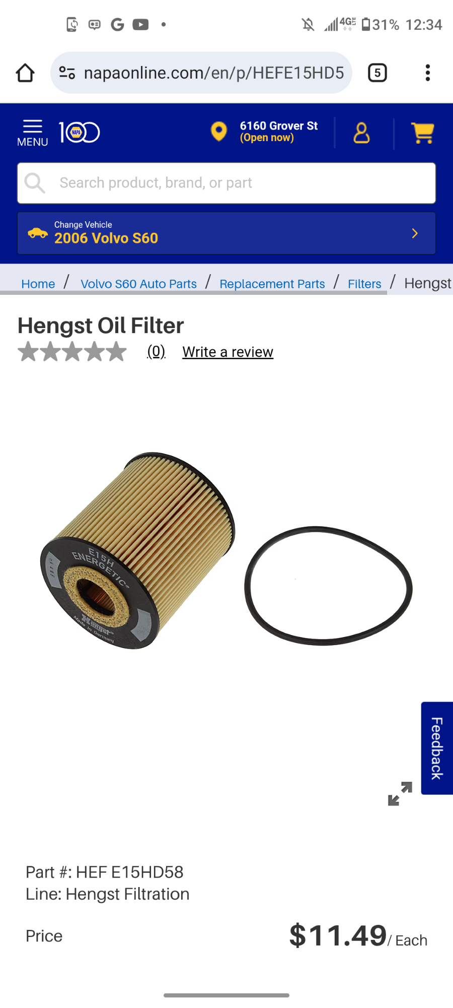

Question re Hengst oil filter, which I use all the time in my BMWs.
- In the Euro world (MB, BMW, Volvo, Porsche etc etc)...for air and oil filters, the main 3 mfgs are Mann, Mahle and Hengst.
- Per FCP Euro website:
* Mann HU819X (made in Germany ~ $6.60)
* Mahle OX149DECO (made in Austria ~ $9.50)...this is what I have been using for 10 years.
* Hengst E15HD58 (made in Germany ~ $10.20).
The local Napa carries Hengst oil filter for $11.50.
The issue is not saving a few bucks (FCP shipping cost if total $ not met, time waiting for part to come etc). The issue is: sometimes I have a free weekend and just want to get oil change done to get it out of the way. I happen to be out of Mahle
oil filters at the moment.
So, has anyone here used Hengst oil filter before? Any issues?
Here is the NAPA listing...

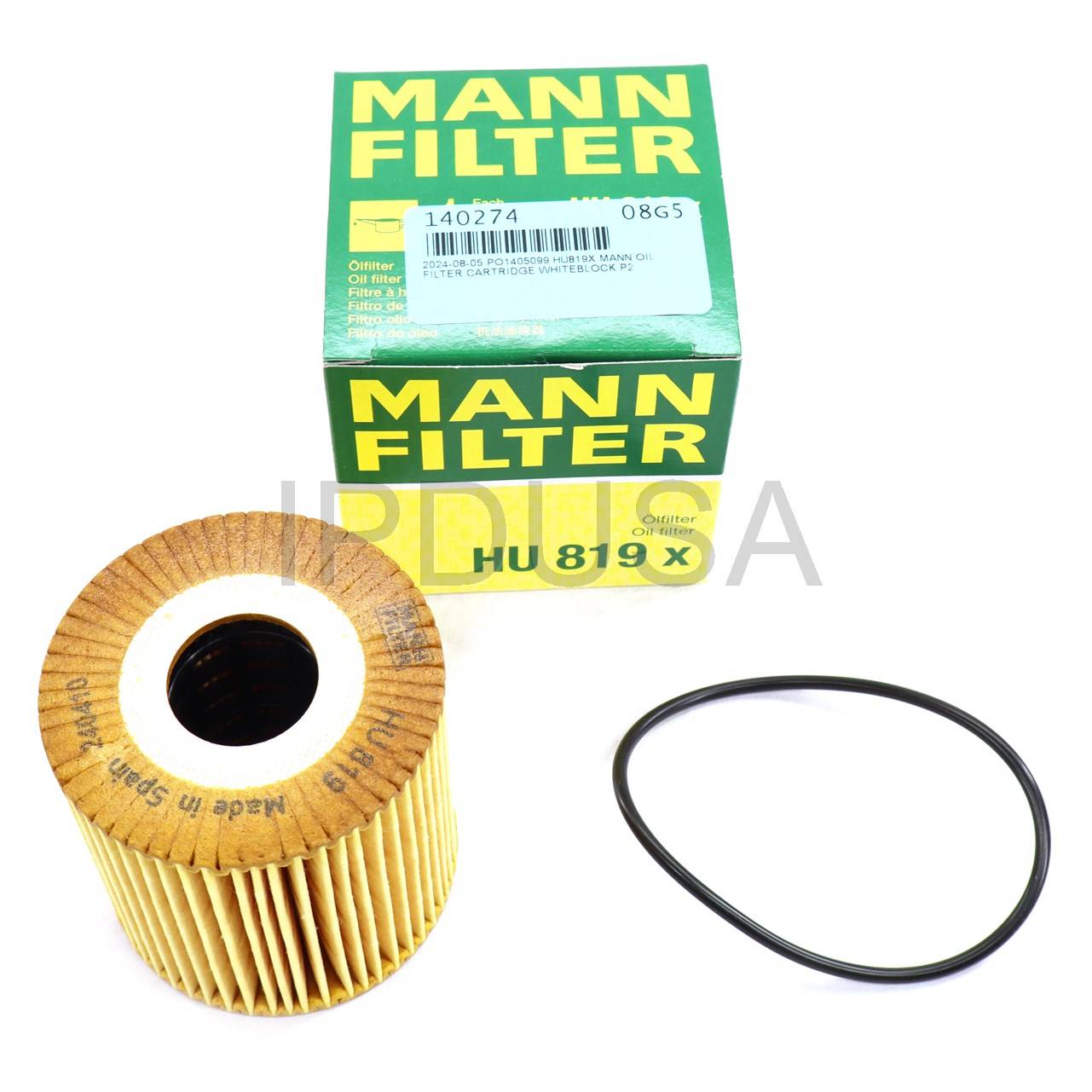

I have not used Mann oil filter in the P2 cars yet (I used Mann oil filters a lot in my 1998 V70 yrs ago). Anyway, a photo
of Mann oil filter for P2 cars (from IPD website) just for the sake of completeness...
