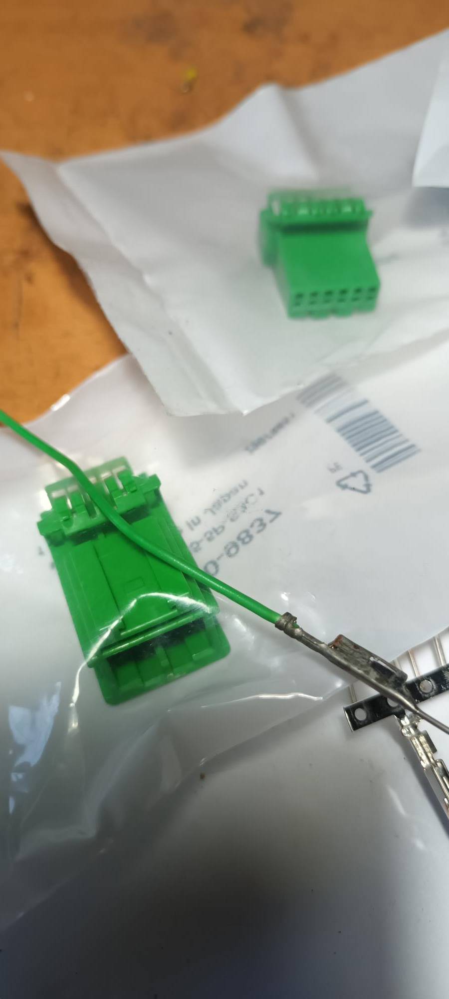

Ive sourced the green connectors Volvo use, they are JAE brand IL-AG5 series connectors. Does anyone know what crimp tool to use??
I recycle, re-use salvaged wires and plugs but sometimes have to make them. Note: de-pinning these can be a challenge, there are two small tabs that need to released at the same time. Also the male pin (shown) goes with the Female looking connector, its easy to get male female pins and connectors mixed up
Green JAE IL-AG5 connectors

Perhaps Allied Elecctronics Supply https://www.alliedelectronics.com/srch.html can supply appropriate crimp tool.

It is difficult to judge the size of the connectors, but I had good luck with the Engineer crimpers:
https://www.engineertools-jp.com/produc ... ing-pliers
You'll have to measure the width of the crimp connector to select the correct die width and then select the appropriate crimper for the task.
They are single stage, meaning you have to do two operations for the full crimp, but in many cases that is good because you don't have to get a specialized crimping die.

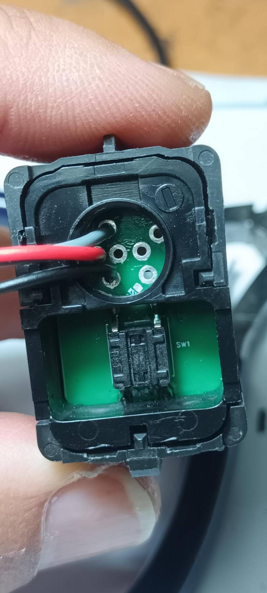

ive had some custom circuit boards made, they make the buttons in white plastic so the light comes through, then paint them grey/black
P2 ECC custom made buttons

I use this Matco crimper for almost everything automotive:
https://www.matcotools.com/catalog/prod ... mping-tool
I purchased this tool for home and for work after seeing it many years ago on a Chrysler mechanic's workbench. If you are very careful, it works for almost every electrical connector brand. There are many copies and other suppliers for the same tool. The key detail is to get the 5 different size crimps with the double curve on the seat side to roll the two crimps over and into the stripped wire bundle.

thanks i bought a crimping tool that i am 90% happy with. it does a neat job of crimping the wire and insulation at the same time but has a tendency to slightly bend the terminal.

For those JAE IL-AG5 connectors you'll want an open-barrel crimp tool, usually the Engineer PA-09 or PA-21 works fine. They're not "official" but they get the job done without destroying the tabs
