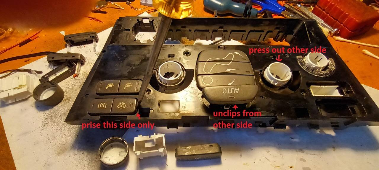

To change your ECC from F to C is easy, just unclip the face plate. To remove and clean sticky buttons properly (i used chemicals),first remove electronics PCB,it comes out with the temp sensor (needs a good pull). Then press the buttons with a large screwdriver from the back. Do not try and do this for the buttons, the white sliding tabs will break.I found prising with a screwdriver from the front got them out unscratched and unbroken (see pic 2)
update F to Celsius
update F to Celsius
broken ecc 1.jpg (81.86 KiB) Viewed 71 times
removing sticky buttons
