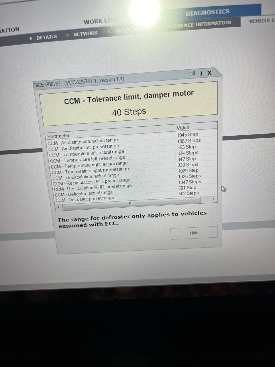

First step is to run CCM calibration. Need DiCE/VIDA to do so. The bad actuator will fail the max 40 steps inconsistency test. In this example it is the one with 4095 steps counted.

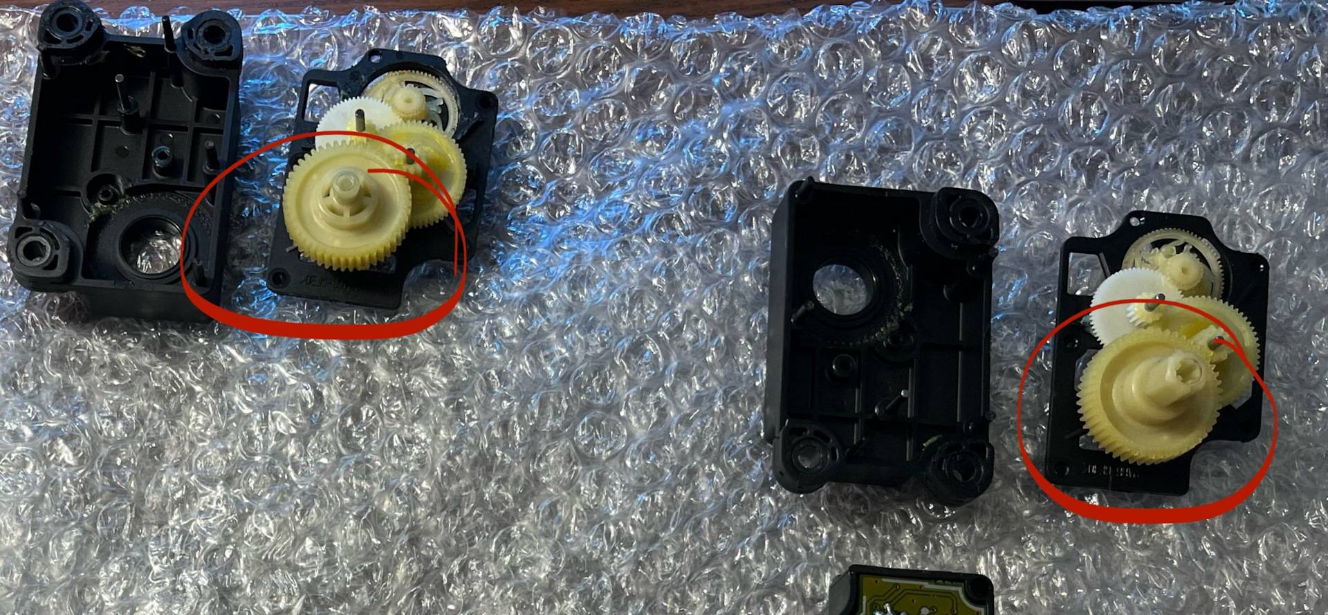

Actuators come with two types of output sprockets. Air distribution and recirculation have longer shaft, the rest have shorter. Your new actuator will come with short one. It is possible to open it and replace the sprocket, if needed.

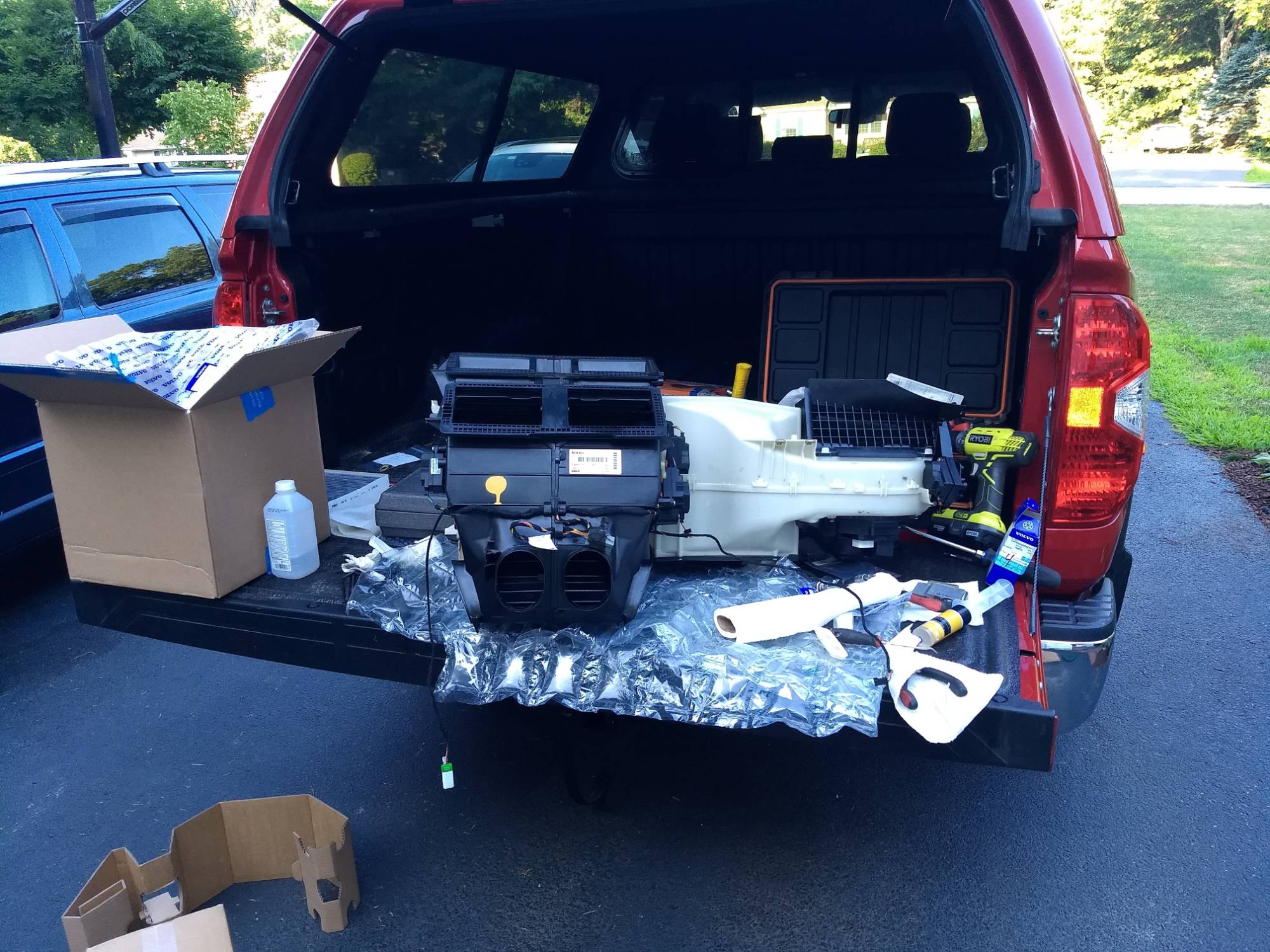

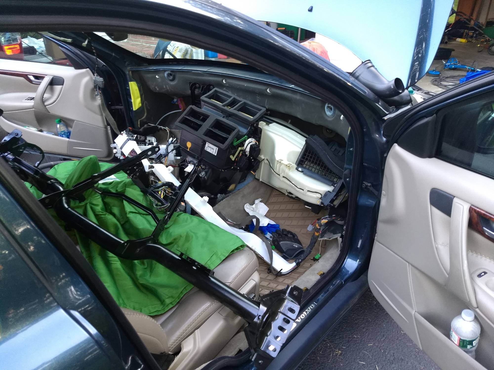

Don't need to remove the dashboard to replace any of them, the driver side one can be tricky. But still doable. Here a bunch of reference pictures with dashboard removed.
Apparently do it in a warm garage or you risking breaking the plastic. At least heat the cabin up real warm and blow some hot air at the actuator just before replacing it.
