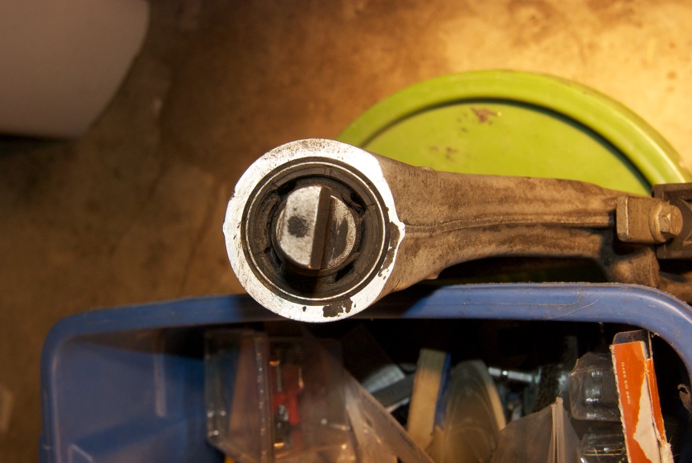

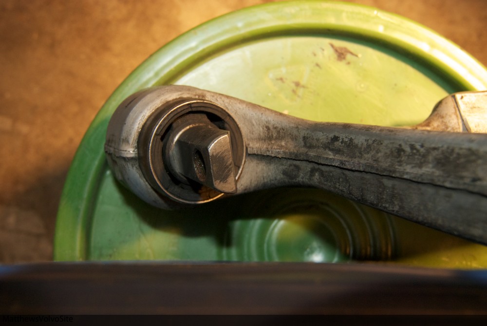

This is how it came off the car. Should the new one go in this way, or exactly square?
See how the bushing bolt plate is not 90 degrees perpendicular to the seam in the control arm cast?

Exactly the way it came out. Make it look exactly the same.
Anything different will effect ride quality as the pretension and designed amount of travel is calculated into its position.
