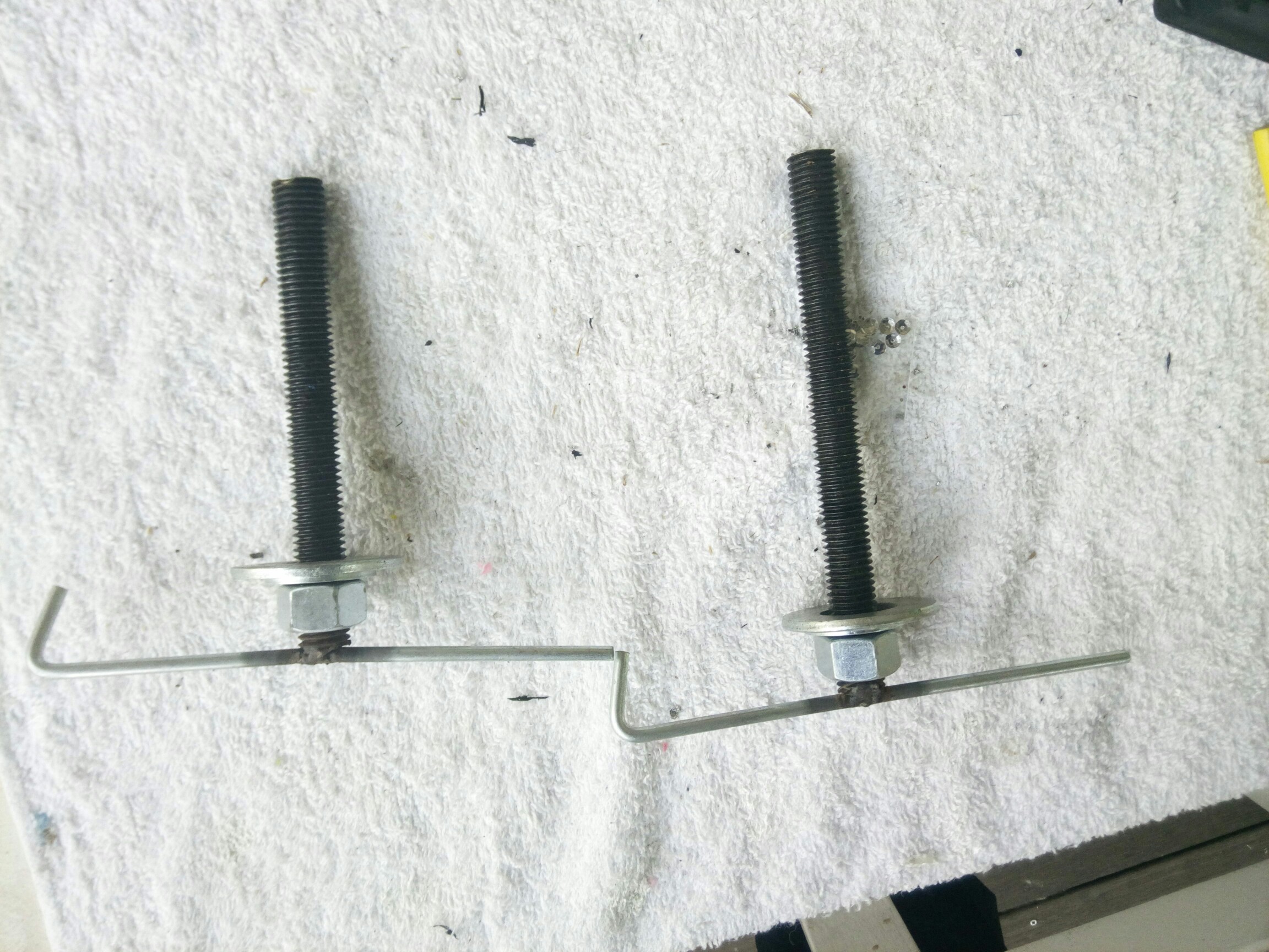

FCP Euro sell polyurethane subframe bushing spacers made by Pro Parts. I'm usually not a fan of Pro Parts stuff however because they are made from polyurethane they are great value and take up the space in the vacant areas of the factory subframe bushings and compensate for their inherent sponginess. One caveat to fitting them is that you have lots of polyurethane grease on hand as the piddly bag that Pro Parts provide in the kit is hardly enough for one bushing let alone four of them !
I just fitted a set to my low mileage (though some would argue that 144K miles is low!! ) 2001 V70 T5 and I can feel a sharper steering response and less of that low speed wallow. These are probably the cheapest handling upgrade you'll do to your Volvo.
If you do this and are pleased with the result you won't need to worry about the arduous task of pressing out the old subframe bushings or replacing the entire subframe.
You can fabricate some subframe dropping rods as I did from high tensile threaded rod so you can safely drop the entire assembly (with the aid of stands of course!) and get to those bolts for the steering rack and for the sway bar bolts. Of course you're still going to need to support the engine from above.
