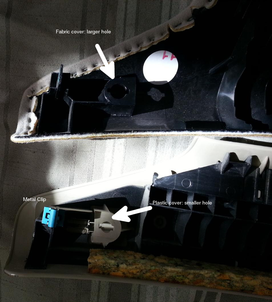

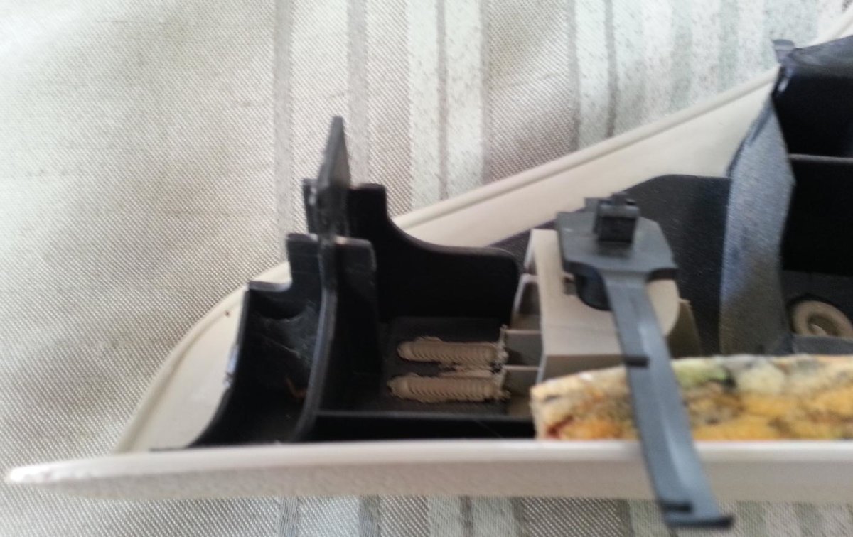

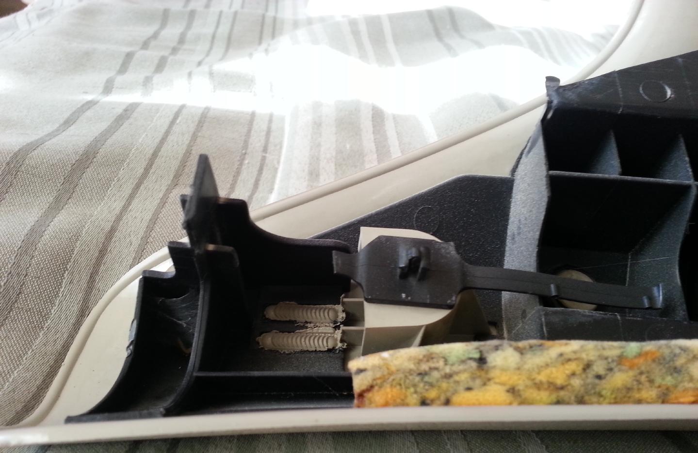

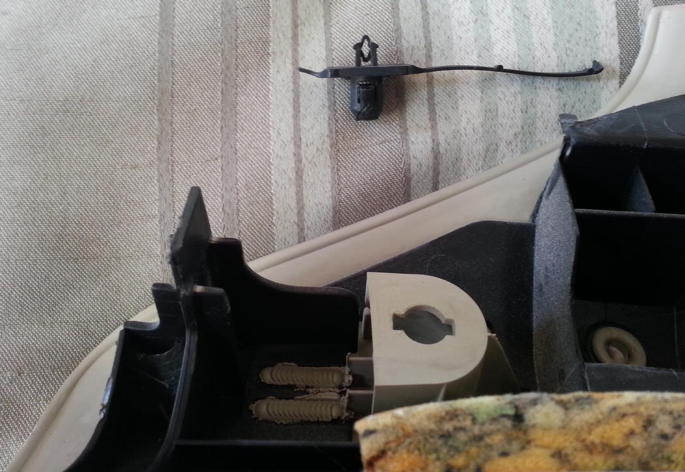

The next consideration is the type of plastic clip that holds the covers to the A-pillar near the top. There seem to be at least three variations, but I have not seen the first type. The second and third types are shown in the photos below.
The first type of upper plastic clip has a drawing in VIDA that looks like two ends connected by a single flexible strap.
The second and third types have two ends connected by two folded plastic straps. The longer folded strap is to be oriented downward when installed. The only difference between these two types is that the mating hole in the cover is a different size. The plastic covers appear to have a small hole and use part 8684846. My 06 original fabric cover had a larger hole so I had to order new clips.
Volvo indicates that one should cut the straps for these upper plastic clips and then install new clips. However, I found that by rotating the clips 90 degrees, the fastening ears aligned with cutouts in the mounting holes and the clips could be gently removed without damage. Had I understood this before I went to the salvage yard, I would have removed the clips along with the covers and used those.

Is the diameter of plastic clips going into the a-pillar the same for both? Looks smaller on the picture?

Same diameter on the metal a-pillar side. Just different on the cover side depending on whether you have the fabric cover or plastic cover.Rvolvos wrote: 26 Oct 2018, 12:09 Is the diameter of plastic clips going into the a-pillar the same for both? Looks smaller on the picture?
